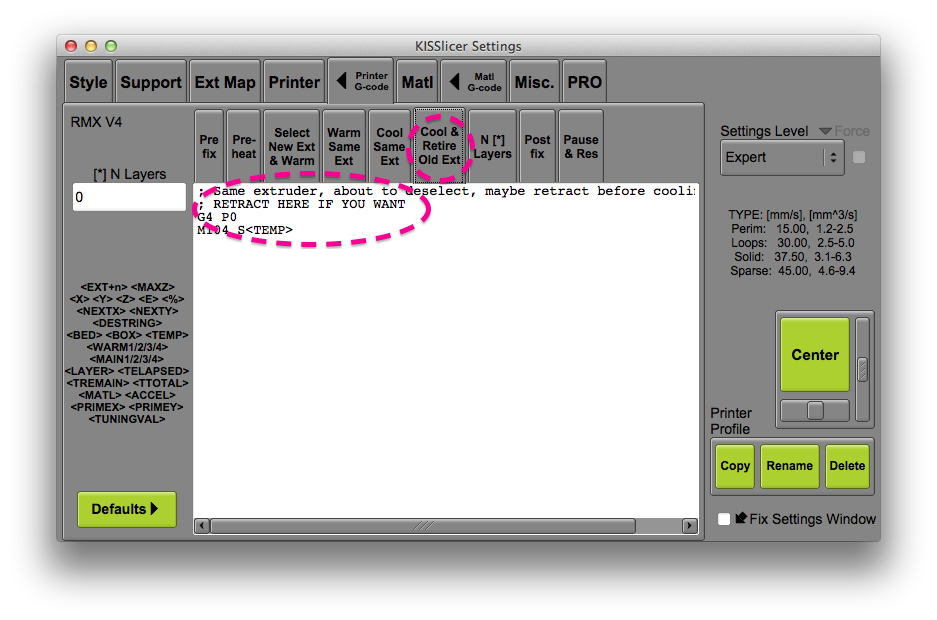

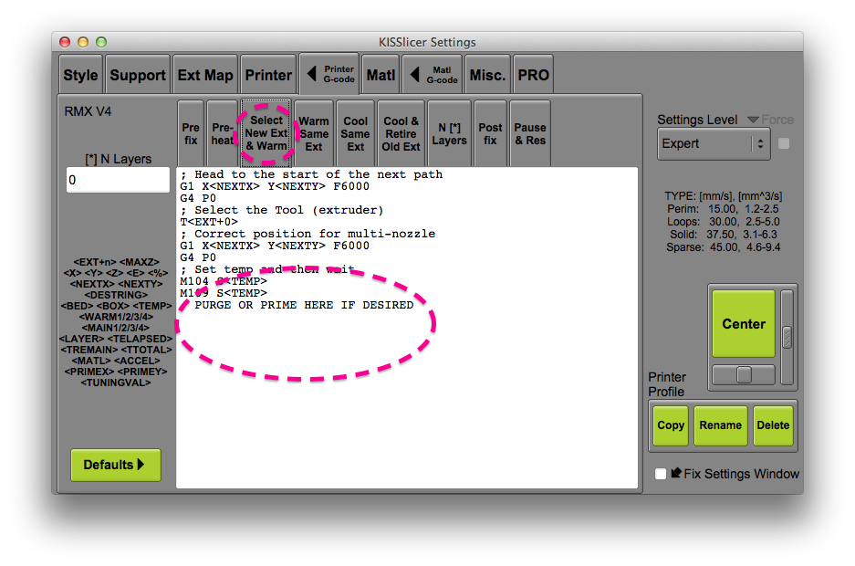

Guessing magic has to happen here:
and here:
CAN SOMEONE PLEASE POINT ME IN THE RIGHT DIRECTION/S?

Re: Dual Extruder set-up: SMCNC V4 ROSTOCK / Duet2
There's really 4 sections of the Printer G-code that you need to use which relate to the filament handling during the loading and unloading:
Prefix
Select New Extruder & Warm
Cool & Retire Old Extruder
Postfix
Obviously Prefix and Postfix sections are used only once at the start and end of the print.
If you download my Prusa Mk2 + MMU settings from the main site (in the FTP folder "KISS V2 MMU Profiles"), I think that should be a good starting place for you.
Note that I keep the extruder moving over the purge tower during unload/load to prevent blobs.
