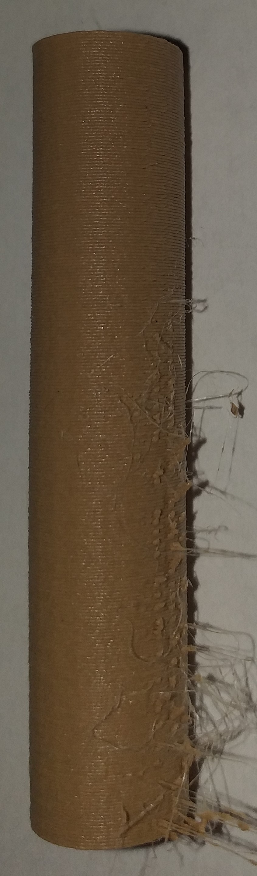

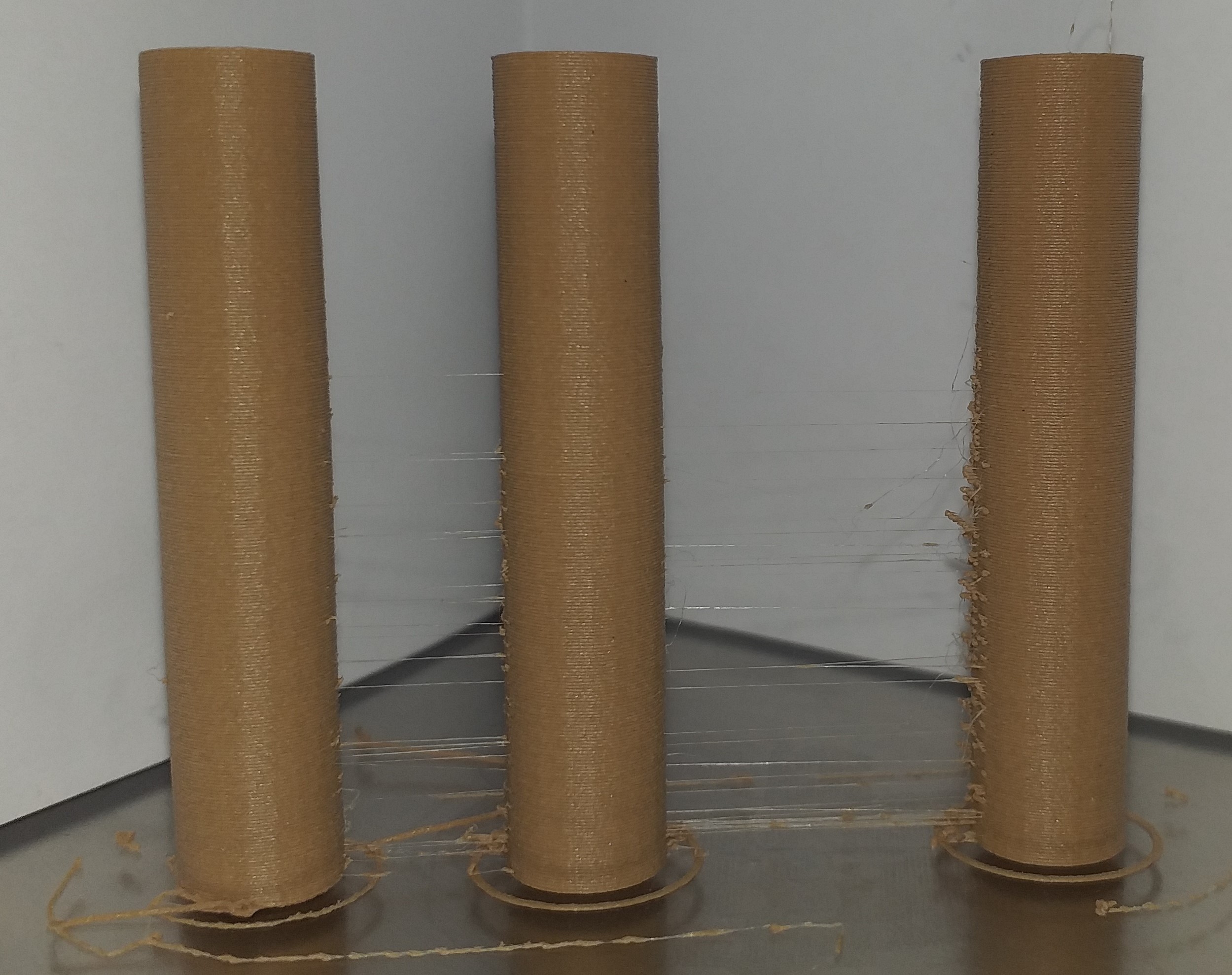

Destring: Currently my Destring is set to 4mm. I am aware that for my hotend [E3D V6 DirectDrive] this is more than recommended. According to what I have read on other sites it is not advised to go beyond 3mm. However after several Destring Length tuning prints I concluded that this was the minimum length for the least amount of stringing. The following is a picture of my last Destring Length test. This test starts at 2mm and goes to 5mm at the top. I also did several of these prints with wipe lengths ranging from 1mm to 3mm to see if this would improve and reduce the destring length required but wiping did not seem to make any difference.
Destring Length Test 2mm to 5mm
Destring Speed [velDstr]: I do not fully understand how to tune Destring speed. I did some experimentation with speeds from 25mm/s to 60mm/s but saw no noticeable change in the amount of stringing. If someone has an explanation for how this should be tuned, I'd love to hear it.

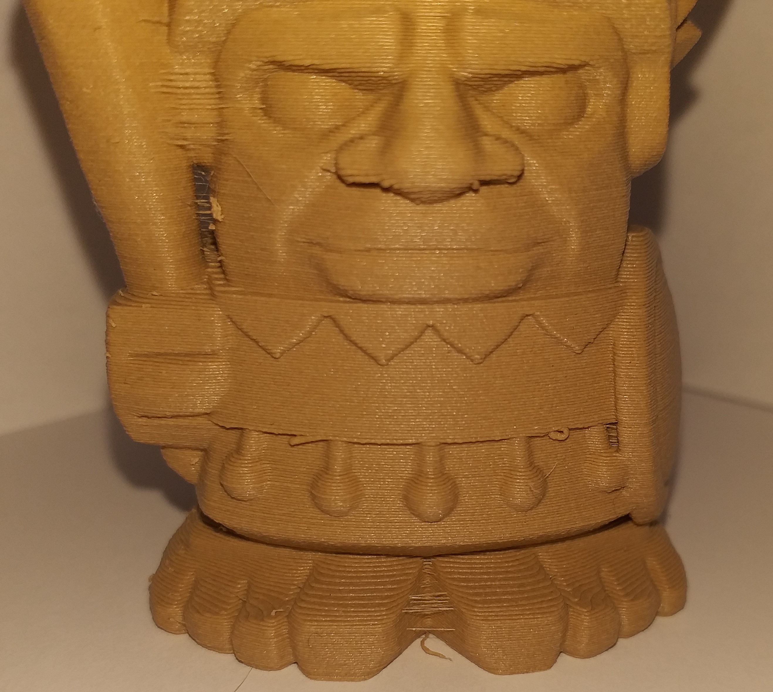

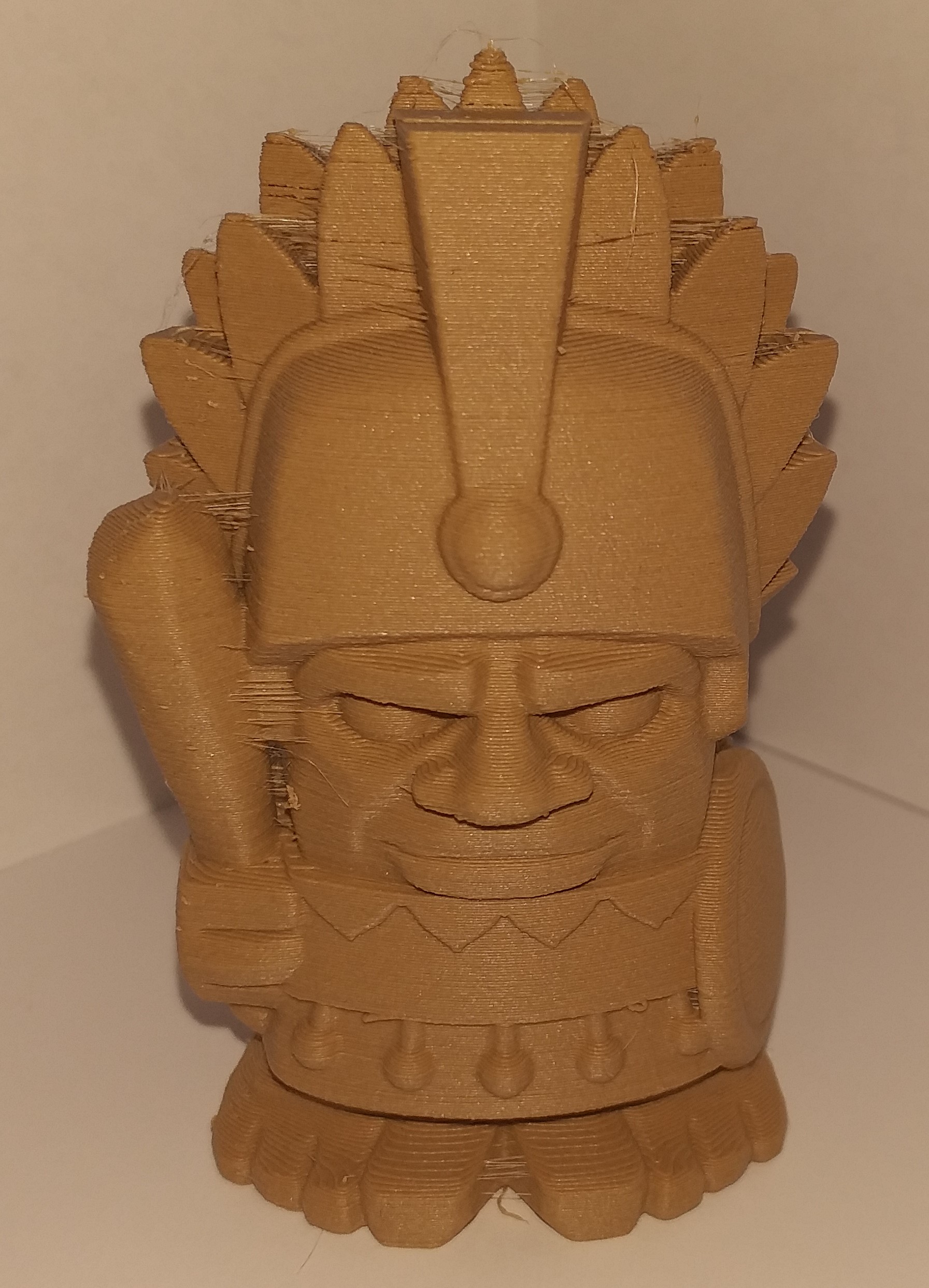

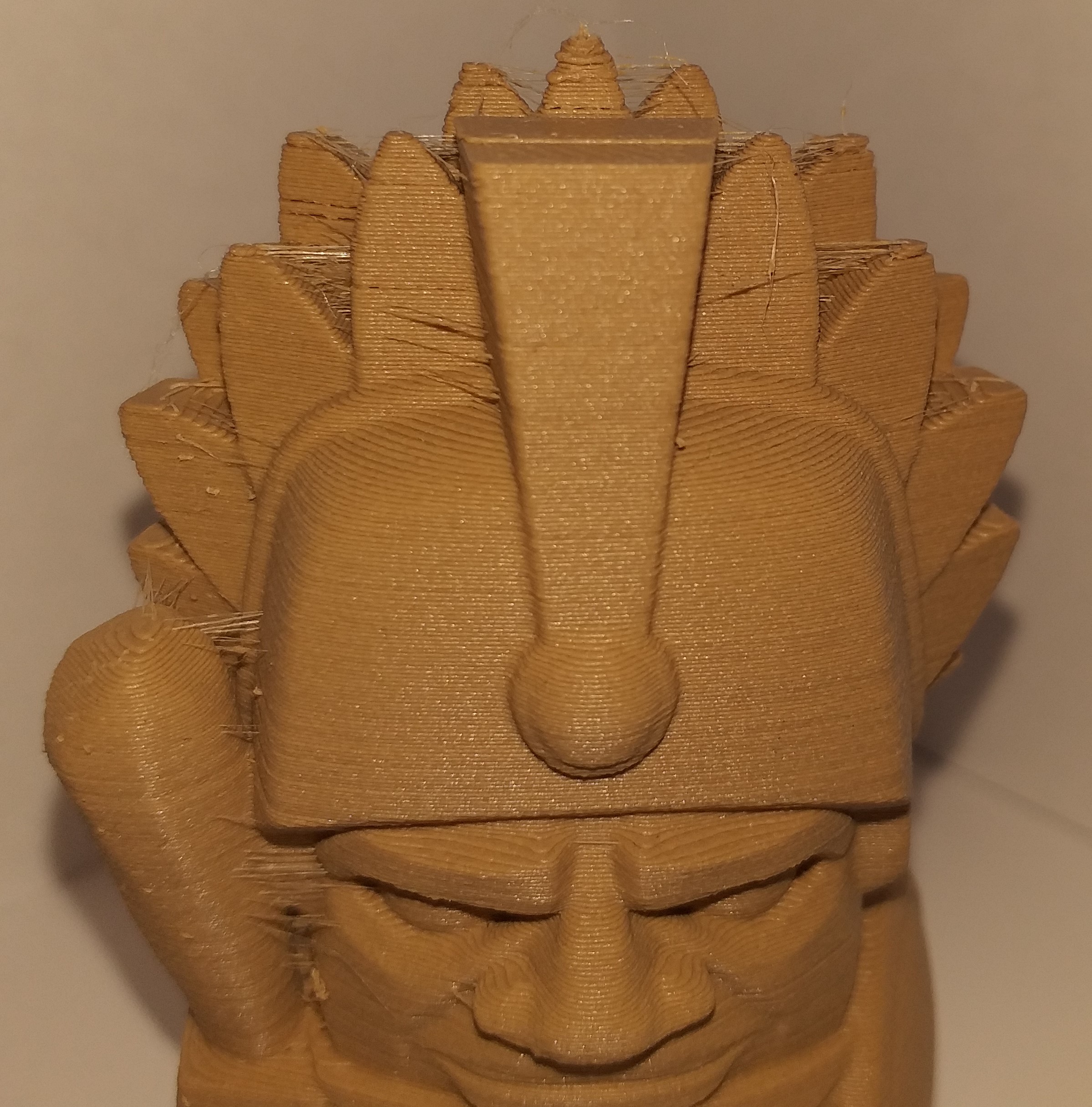

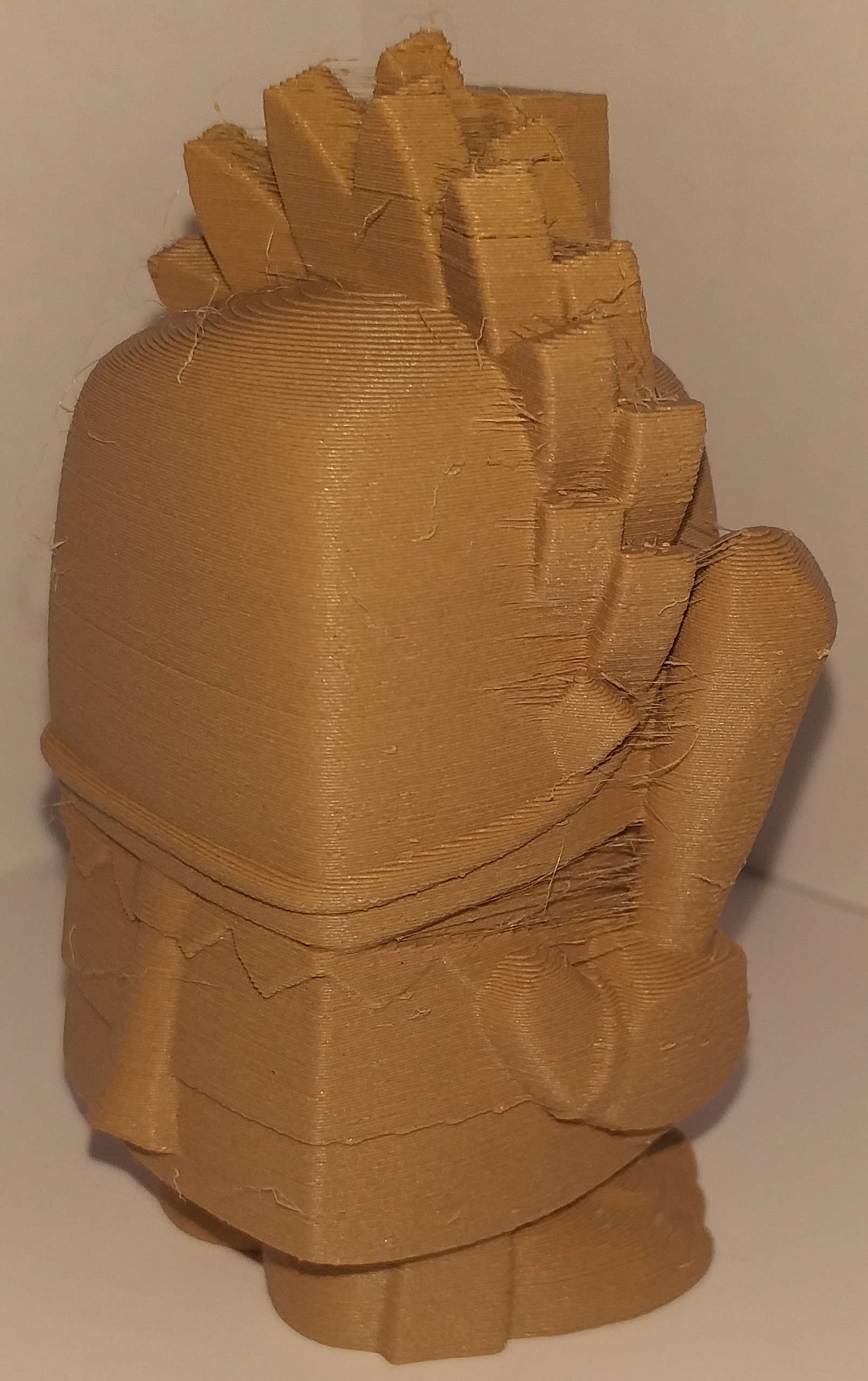

Here's a test print I did after a few hours of testing, calibrating, and verification. This print looks good. I see some small defects. However being a perfectionist, I want to tune out the wisps and get the print to be as clean as regular PLA.
Aztec Chief 1
Aztec Chief 1
Aztec Chief 2
Aztec Chief 2
Aztec Chief 3
Aztec Chief 3
Aztec Chief 4
Aztec Chief 4
Any feedback or tips are greatly appreciated.

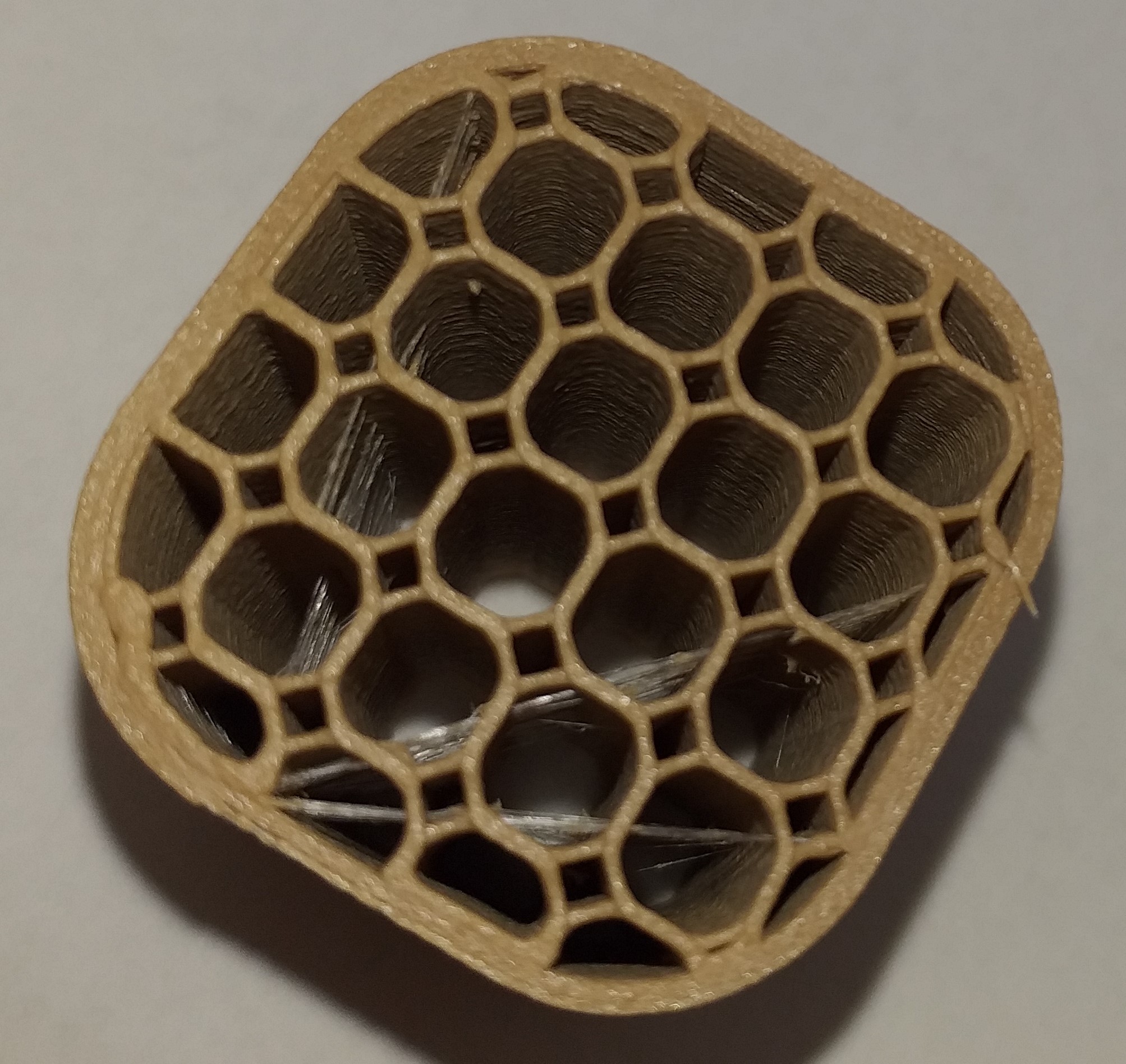

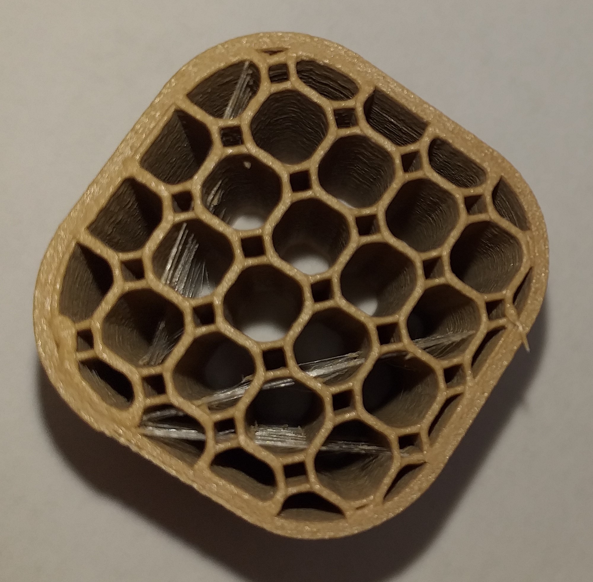

During my calibration of the filament I did the preload. I repeated the preload with Wipe turned off and Z-Lift turned off. I do like how the layers turned out but as you can see in the images below, At no point from 0x to 2x does the stringing become less. That is why in my previous post I had the preload set to zero.
The following are the preload test results. Bottom is 0x and top is 2x.
I will repeat the Destring Test now with 0 wipe and 0 Z-Lift. I'll post those test results shortly.

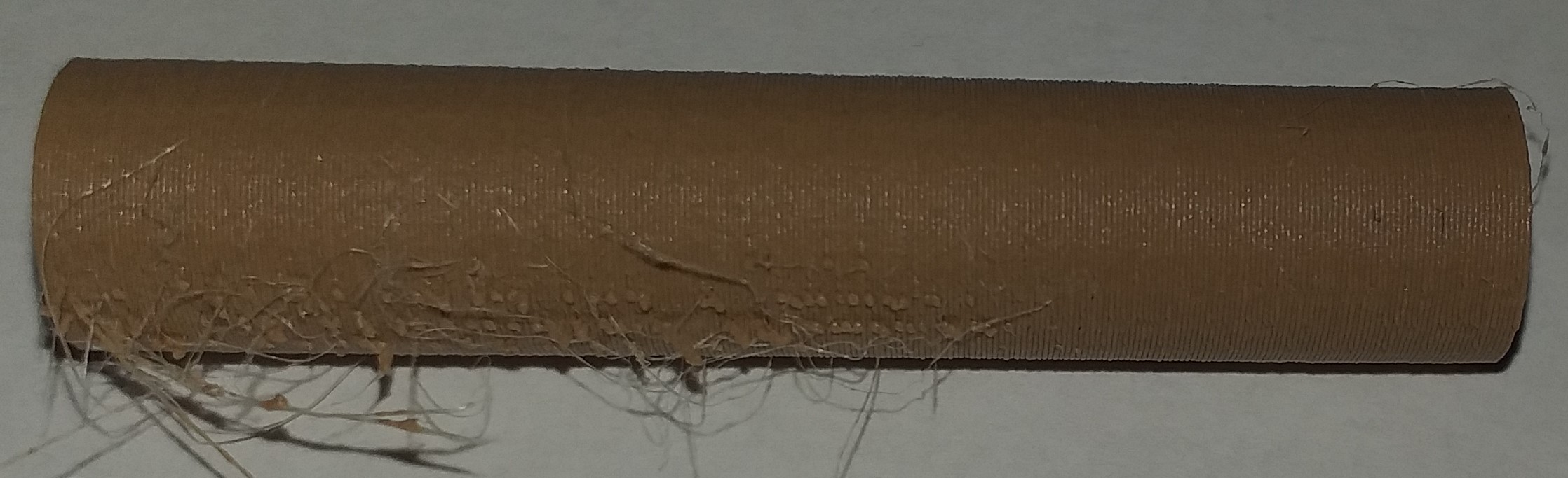

Hello All,

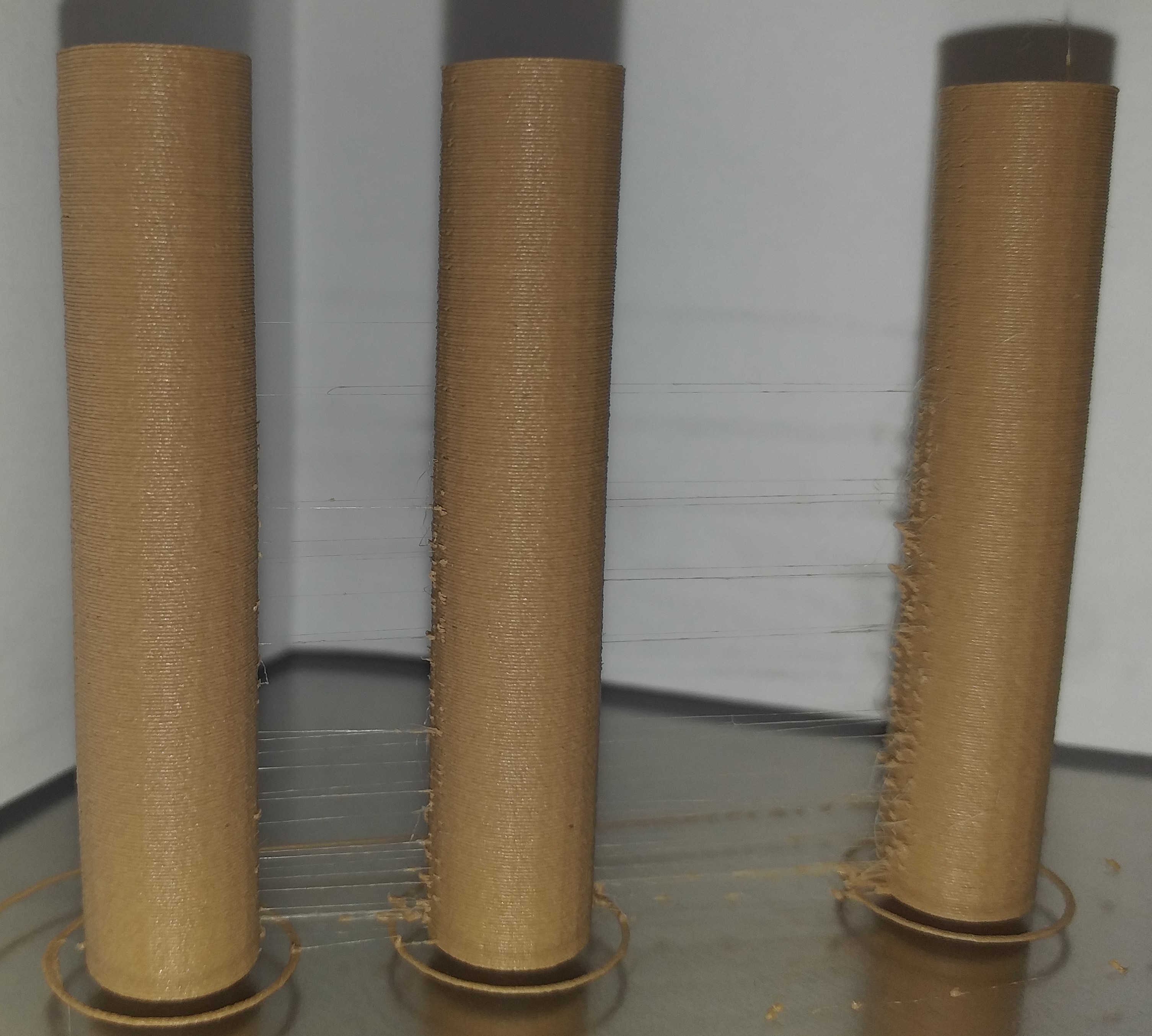

Based on the tips from Peter I reran some test. The following Tuning Wizard Destring tests were done with 0mm Z-Lift and 0mm Wipe.
The following test was done at 60mm/s retraction speed. After 35mm [or when the retraction is 4mm] the stringing stops. I also checked the third/last pillar in the row for defects to confirm this.
60mms Retraction Speed
60mms Retraction Speed - Last Pillar

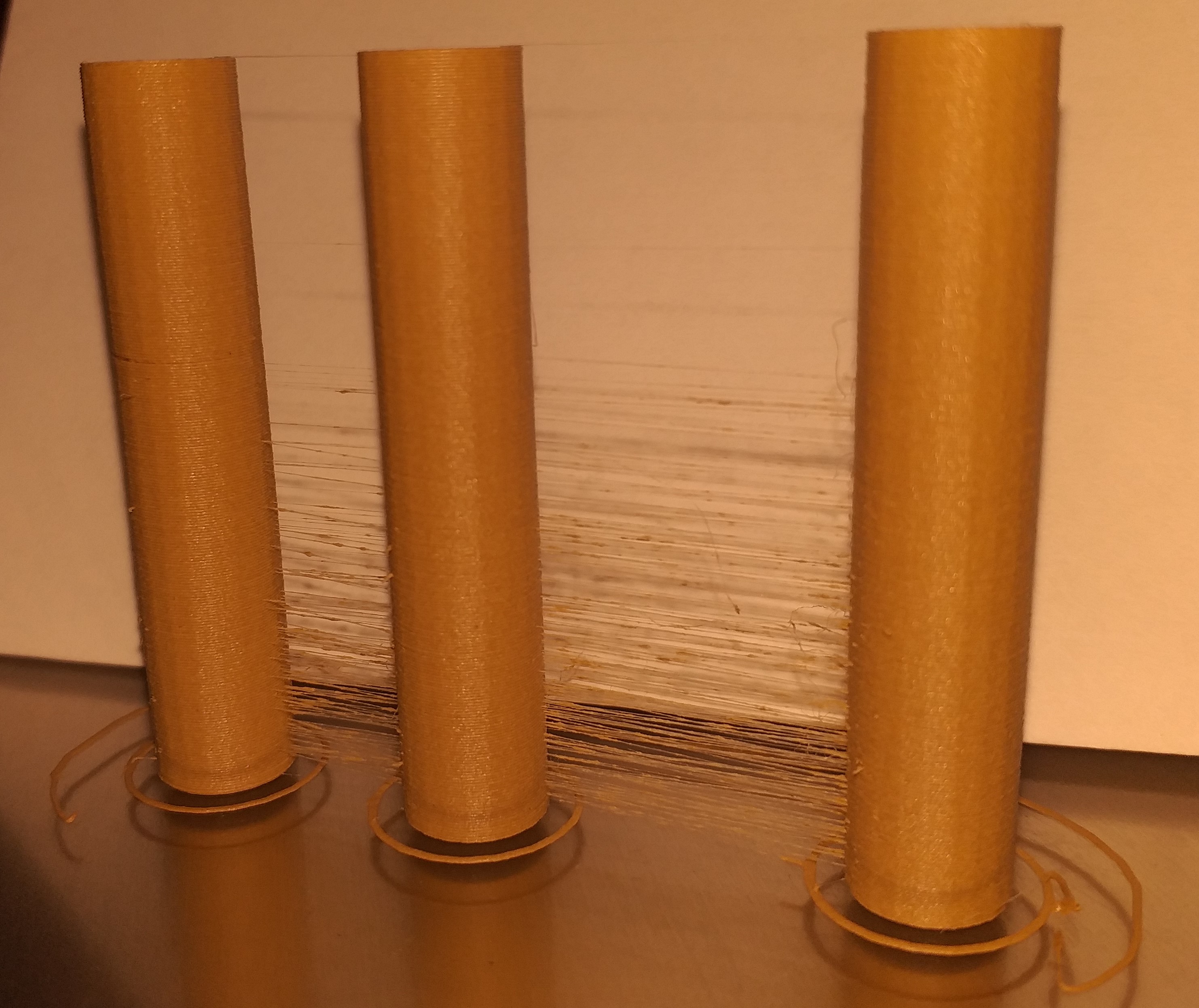

Becuase Peter mentioned that slower retraction might be best for filaments like wood PLA. I repeated the test with retraction speed set to 20mm/s. After 35mm [or when the retraction is 4mm] the stringing stops just like the previous test. I also checked the third/last pillar in the row for defects to confirm this.
20mms Retraction Speed
20mms Retraction Speed - Last Pillar
Based on these test results. I concluded that the retraction length should be 4mm and the speed doesn't seem to matter. I repeated the test but set the retraction to start at 4mm and stop at 5mm. The test results were clean. No stringing at all.

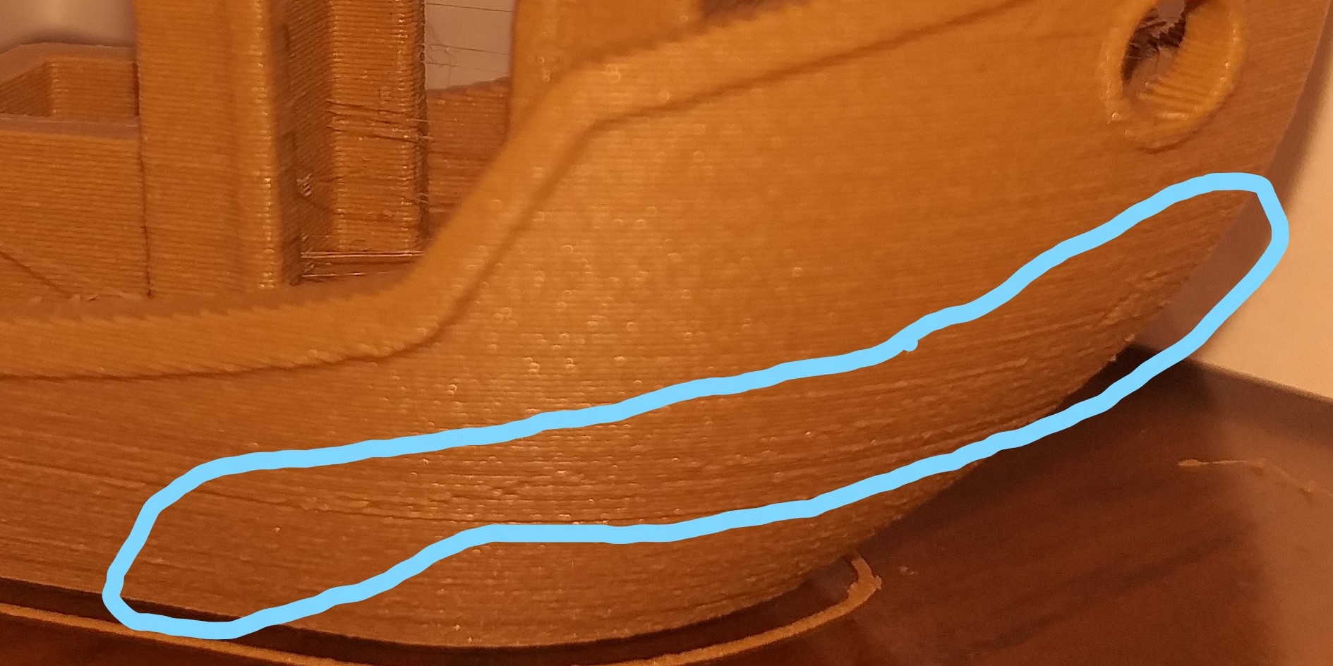

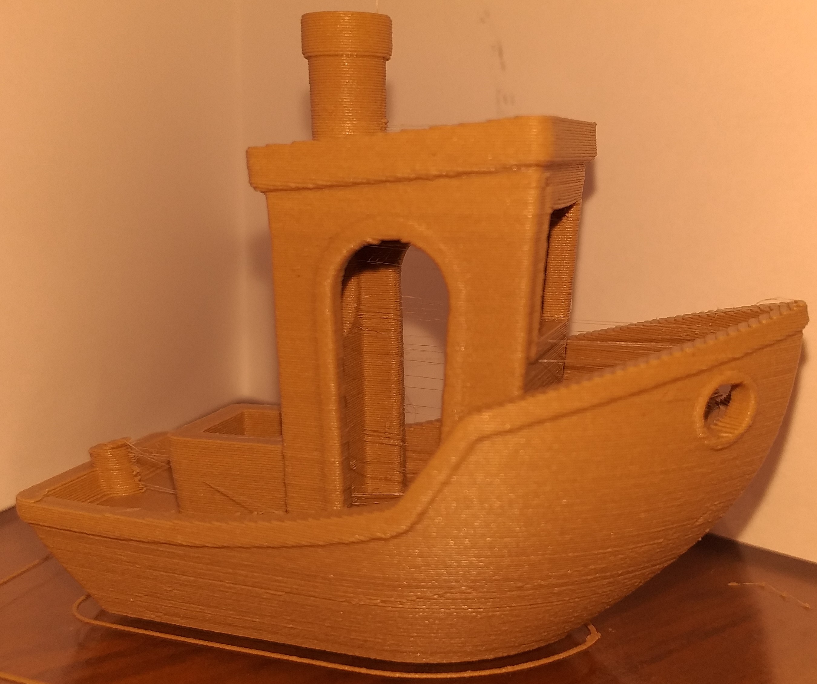

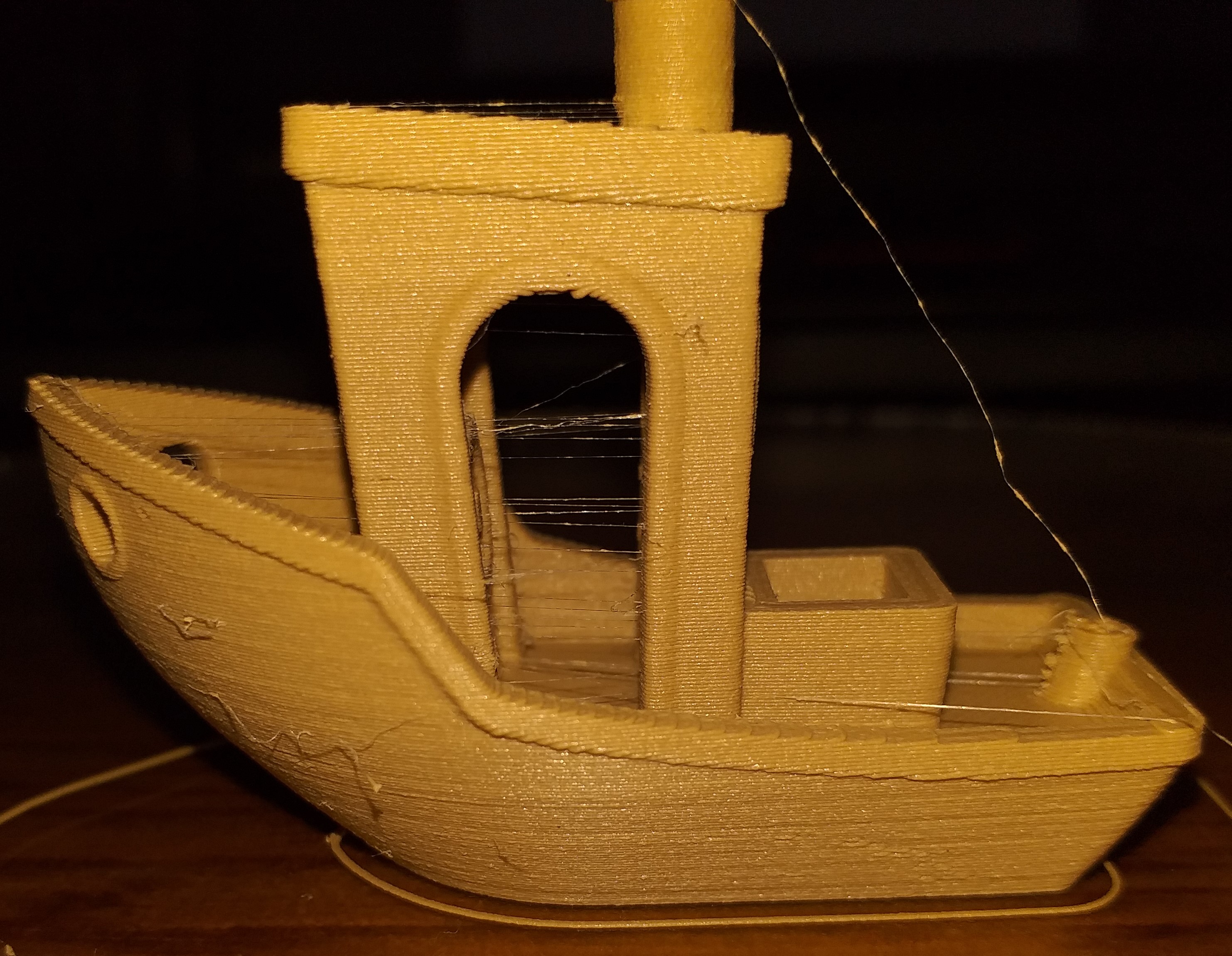

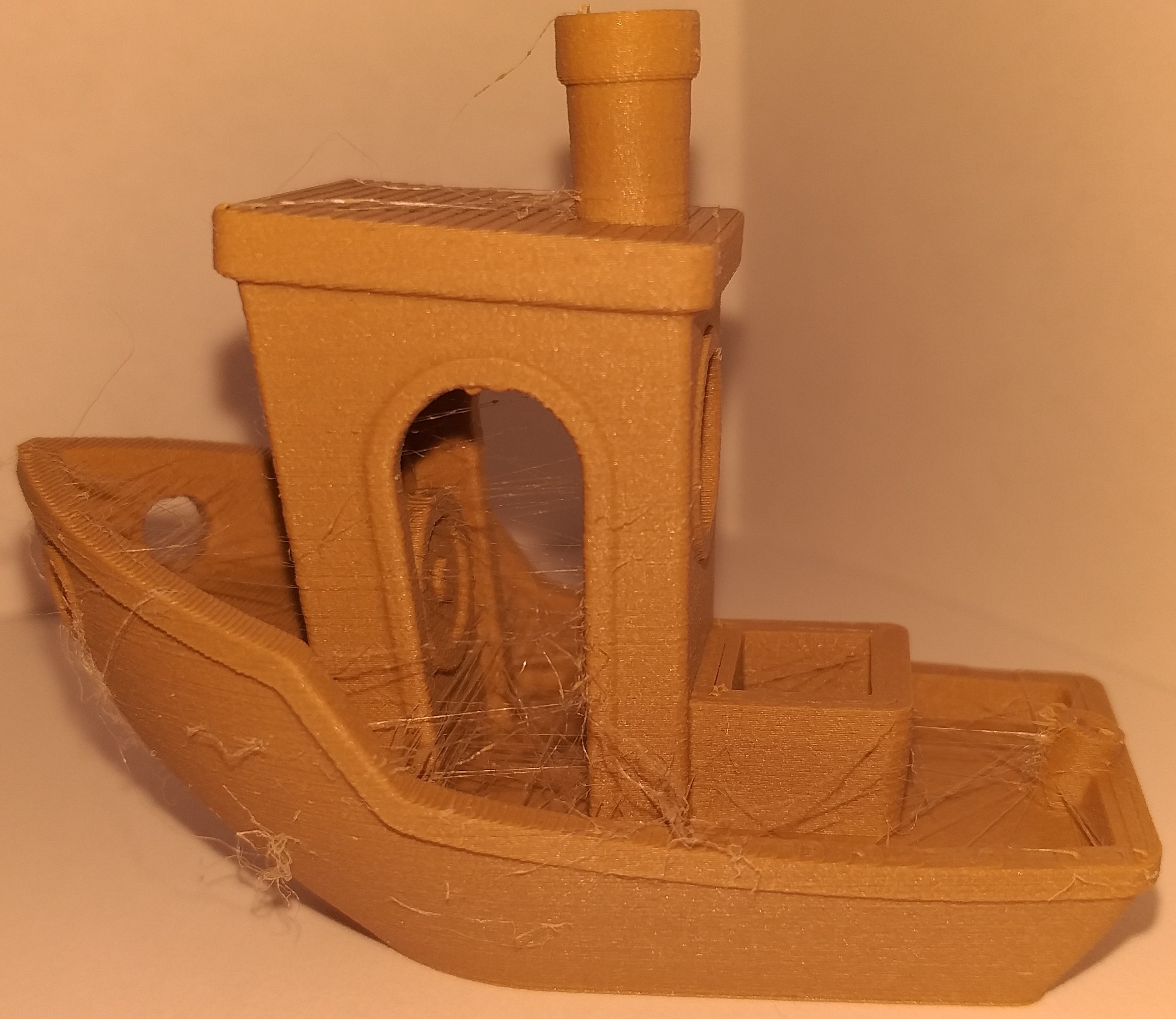

Now with the settings for Hatchbox Wood PLA dialed in as tight as I can get. I did a few test prints. The first print was done with Z-lift set to 0mms. This was very interesting to watch but also nerve wracking. I was constantly worried the hot end might bump into the print and it would fail. I sat next to the printer for the whole print. The Benchy turned out amazing. Ignoring the very fine wisps the quality is great. The Surface finish is amazing!
Print 1 - 0.2mm Benchy
0.2mm Benchy 1
0.2mm Benchy 1
0.2mm Benchy 2
0.2mm Benchy 2

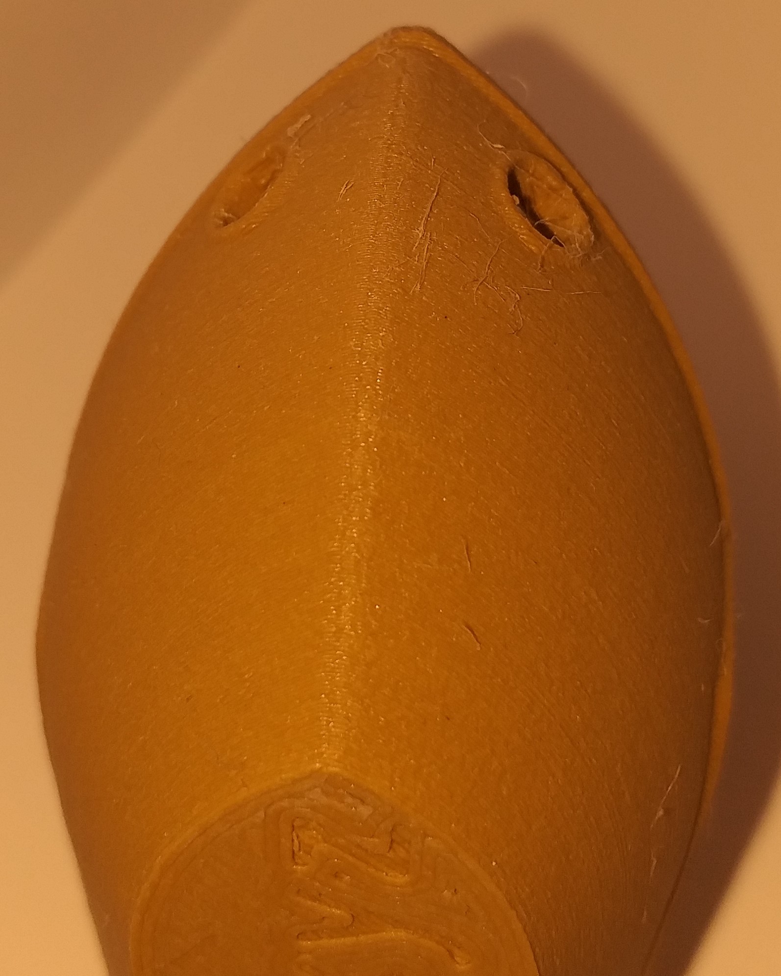

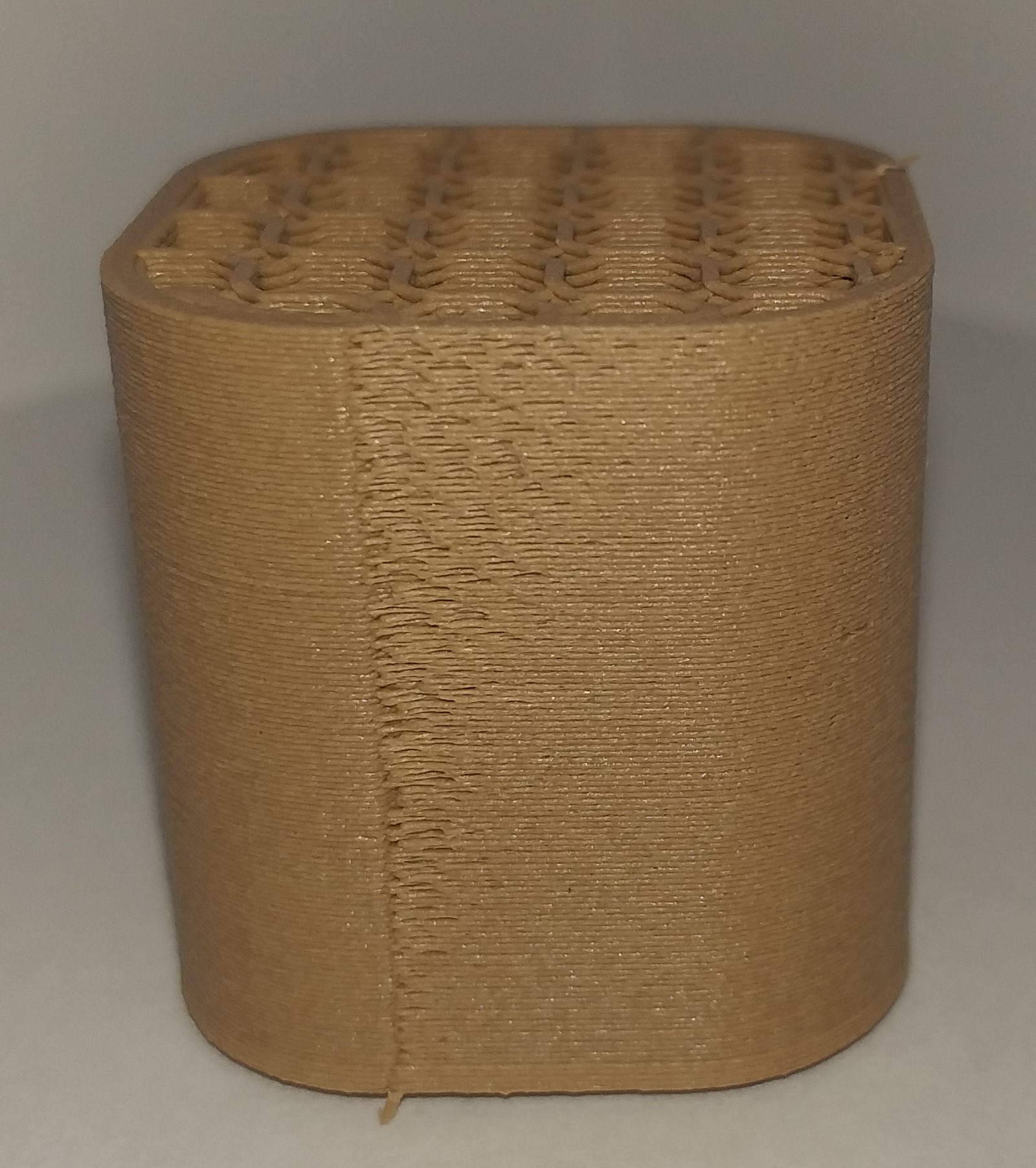

Benchy 0.2mm Scar
Benchy 0.2mm Scar
Circled in blue, You can see the seam scar.
In KISSlicer I did set the seam to be at the front of the model and jitter set to 0. However the seam was across the side like a scar. This might have been a bug in the slicer as the 0.1mm Benchy doesn't have this issue.

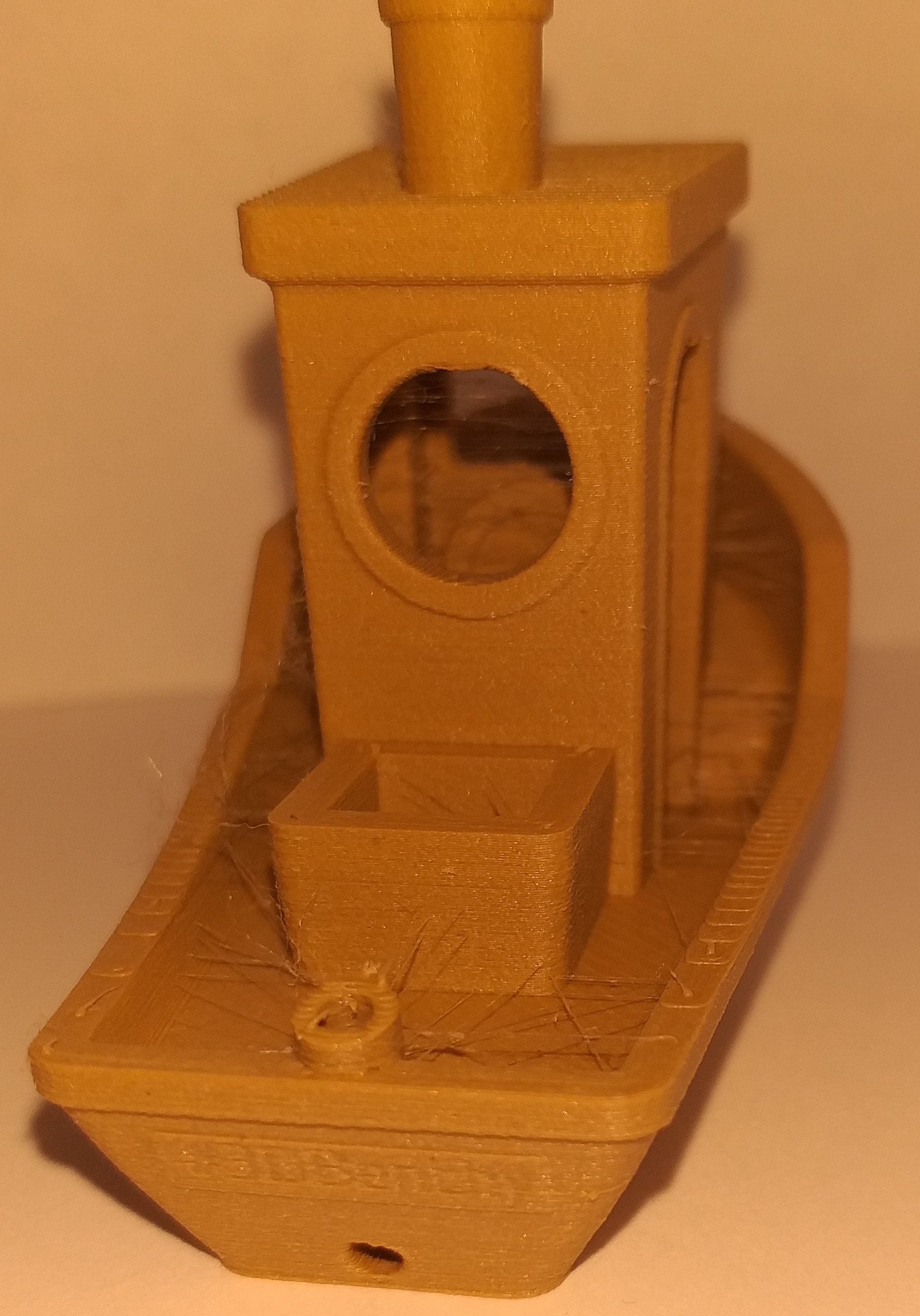

With the successful print of the 0.2mm Layer Height Benchy, I wanted to push the quality further and decided to reprint at 0.1mm Layer Height. For this print I set the Z-Lift 0.2mm. I did this becuase I feared the hotend crashing into the print.
Print 2 - 0.1mm Benchy
0.1mm Benchy 1
0.1mm Benchy 1
0.1mm Benchy 2
0.1mm Benchy 2
0.1mm Benchy - Seam
0.1mm Benchy - Seam
I am very satisfied with these settings and I do not thing I can completely remove the remaining thin wisps of filament but I can live with that. :lol:
