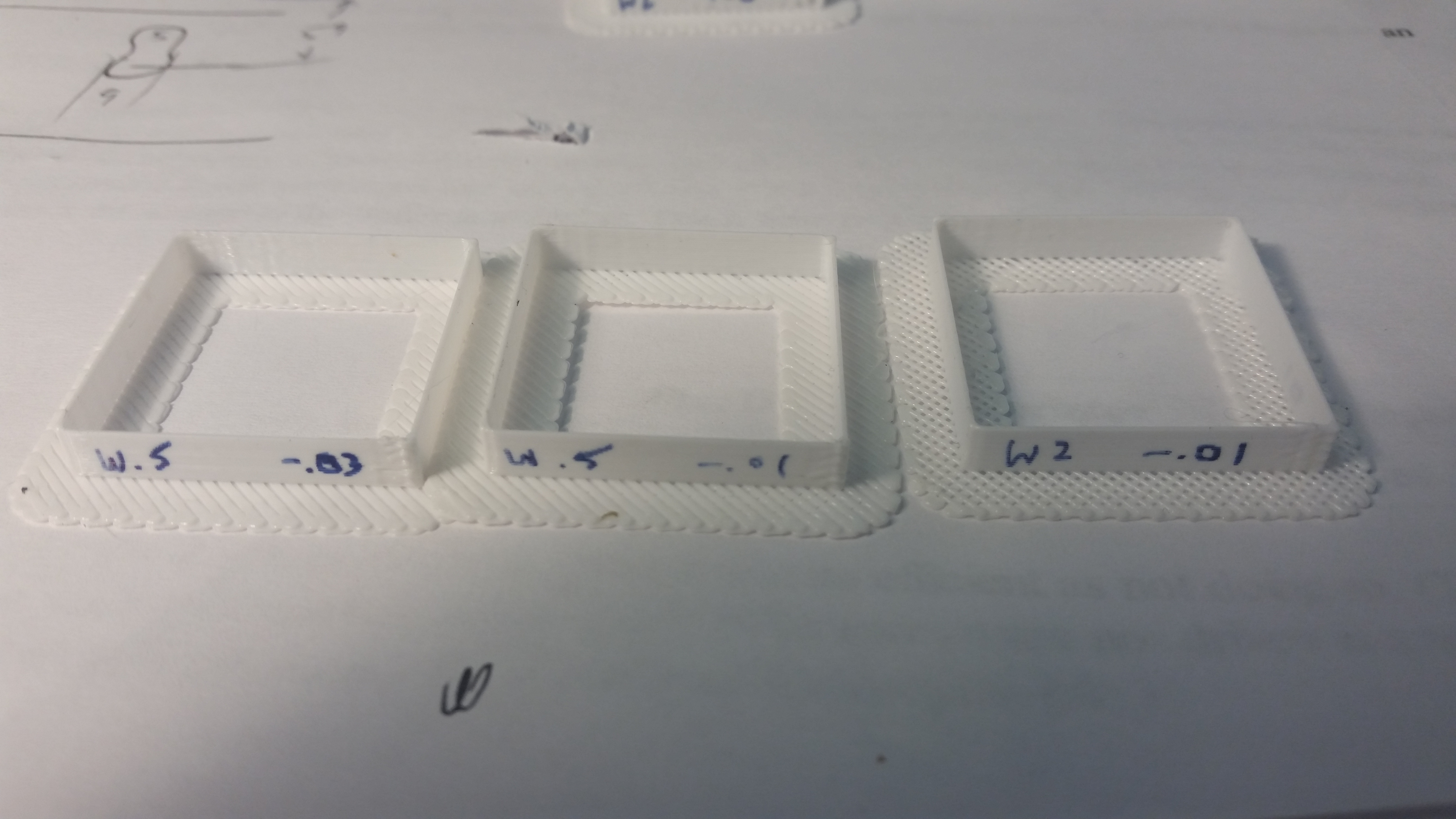

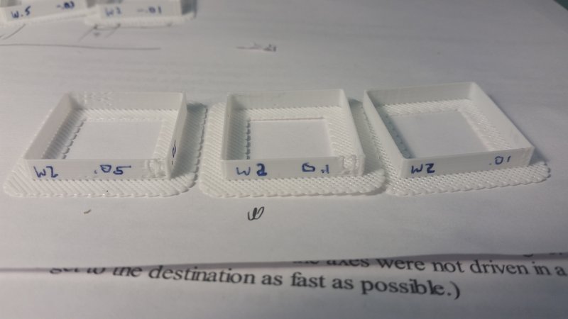

In the Material settings under Destring, there are M227P and M227S. I was under the impression that the P setting was a 'Prime' setting, and therefore increasing this value would cause more material to extrude before the head begins to move. However, I have found the opposite to be true: When I specify .1 for the P value with a Wipe length of 2, I get a gap of 4.5mm where there is only sparse material. Changing the Wipe length to .5 and the P value to -.03 makes everything fill in, but not as clean as I would like. I would just like to understand exactly how these values work and how they affect one another.
In the pictures below, the W is the Wipe setting, while the second number is the M227P value. M227S is .04 in all cases.
