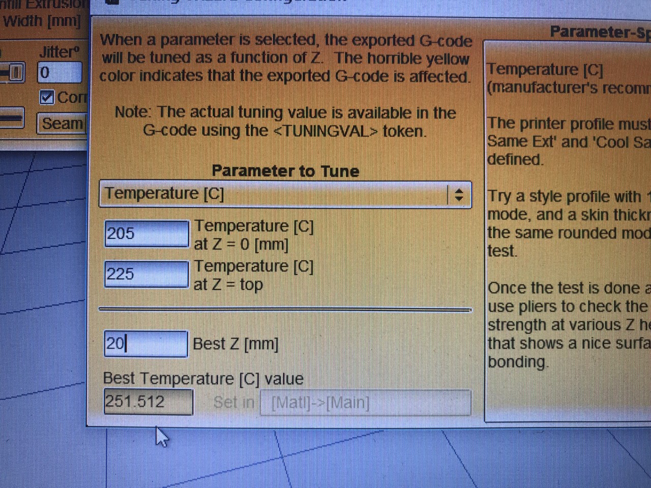

I came across this when trying v2 Alpha. The tuning wizard will give the wrong Best temp on the last step of setting the Best Z (mm).

Questions:
Was there a sliced object in the program when you entered best Z = 20?
How tall was that sliced object?

Yes, the KS wizard block, 25mm
V1.6.3 works - this was V2 alpha
