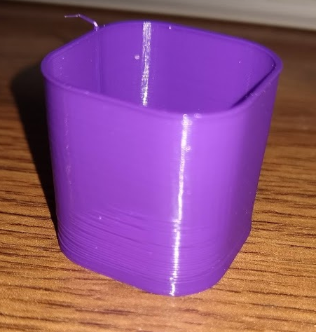

    Using Inland's PLA+ I got the temperature narrowed down to a really narrow range (218-221* it's appreciably better than anywhere else), but when I went to try tuning flow rate the calculator gave me this, and it isn't working for any of the functions now. I've even closed the program and restarted and got the same:
    If I get the wizard working right, how/where do I enter "it worked fine from 12.38mm to 24mm?"

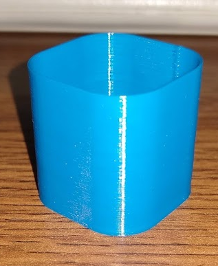

    I also tested some Amazon Basics PLA in blue and got a great result basically from 185-230*C, basically no blemishes besides an under extrusion around half way through, same clean layers. What do I do with that? The little bit of something you see in the LH side bottom half is not really there, that's the way the flash bounced off of it:
    The Inland PLA+ seems to be underextruding some on the bottom layers- you can see light/pinholes through them, the blue Amazon basics one is solid and you can't blow through it even though the walls are thicker on the Inland PLA+ (around .55mm vis about .49mm for the Amazon, I'm guessing that is because of the 1.5 loops setting adding an "occasional" extra loop for strength). How do I fix that?

In your case, the flow rate is fine at about half way (5.5mm^3/s) to 1mm^3/s, so these are the values you need to set in the Max and Min "Flow Adjust" fields in the Material tab of the settings window. But you haven't gone low enough to check the min value. Maybe you should print another model with the value range 7 to 0.1 mm^3/s.
When a filament works with a larger temperature range, you can use the temperature which produces the best-looking finish; some filament will have a more matt finish at lower temps and be glossy at higher temps. Down to you and what you prefer.
However, personally I tend to use manufacturer specs for the Max flow rate (E3D V6, for example is around 11.6 mm^3/sec) and for the minimum, I work on about 50 extruder steps/sec and calculate the Minimum from that.
Quite simply, 3D printing is not a precise science; use the parameters that work and you are happy with and remember that the tuning wizards are only a very rough guide.
I did test down to .1mm, and except for the top lip being mashed and melted (less than the top .5mm) it looked really good. It looks like I have a good, usable range of about 5.1-.4mm^3/s. From the results, it looks like the only problem I have with going faster is some flex only in one direction on the x-axis. It was so cool watching it printing that fast that I'm tempted to try and figure out where it is just to run faster ;-)
That's the crazy thing, there isn't a difference in gloss or noticeable strength across that range. I thought there was going to be a difference in color because I printed the same print with that filament in 3 different slicers and they were slightly different colors. I was expecting that there was a difference in the temperature maintained the way the g-code was output but this test didn't even appear to have a color gradient. Right now I'm tempted to just pick a number like 205 or 210 and run with it.
