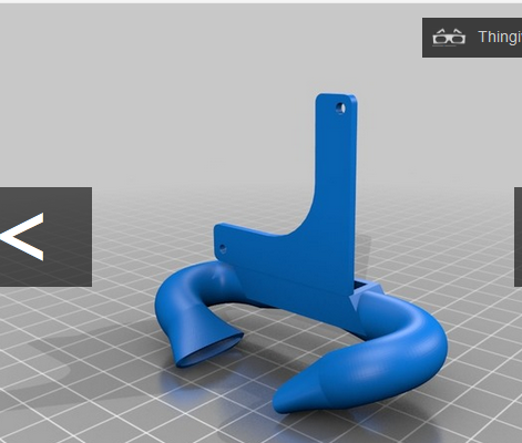

The only thing so far I could not figure out (or just cannot find) if it's possible to tell the slicer not to build supports inside the model (only "touching buildplate").
I'd like to print a layer fan duct (https://www.thingiverse.com/thing:2850837), but KISSlicer always wants to fill the tubes with supports. Any solution for this?
Re: Support only outside
Unfortunately, that is one of the features not yet available withing KISS.
I don't know whether Support Z-roof (only support up to this Z value) would help?
Sorry :(

Thank you. In this case it worked.
