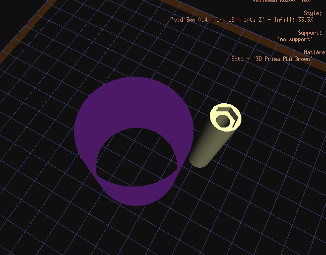

I have problem in import STL with V1.6.2 linux 64 Ubuntu.
One ghost piece come with my STL :
I don't like this cylender and i don't know what he come...
With V1.5 all is ok, no cylinder, only same STL.
One idea ?

Do you have prime pillar turned on in the support tab?

Thank you Peter,
Yes i had prime pillar turned, now is ok
