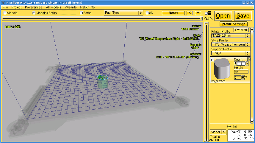

Nicked this[1] from the Lulzbot Cura edition to plug into Kisslicer.
I needed to change the origin in meshlab as Z was below the print surface and X,Y origin was at the top right.
Save somewhere, unzip and stick the STL's file pathname in the "Bed STL Model" box at the bottom of the Printer->Hardware tab.
Hope it's of some use to someone.
