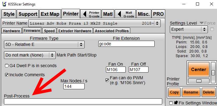

Open the Settings tab and navigate to Printer/Firmware. At the bottom of the window there is an entry field, "Post-Process". Is there anything in this field?

As said, have a look at:
Profile Settings -> Printer -> Firmware -> Post-Process.
Should be a clear field.
