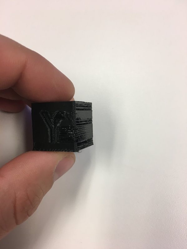

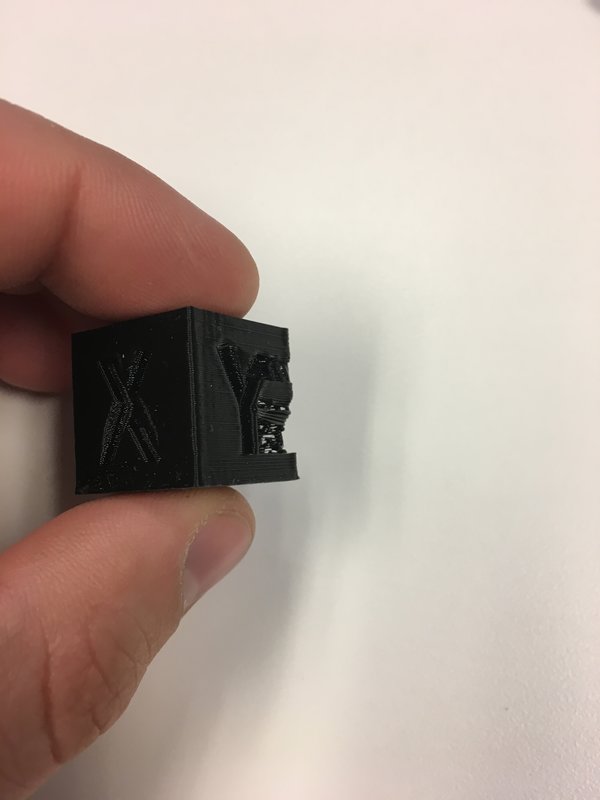

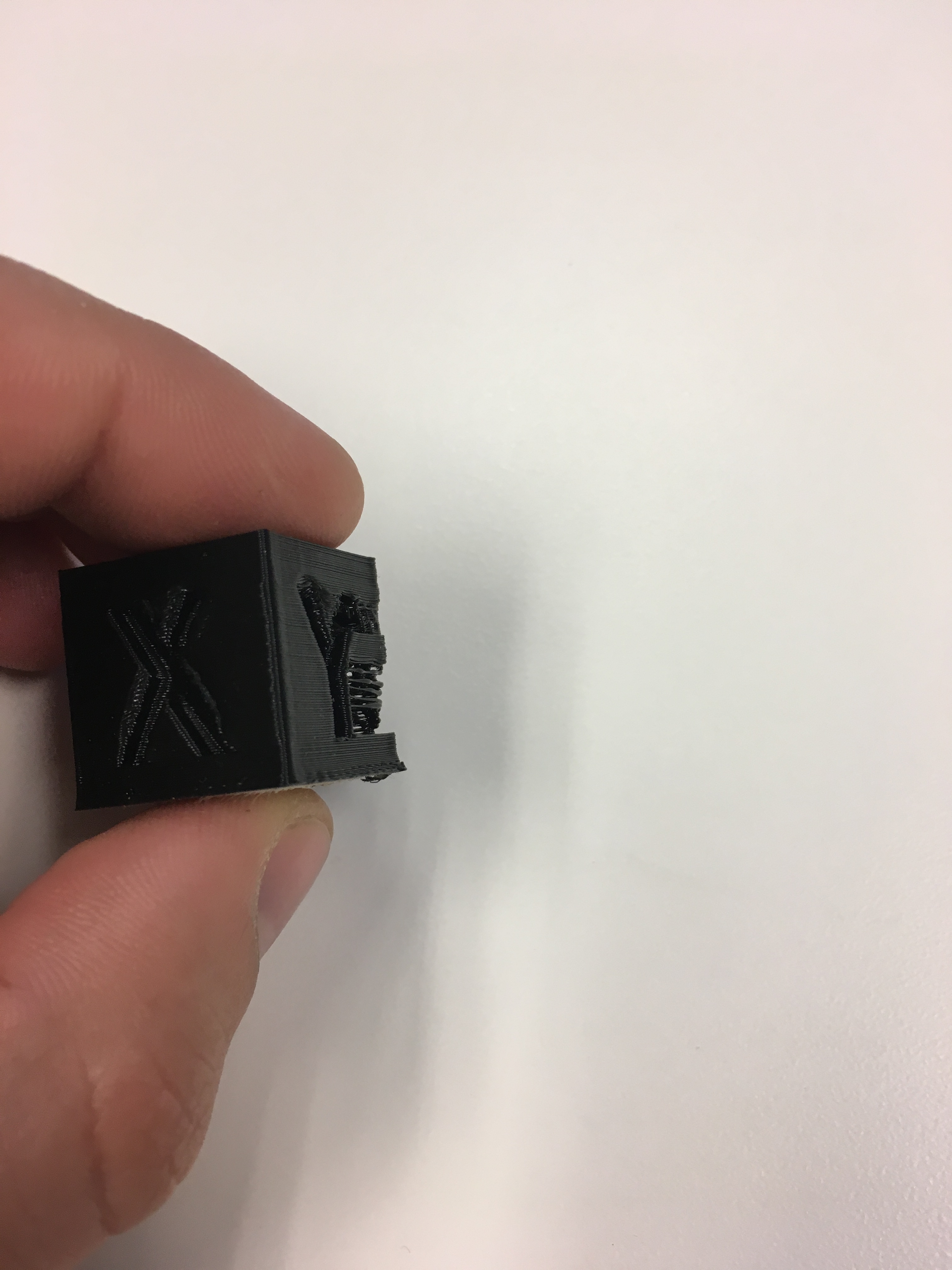

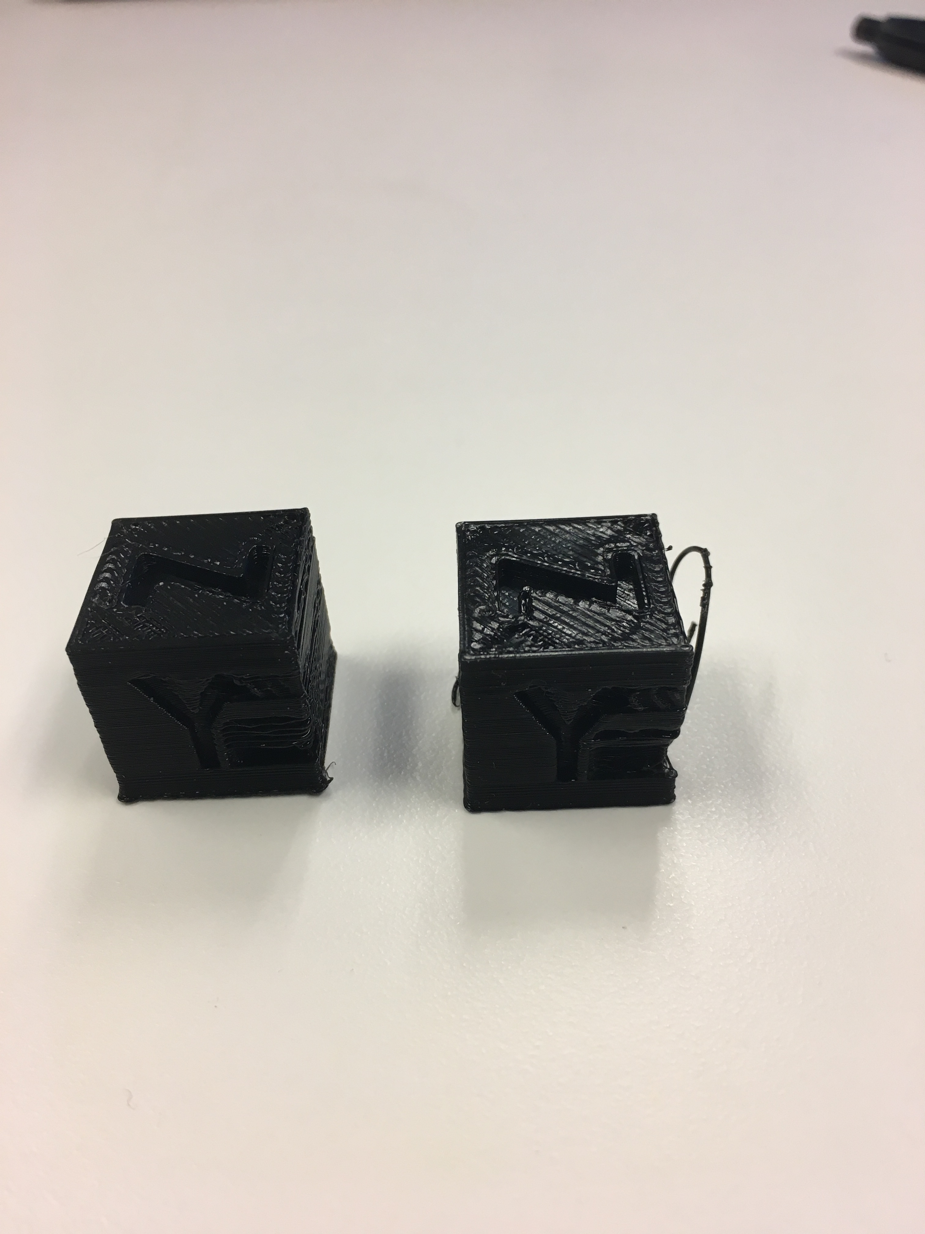

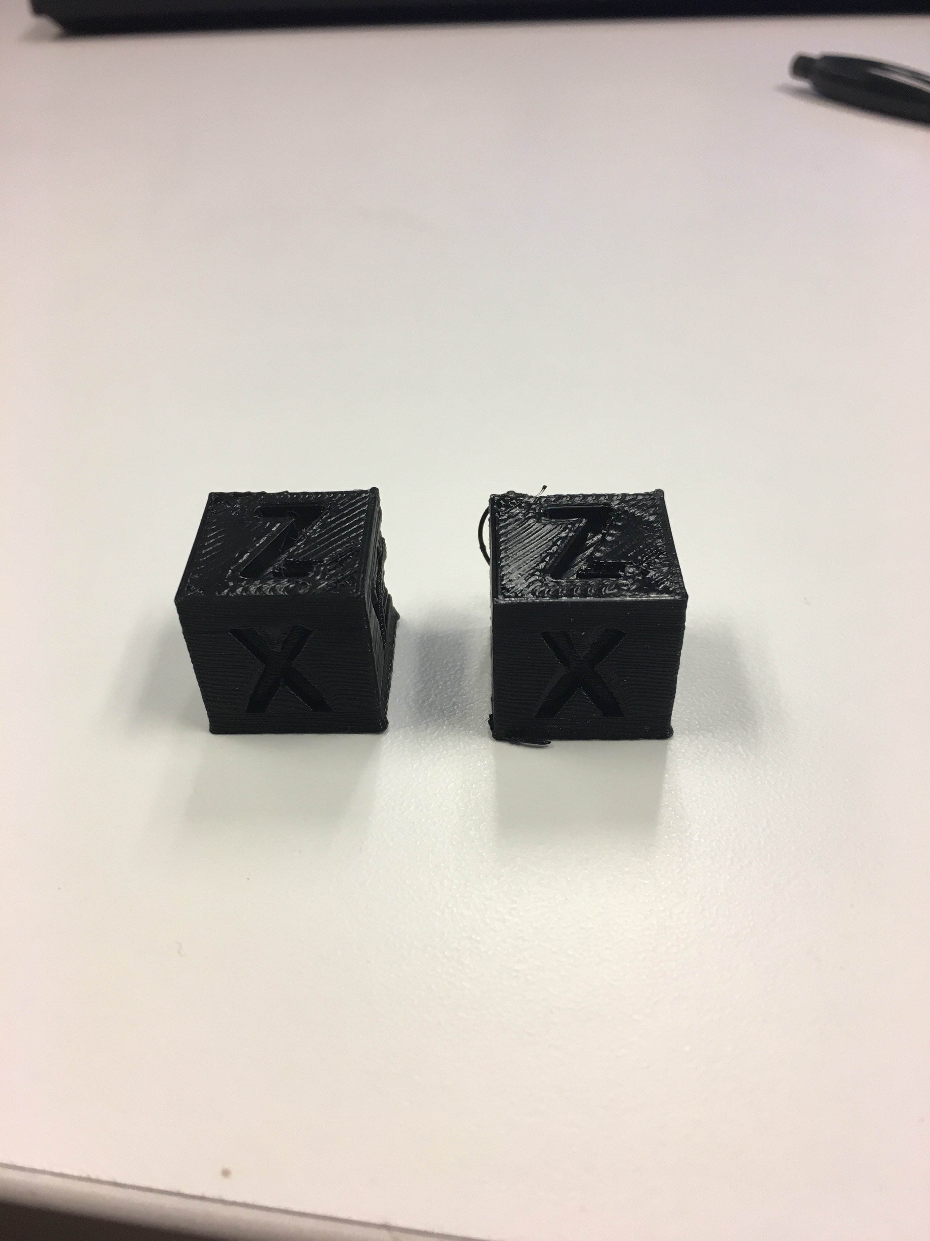

so I ran the calibration wall and they looked... ok I guess, but shortly afterwards I ran the calibration cube, twice (and by twice I mean I ran it once, took it off and ran the exact same print again. not I ran the same model twice on the same print)

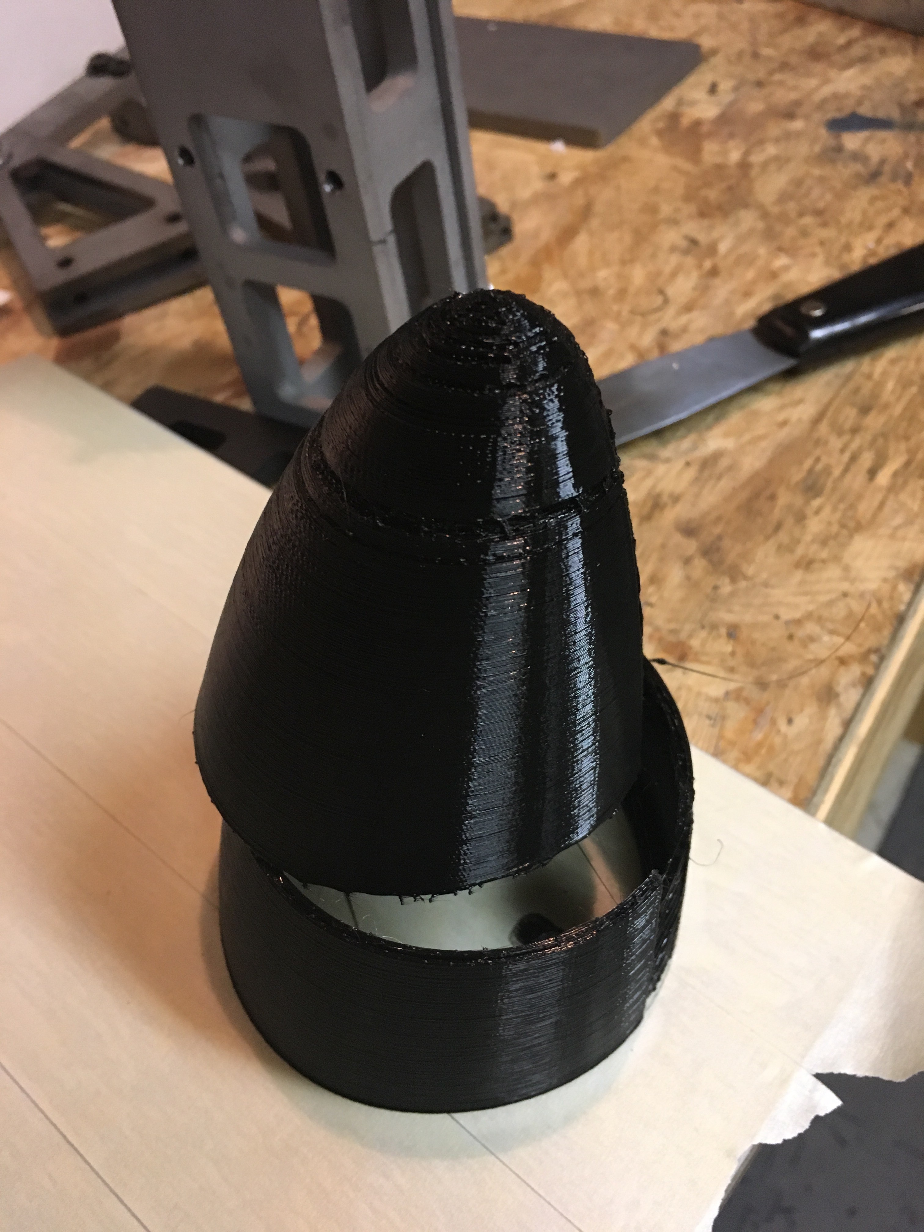

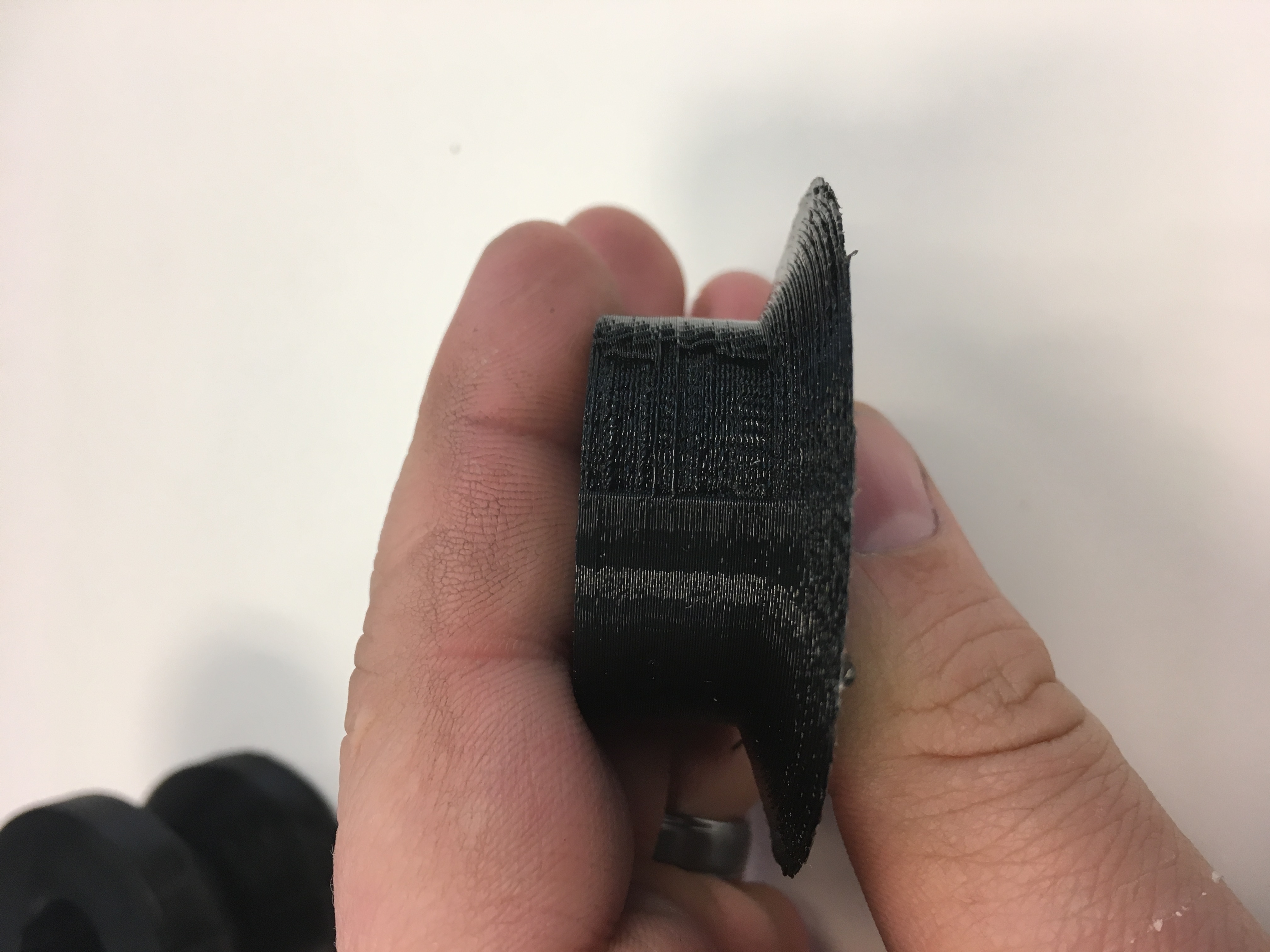

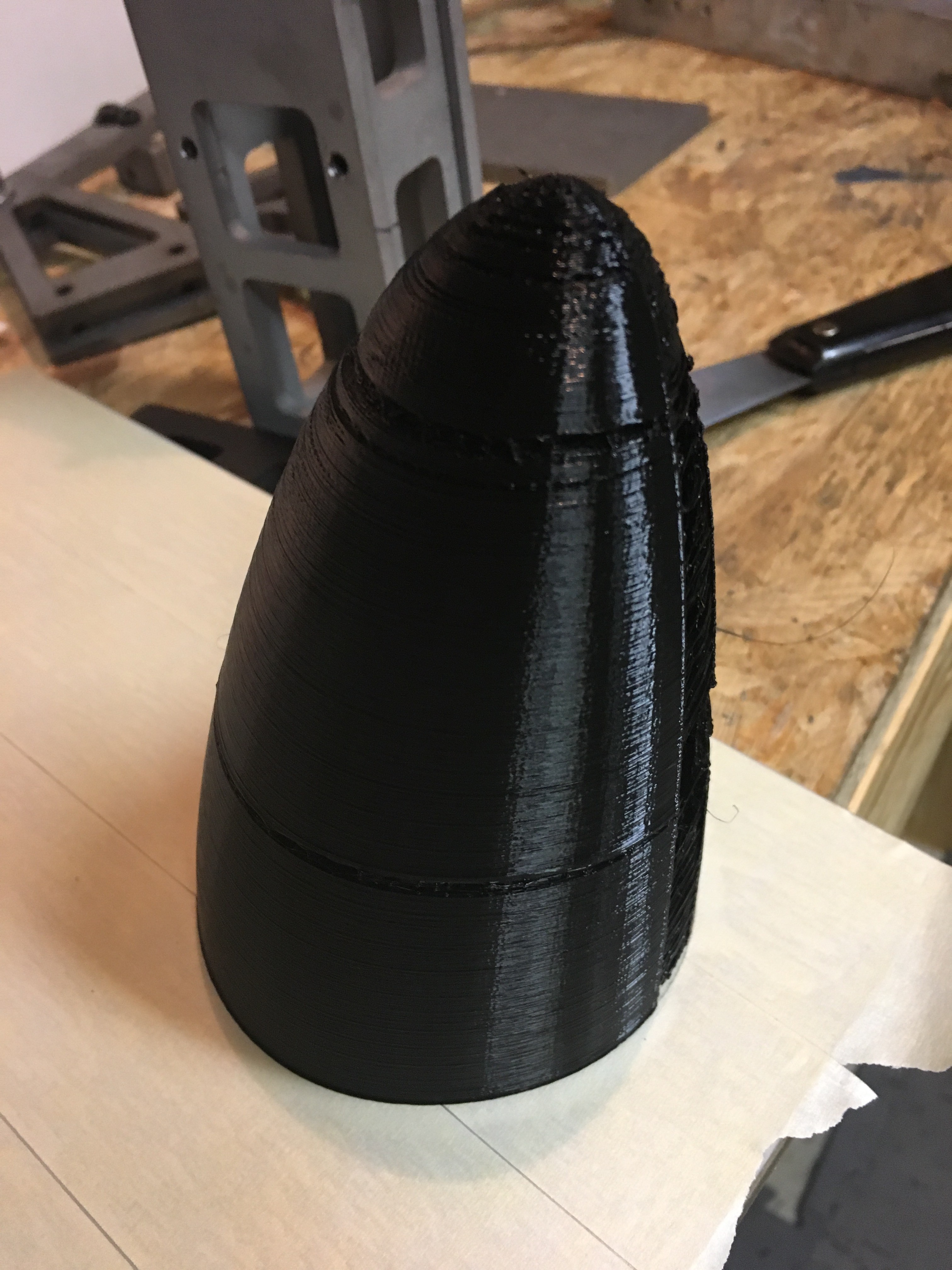

here were the results: As you can see there is one part that consistently doesn't turn out well. so I left it for a few weeks and didn't try anything, then I printed a decently large cylinder for another project and had similar results.

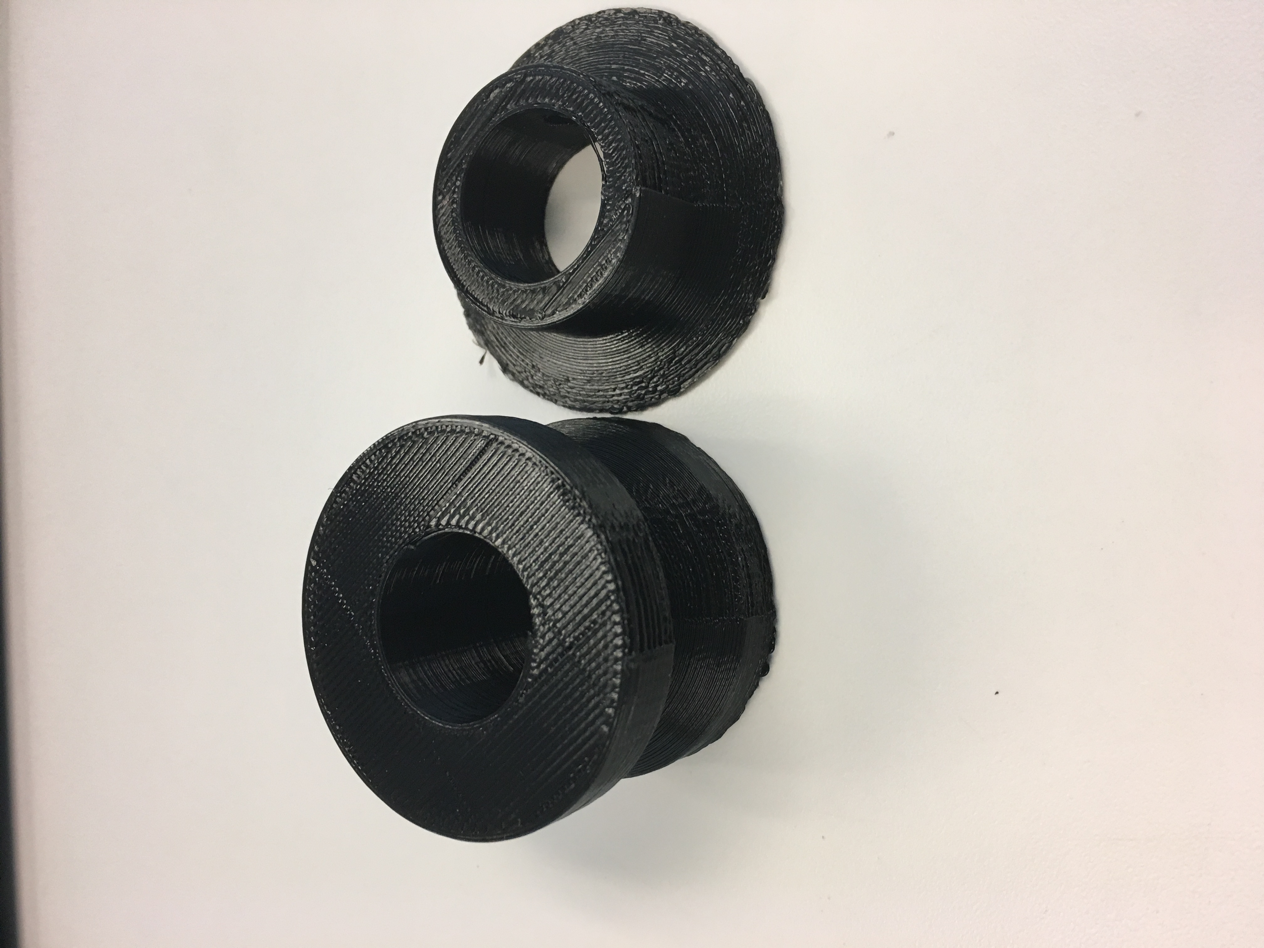

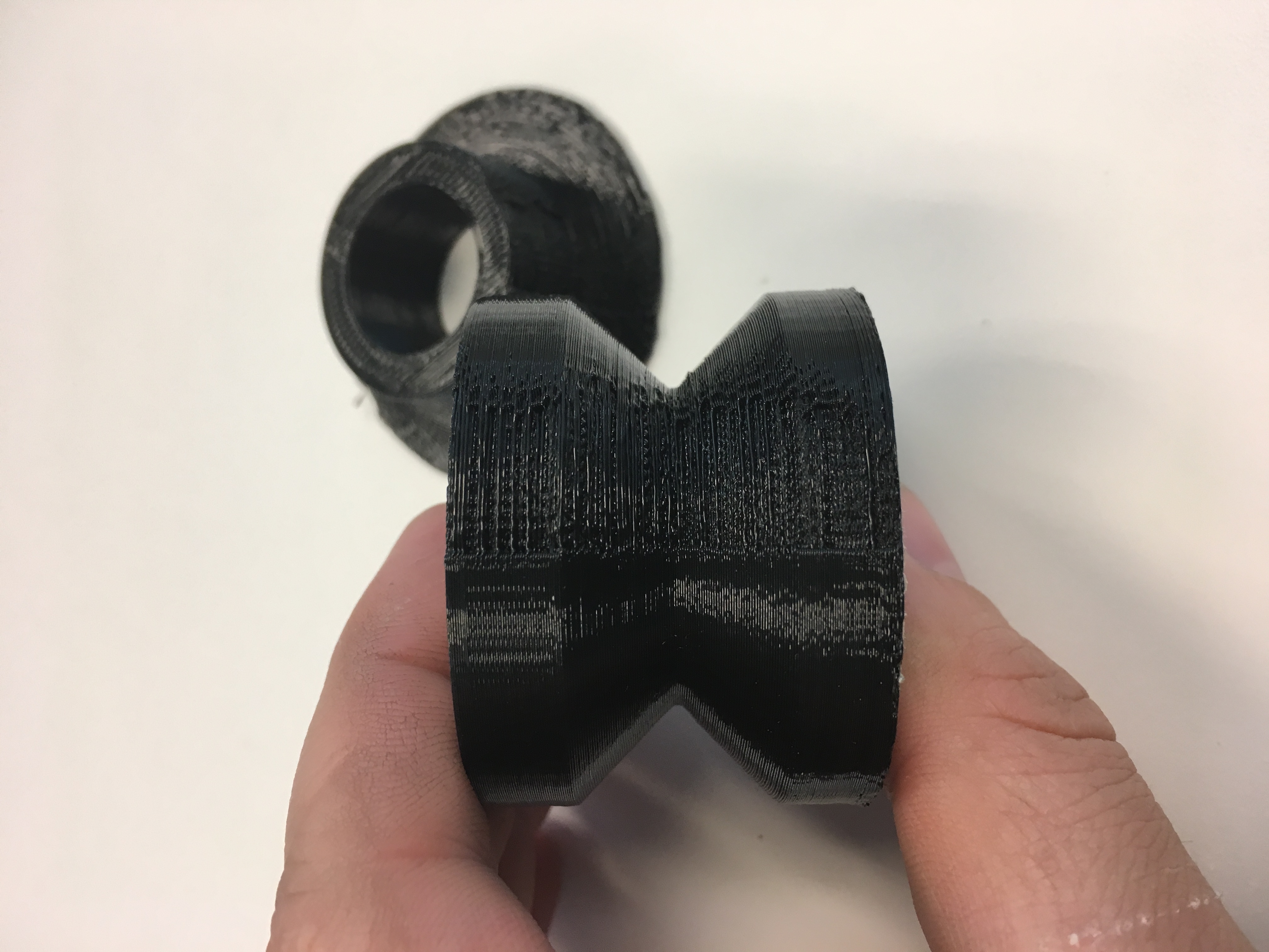

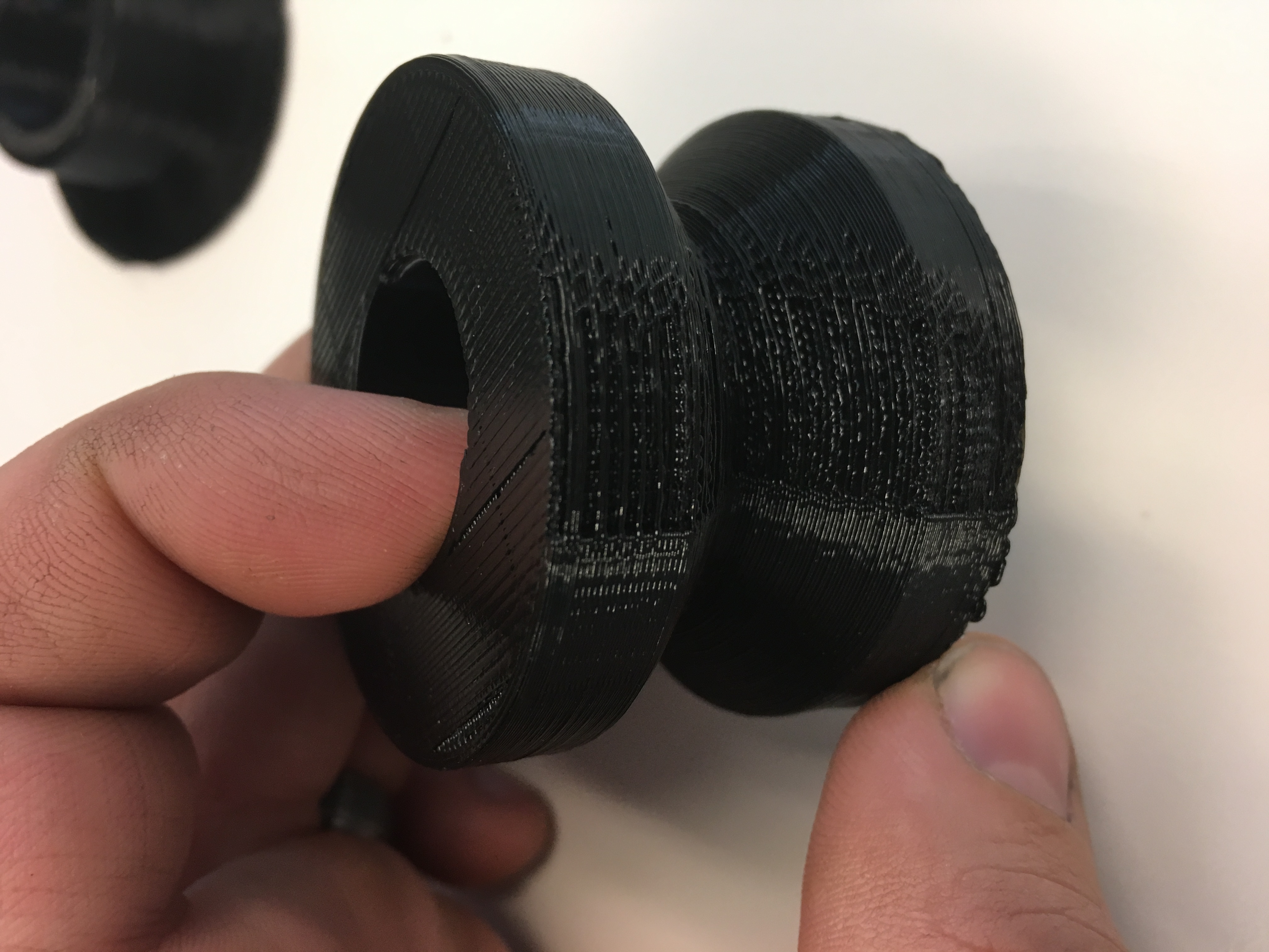

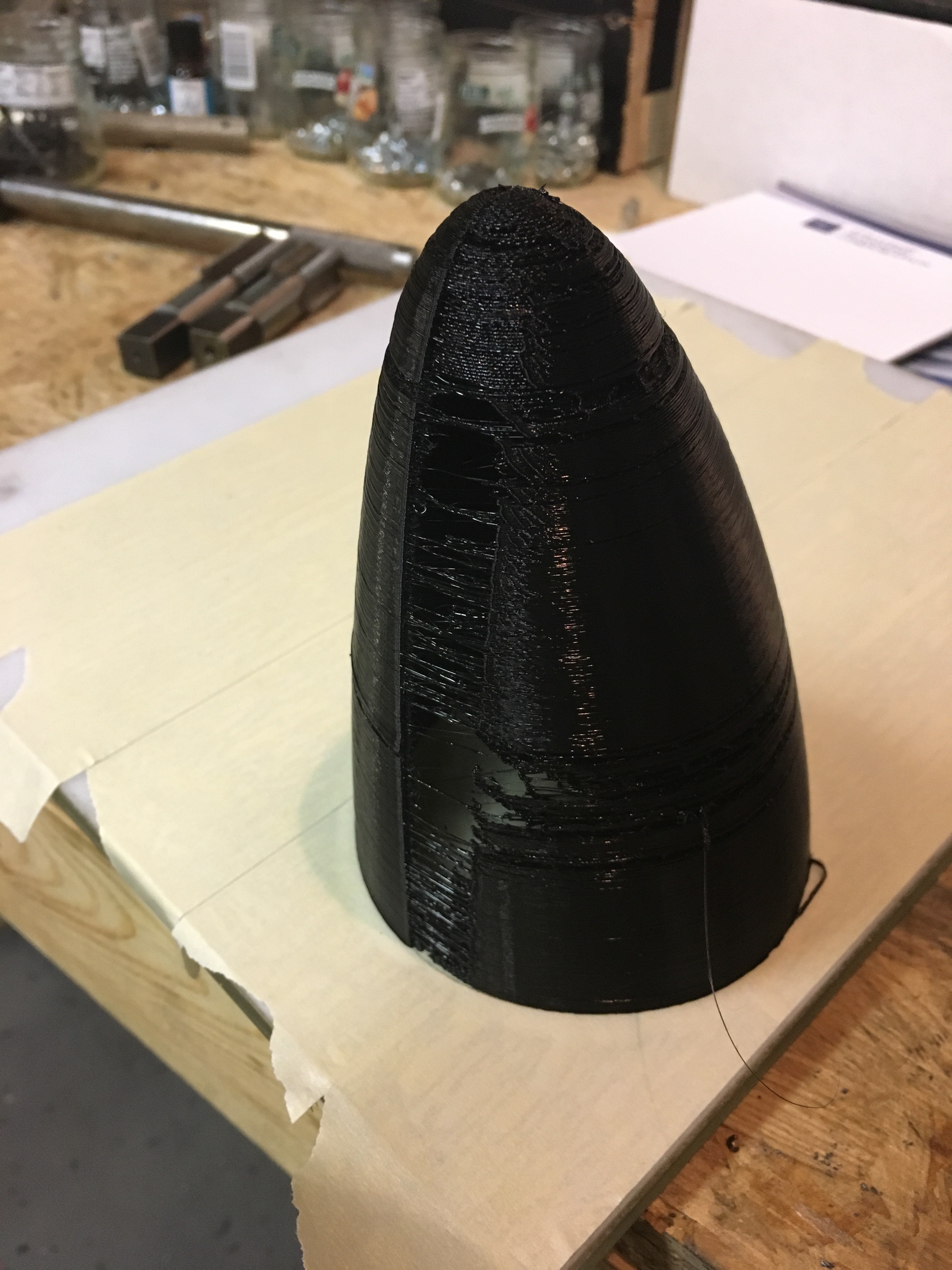

Then last night I printed some dies for my Bead roller before I machine the right ones. and here is how they turned out. again there is this consistent "lack" of material in the same movement on the X and Y axis. it occurs both inside and outside the part:
Has anybody else seen this before?
any thoughts on what it might be?

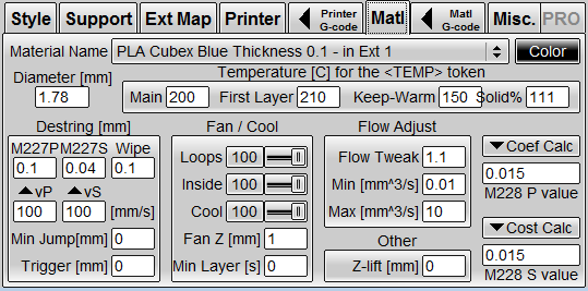

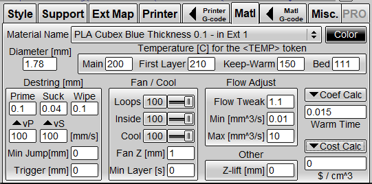

as far as all the settings go please check out the file I attached it has screenshots of all the settings I have used for this print.

Hi,natholego11 wrote:any thoughts on this issue?
looks like a M227, 228 issue.
first try to set M228S = 0
if it's better but not enough you have to reduce the other parameters M227 & 228.
Look into the old posts ( here on this forum or into the Goolge's goups, Cubex or Kisslicer group ) I've described how these parameters works.

This is the screen shot you've previously sent. To change the names into the menu you have to load the language file Cubeitmod.ponatholego11 wrote:Giovanni V. wrote:natholego11 wrote:any thoughts on this issue?
Looking for that value, but I dont see anywhere that says M228S or M228P anywhere in Kisslicer, where is this value you are talking about?

Ok, so I tried a print with M227S at 0 that helped but not enough, so I changed M227P to 0 and that made it worse. Here are the results from that print:
- Posts: 241
- Joined: 18 Nov 2014, 09:34
Re: Cubex Print issue
The last pictures you sent show at least 2 different problems.
1 - seam problem related to M227 M228 parameters
2 - some layers are weak, you have to solve this problem before the seam problem.
Look this :
viewtopic.php?f=20&t=1262&p=3413&hilit=heat+sink#p3395
read the document into the Motor.zip file and check the diameter of your filament.
Use standard parameters like those :
M227P =0.06
M227S=0.02
M228P=0.0
M228S=0.01
After you solved the problem and your printer can print all the layers the same you can refine the seam parameters.
