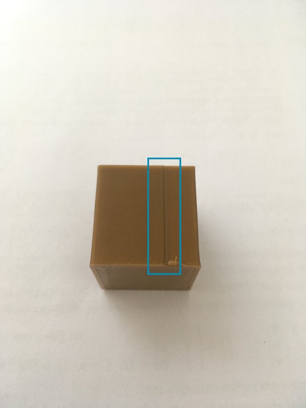

First off all I want to say, that the Kisslicer is really a great software and did the job much better then S3D. After 4 years of printing with different slicers I tried Kisslicer because I saw the blog from sublimelayer ( thanks and really great blog ).
My print quality is so god and tweaking the filament goes so quick. Love it.

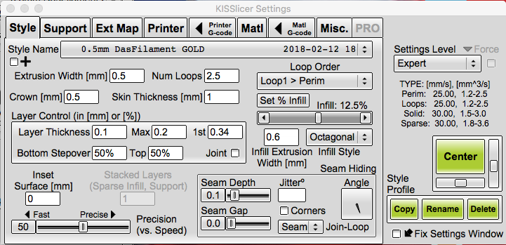

Only one thing I can`t setup, I have a little gap on outside, this don`t come from the retract or the preloade ( I tried various time the tuning wizard and different filament ).
I have tested various settings in
Seam Depth
Seam Gap
Join Loop
Loop Order
and nothing helped.
I`m thankfully for every help :)

It is very hard, if not impossible to hide a seam that has 0 jitter, and is not on a corner.
Check Corners box, and try 360 jitter. That will place your seam on the corner of the model, and will vary position at each layer.

The thing is, the gap is a round 1mm deep. How can I correct the seam cap in + and not only in minus?

Hey J
You are missing a language file for your slicer...
When using that file, it will correct the UI fields..
There are 4 field of interest.
M227 S and P
M228 S and P
There are suck and prime setting at the end and beginning of a loop... Your retract settings to say..
The settings refer to speed and length. Try to search the forum for posts regarding M227 and M228
Regards

This was the first thing that I missed when I started with Kisslicer. With other language pack the function doesn`t show up. When I see the videos on youtube, they have the same look ( Kiss 1.6.2 )
