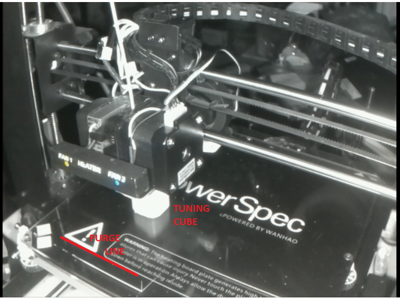

The temp tuning wizard seems to use the default material temperature to preheat instead of the lowest tuning value. I have little to no variation in my tuning cubes regarsdless of my temp ranges. I tried tuning PETG at 220-240 and 210-230 ranges.
When I looked into the gcode it seems that the initial layers are done at the default temp of 220 before lowering to 210 that I had set in the in the material profile.

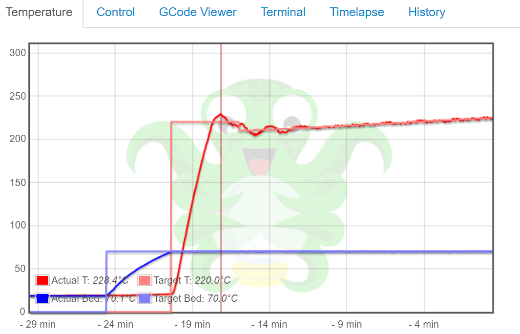

Here is the temp log from Octoprint too. As you can see, it takes a while for the temp to drop from 220 to 210. I do have a nozzle purge section in my scripts, but I dont think it takes long enough for the temp to drop.
Here is a gcode file that I made to try and force the temps to 210 - 220 to try and get the layers not to stick or bond, but the print came out as nice as the 220-230 and 230-240 prints.
What can I do to get the printing more consistent with the temp for better correlation?

Re: Temp Tuning Calibrations
When tuning temperatures, I find it best to go from High to Low.
Doing this, I can set the low temp a lot lower and it's easy to see when it starts to fail.
You will probably find that the temp set in the start G-code is the one used for the preheat; it's not difficult to edit the output G-code file to set this value accordingly.
