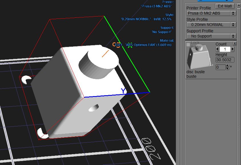

I often print in ABS. To prevent my models from warping, I use "mouse ears" that I put at the angles of my print. I need to place it quite precisely but I can't do it:
Try 1 (loading the 2 objects separately are impossible to move separately to move them at the right position):

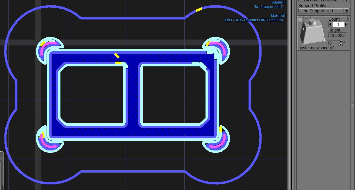

Try 2 (loading multiple STL files into a single model. They are never aligned the way I want, even if in my design, they are aligned correctly):

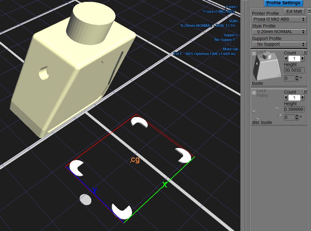

Try 3 (loading a single model where the mouse ears are included into the design. There is a problem into the slicing, because I would like the mouse ears to be considered like a different model, to have it's own perimeters and to be easy to detach. The design includes two components, I would like to be able to split the two components, they would be considered like two different models at their respective positions):

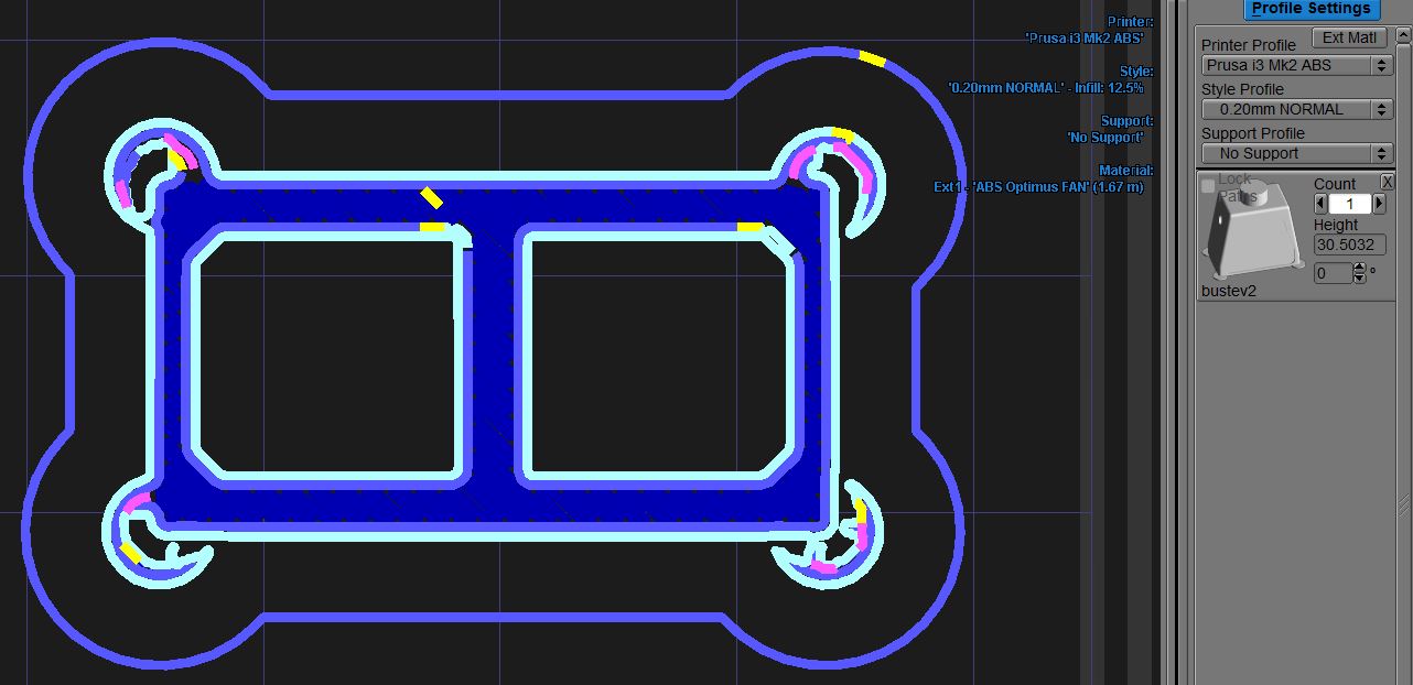

Here's the result I'm expecting, I can easily do it into slic3r, I load my STL file (wich includes my two components), I split the file and just slice it, it's simple and very fast (you can see the paths are different for each component:
mouse ears4.JPG (41.42 KiB) Viewed 3111 times

Hi
TRY3 is a good way...but, when you include ears to the model, try to add an extra space (like 0.02mm) between part and ears.
Regards

Thank you for your answer Olivier13, that works exactly the way I want ! ;)
mouse ears4.JPG (96.88 KiB) Viewed 3086 times
