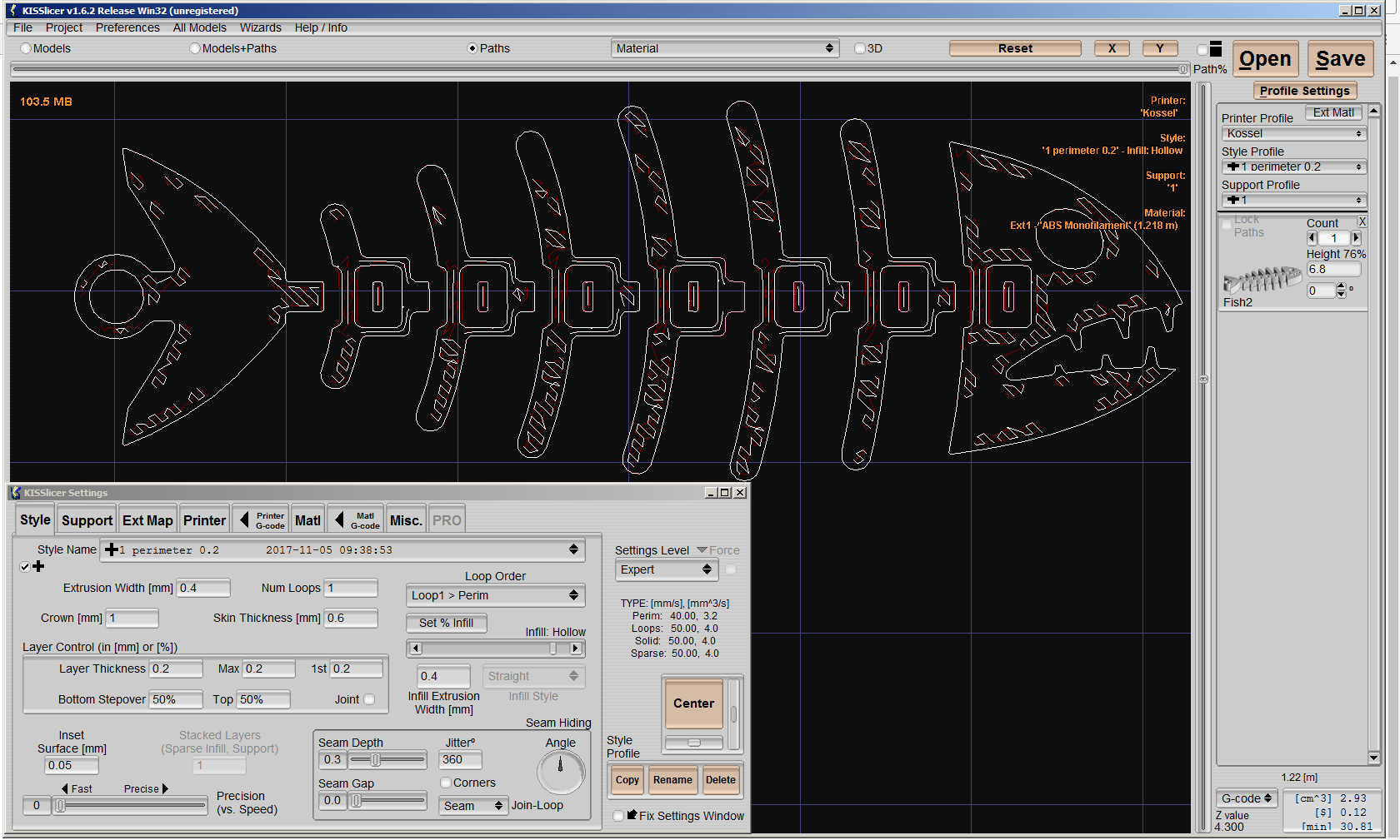

Infill = 0%? But i see many small pieces of infill along the entire height. The number of these pieces depends on the width of the extrusion, the greater the width of the extrusion the less such pieces.
Here's the pictures:
Trouble Infill 1.6.2

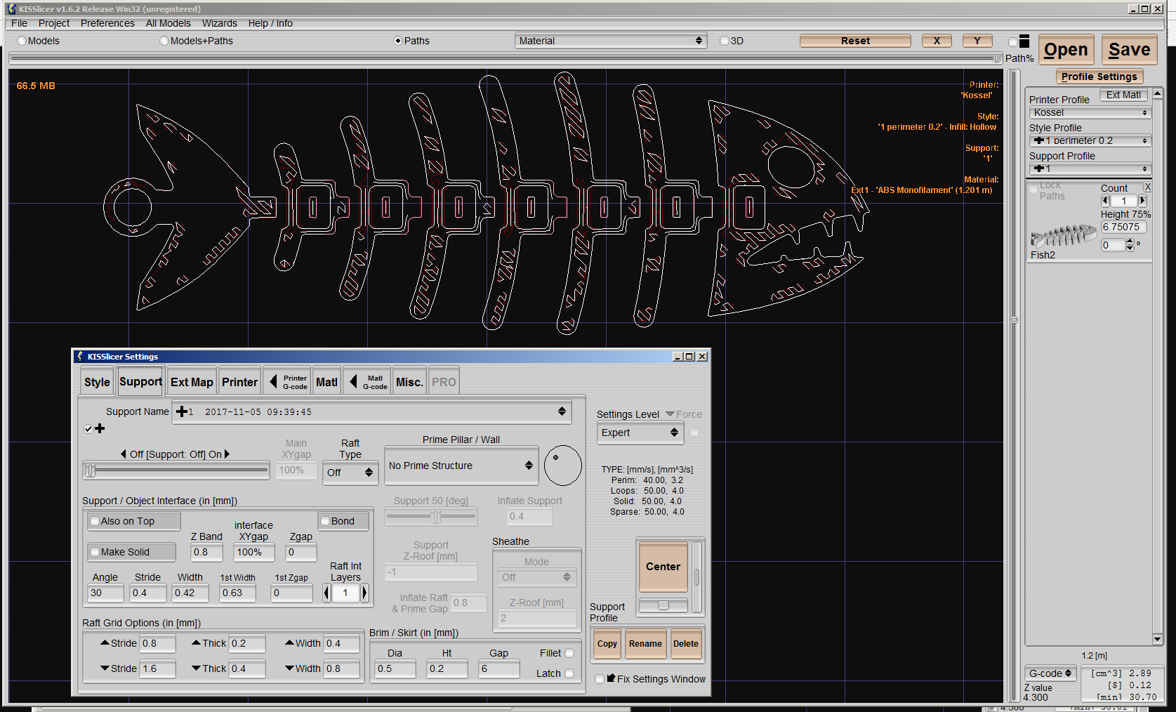

Re: Trouble Infill 1.6.2
It's not like support. On each layer it is chaotically located.
The supports are off.
Please post your KSP file and a link to this model. That does not look like infill, it looks like remnants from support. In your first photo, again, difficult to say for sure, but looks like remnants of raft. But without the file, I can't be sure. I am not aware of any known issues with infill problems like this in 1.6.
You can email or PM me the KSP file. Project->Save Project As to save the KSP.

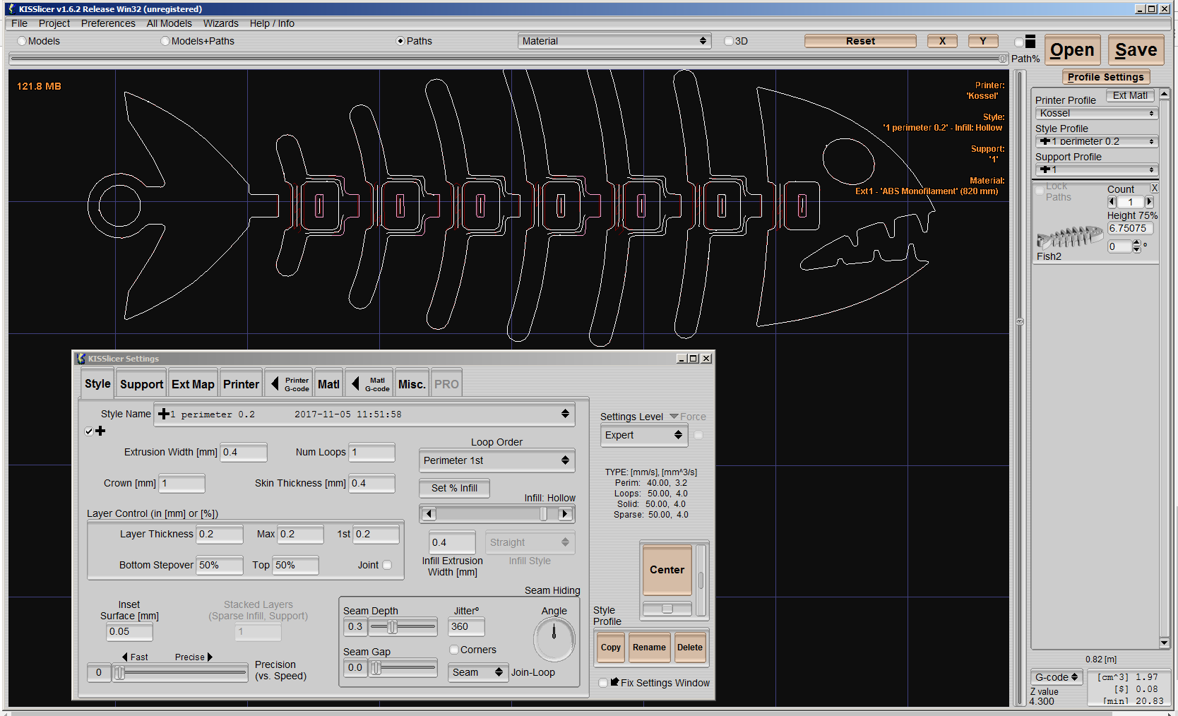

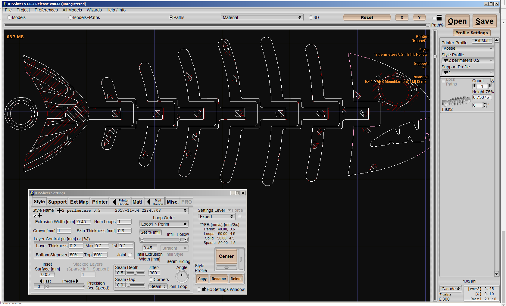

I give the files here, if possible, (in PM i can not make attachments ).
The model needs to be scaled to 75%.
I think that this happens if Extrusion Width * Num Loops < Skin Thinckness. But how, to print the top and buttom thicker than the sides?
Ok, figured it out I think...
Most (if not all) of the infill remnants you see are being put there to support the perimeters as the Z height builds. For example, there are through horizontal holes and a single perimeter cannot support itself so KISS is putting in extra material to support it. This is also true for any tapers or curves that are not nearly vertical. A single perimeter does not offer much support for upper layer perimeters.
Is there a practical reason why you are slicing this with 1 perimeter and hollow?
Is there a reason you have Style->Inset Surface set to 0.05mm? (just curious)

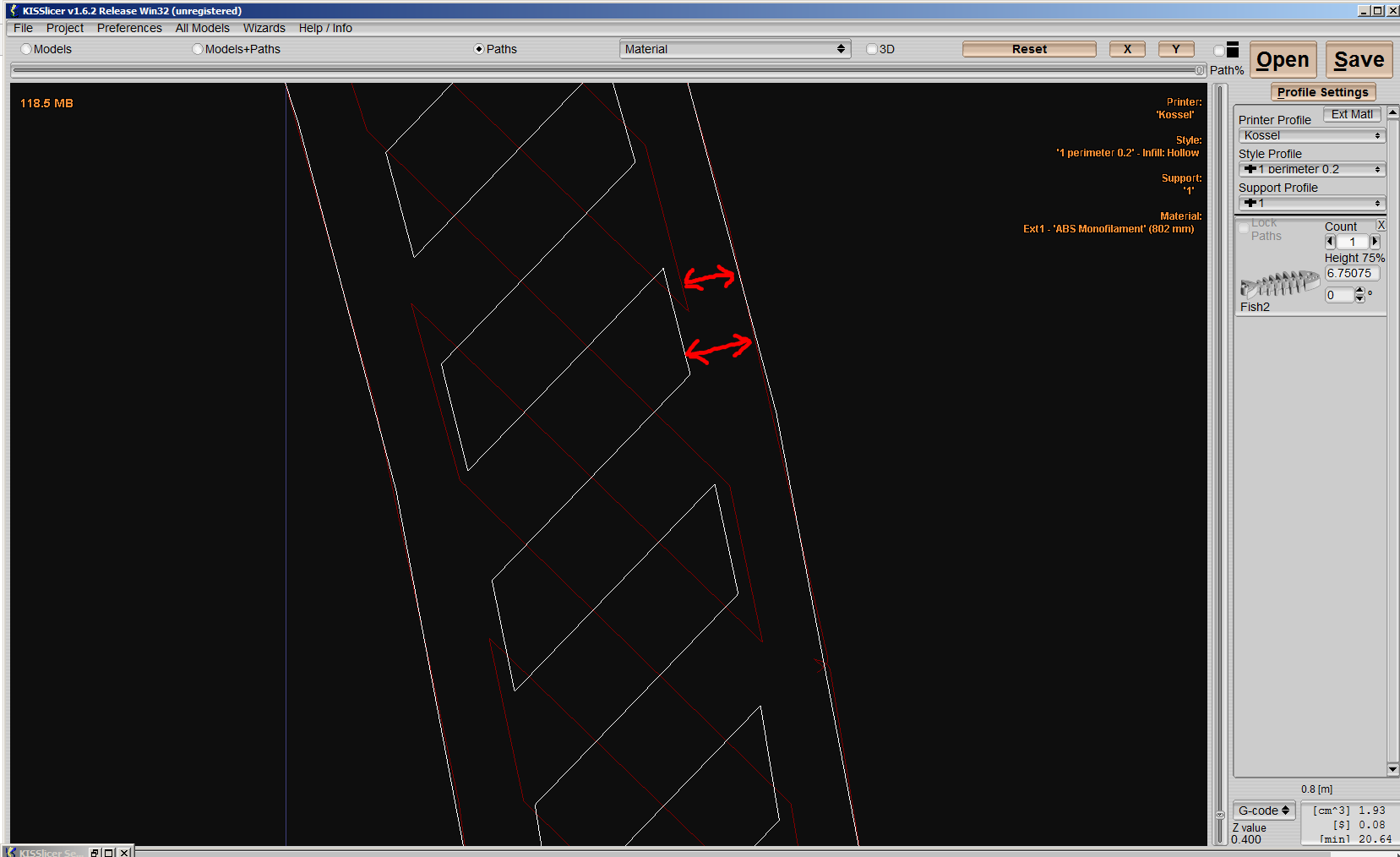

But if Skin Thinkness=0.4mm then everything is fine. But the top and bottom are not thick enough.
Also, I noticed that the overlap of the fill and perimeter is greater in the first layer than in the others (see picture). Why? May be It's logical so to do if it's the first layer above the void.
Now I checked that the overlap in the first layer does not depend on the overlap setting and is equal to 1.
