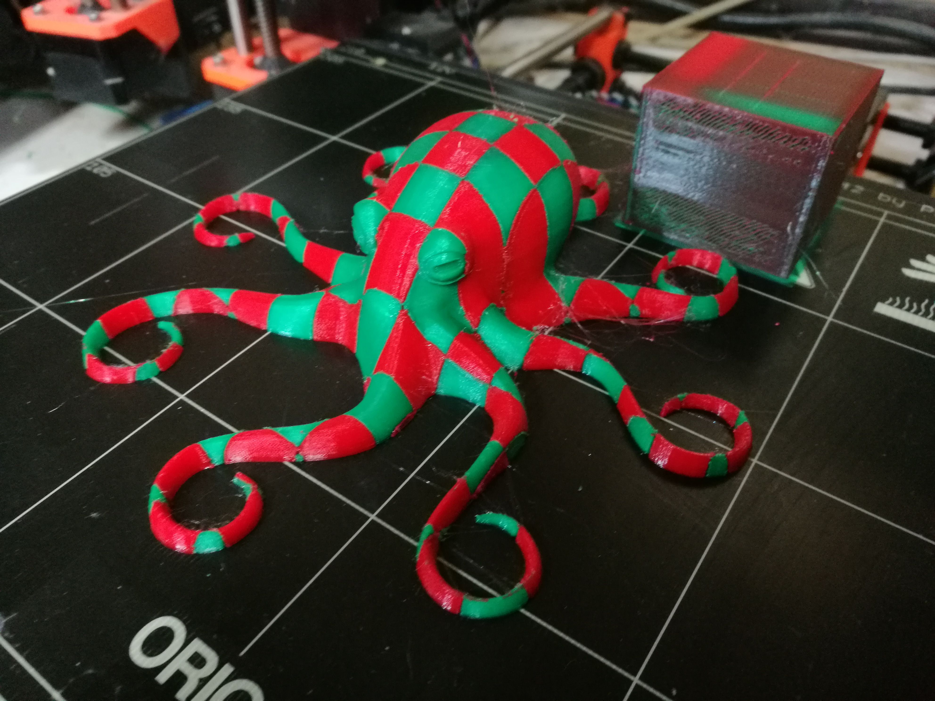

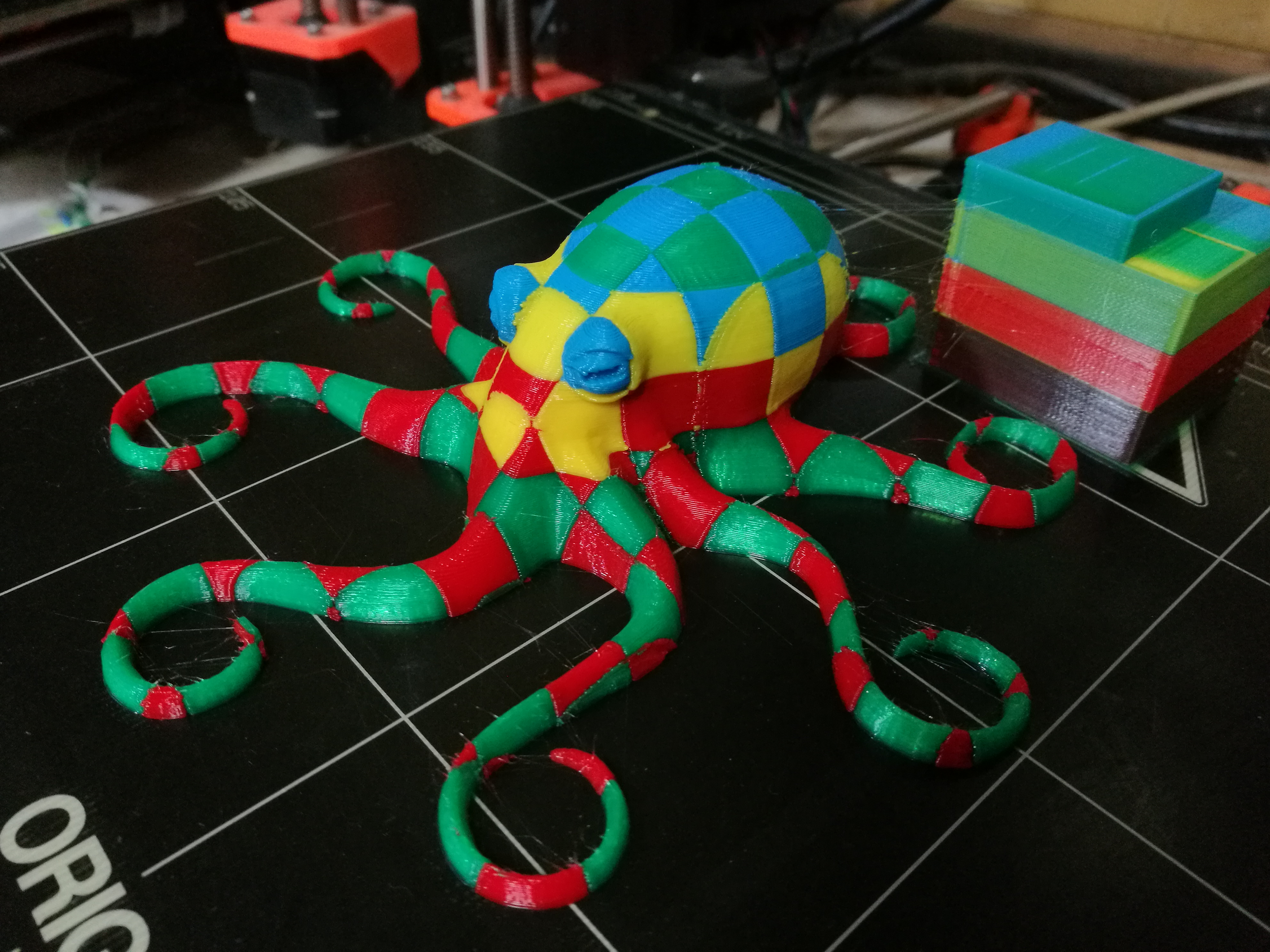

Thanks guys. 8 hours at 0.2mm layers; I also printed the original (https://www.thingiverse.com/thing:244927) with variable layers (0.8 to 0.2) in 2 colours: 14 hours.
The wipe towers are bigger than necessary; I just allowed a regular 50mm purge per filament and on the 4C model, there were 3 layers which came out at 2 changes due to filament ordering.
