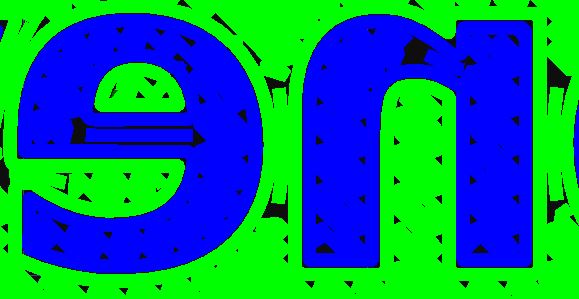

Hello Jonathan,
Please take a look at the robustness of the solid infill / gap fill in Release 1.6 vs 1.6.1 and 1.6.2. Note the smaller gaps in the letters in 1.6 vs 1.6.1 and 1.6.2.
Release 1.6 had good solid / gap infill as shown here:
Release_1.6_Good_Solid_Infill_-_Gap_Fill
Release 1.6.1 poor solid infill / gap fill
Release 1.6.2 poor solid infill / gap fill
