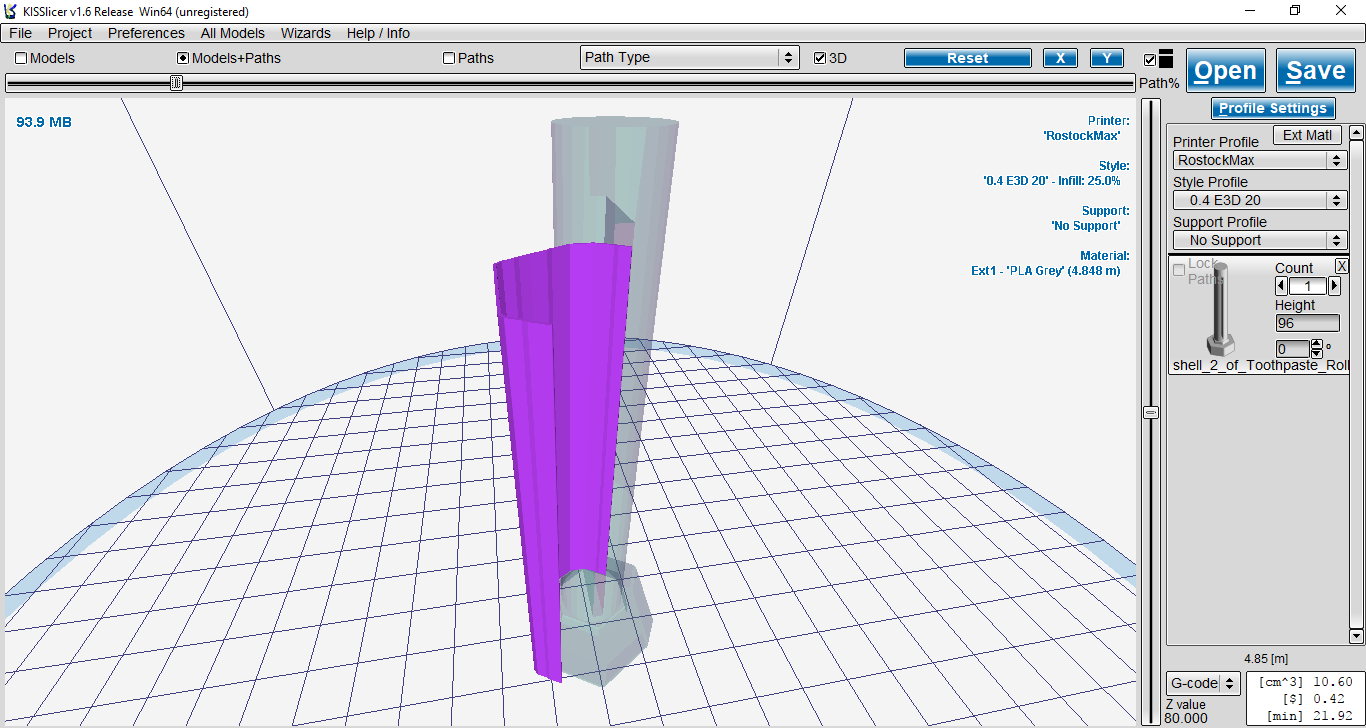

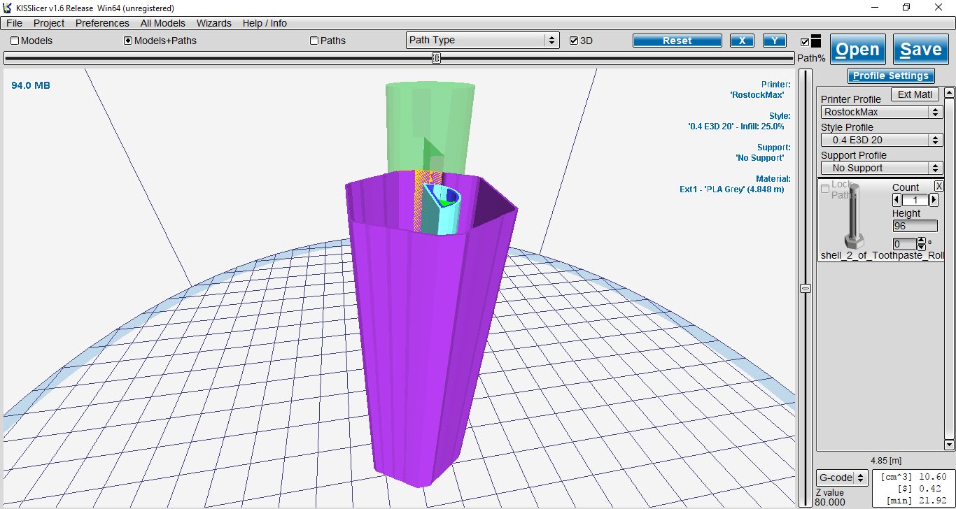

I am using the new release of KISSlicer 1.6, and have problem when I try to slice a part which is higher than the others.
When I click on Slice, the soft start and stop straight after. If I try to visualize the layer I can't move the Z value and it just shows me one layer.
Error slicing
Error slicing
Its look like its something with the heigh, because if I flip the part I have no problem...

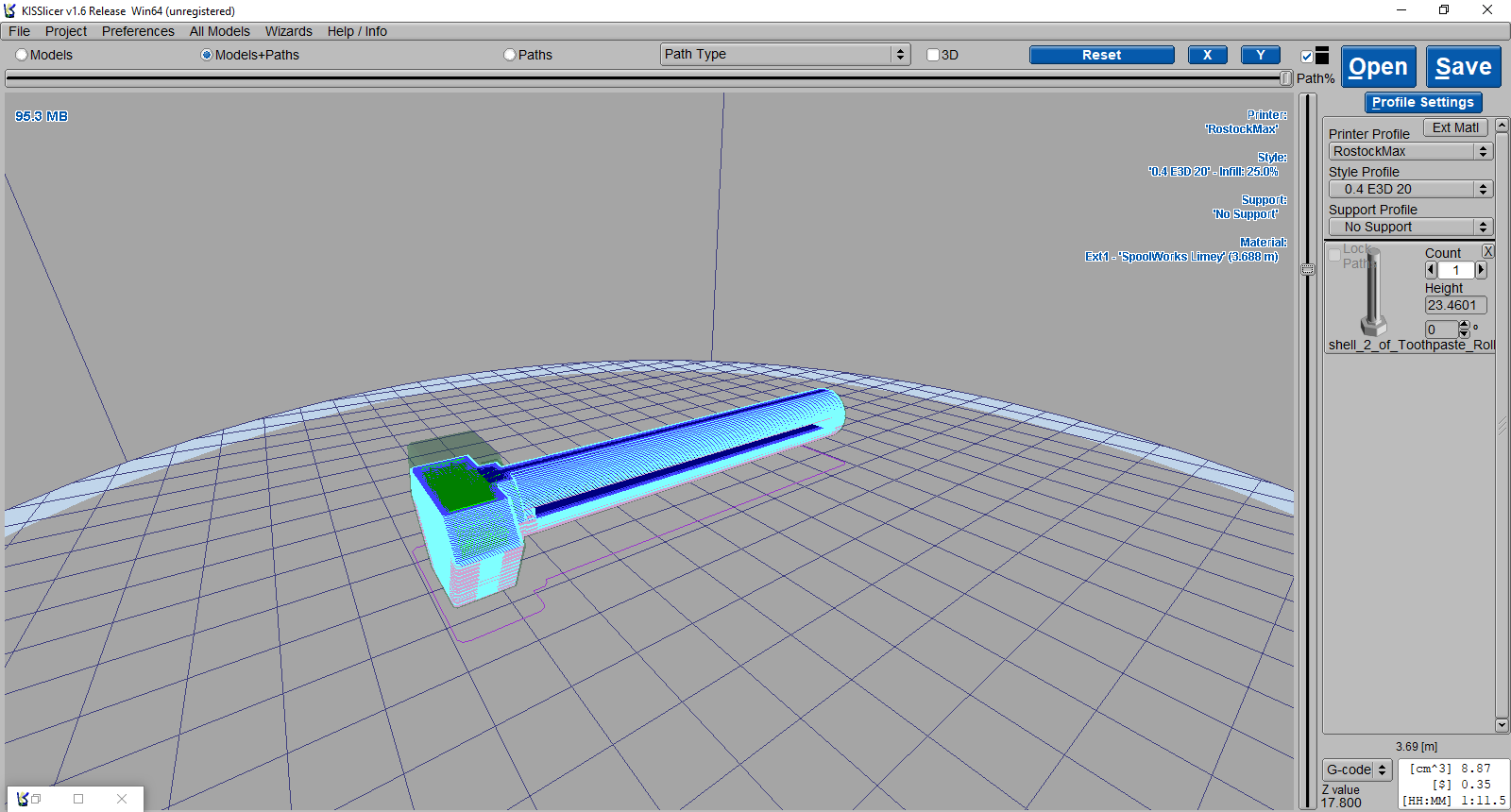

No problem during slicing
someone knows what's going on ?

Hi guys, still have problem and I dont find the solution. The part was correctly slice with an other slicer and I try with Kiss on an other computer and he do the same.
When I moved the path% bar, we can see only one layer...

Hi guys,
I solved the problem, I had put a Z step(mm) of 80 in the printer profile... So back to 0 and it works well. Do not know what I'm supposed to put in.
