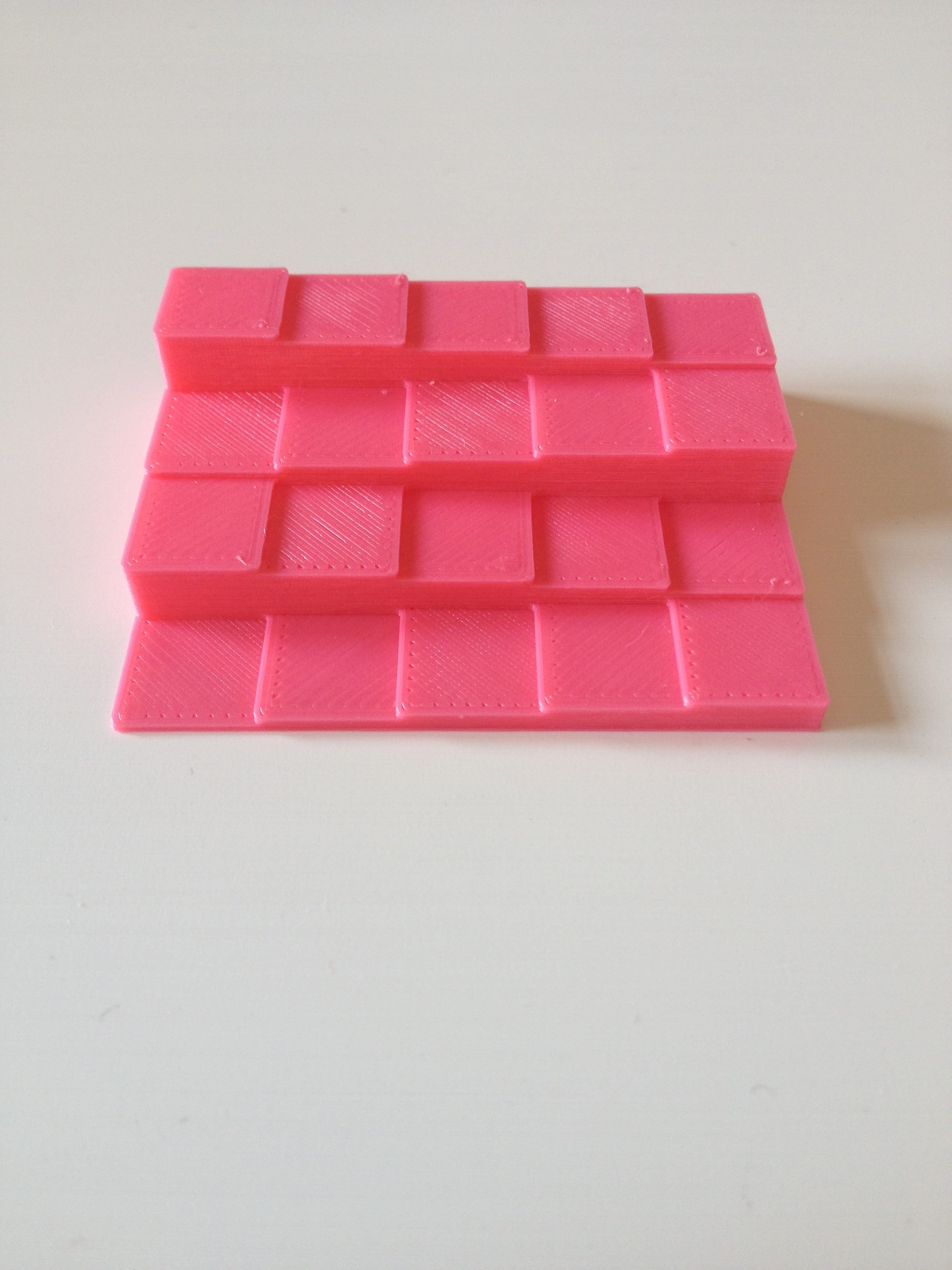

I've got an idea and you will tell me if it's worthwhile, that would use the tuning wizard.
I would like to "create" a tuning wizard which would help me fine tuning my top layers by observing each top layer at different flow tweak value relative to Z height. I've got the idea and the object, but I don't know how to "program" the wizard.
Here's the object: Each "cube" (not a cube but let's say a cube for more ease of use) has got 3 more layers (of 0.2mm) than the previous one. The height increases by 0.6mm between each cube. The height of the first cube is 0.6mm, the second one is 1.2mm...and so on. This way, I was thinking that by counting each cube from the beginning, I could find the height of the best looking top layer and enter this value into the flow wizard tuning (don't need a ruler), which in return would give me the value to enter in the flow adjust (flow tweak).
For example, if the 8th cube has got the best looking top layer, I do 8x0.6=4.8, I know the best top layer is at 4.8mm from the base, so I would use this value in the "Best Z [mm]"
I think it can be useful to get a perfect top layer with only one test print. But I don't know how to create my own tuning wizard (I guess I have to use <tuningval> and "Every N layers" but I really don't know how to do that.) If you, jonathan, or someone else could help me to create this, I would be very thankful.

Re: Flow wizard
That's a very cool idea. I would probably try it by setting the steps per mm for your extruder. You will need to know the proper number of steps per mm for your extruder to start with.
For example, if your correct steps per mm is 800, you could test a flow tweak from 1 (800 steps/mm) to 1.1 (880 steps/mm) by setting the <TUNINGVAL> from 800 to 880, then in every N layers (with N set to 1) use the G-code:
"M92 T0 E<TUNINGVAL>"
You will probably need to tweak things a little to match your machine. And don't forget to set the correct value again in the Postfix! (G-code is a state machine, and we just messed with the state!)

Re: Flow wizard
Thank you Jonathan. I understand the idea.
I've got a prusa I3 MK2, the step per mm of my extruder is 161.3
I want to start the flow tweak test from 0.9 (161.3x0.9=145.17) to 1.1 (161.3x1.1=177.43)
Until here I understand.
-But I don't know how I set the <TUNINGVAL> from 145.17 to 177.43.
-I don't even know how I can use the G-code in every N layers (with N set to 1): "M92 T0 E <TUNINGVAL>" (where in kisslicer should I type all of that?)
Sorry I'm a noob concerning G-code...perhaps I should wait for the kisslicer 1.6 manual to understand all of this.
Anyway, thank you for your time.
Re: Flow wizard
The way I understand things, in the wizard, you select <TUNINGVAL> in the "Parameter to tune" and then set the start (0) to 145 and the end (top) to 178 (rounded).
Then in Settings/Printer G-code/N[*} Layers, you enter the M92 G-code suggested by Jonathan, and ensure that [*] N Layers on the left is set to 1.
