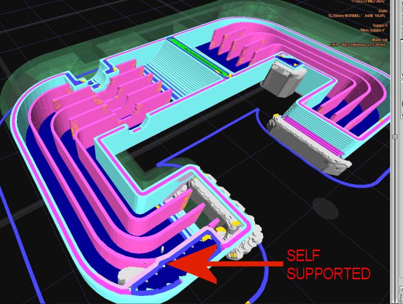

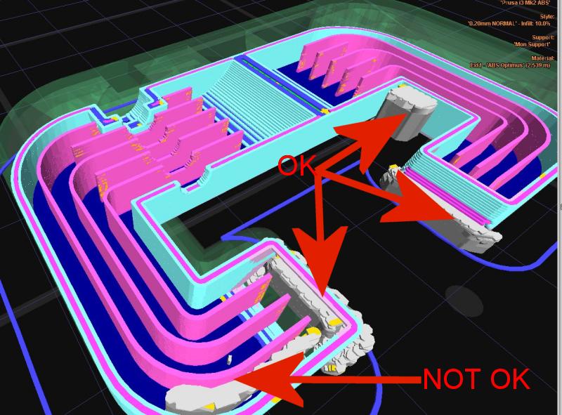

Thank you for your answer Peter, I've already tried to use Support Z roof, but I need supports at this height somewhere else in the print.
Here's my problem:
Red arrows show where KS put the supports:
supports KS.JPG (86.32 KiB) Viewed 5243 times
In the layer just following the one above, we can see that the support inside the print is unecessary, it is self supported (a bridge), and it will be almost impossible to remove:

Is there a way to remove only the support I don't want ? One option would be to use supports that are only on the build plate, but I can't see this option.

EDIT: also have a look at the images you uploaded. The supports where you don't want them to be - there is no air path to that part of the model.

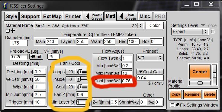

-"With ABS, you may need to reduce the Cool volume to Min and use the fam when cooling." --> do you mean this (circled in red) ? What would be a good value to start with concerning ABS ?
Do the values circled in yellow suit ABS also ?
- And finally, you're absolutely right, I didn't noticed there weren't air path to this part of the model :? but, if I would like to remove this support nevertheless, for another model, would it be possible ? (for example, an option that enables supports on the build plate only...)

woody3dp wrote:-"With ABS, you may need to reduce the Cool volume to Min and use the fam when cooling." --> do you mean this (circled in red) ? What would be a good value to start with concerning ABS ?
As I don't print with ABS, I don't really know. I believe Jonathan uses mainly ABS, he may be along shortly, but I do think you should start with the settings in your image to see how it goes.
woody3dp wrote:- And finally, you're absolutely right, I didn't noticed there weren't air path to this part of the model :? but, if I would like to remove this support nevertheless, for another model, would it be possible ? (for example, an option that enables supports on the build plate only...)
I haven't found a way to do this (at the moment). Maybe this will be a new feature in V2?
