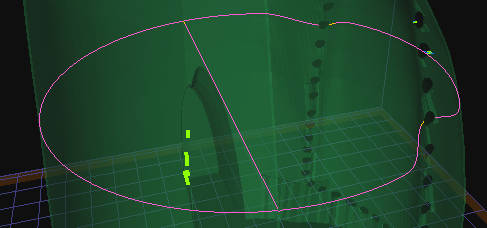

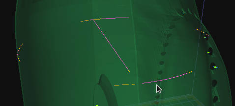

I have found the problem with thin walled models that made me almost go to an other slicer :)
I want to slice flying rc-planes, and have constructed some parts using blender. My actual project did not slice in kisslicer to get a perimeter with only one loop.

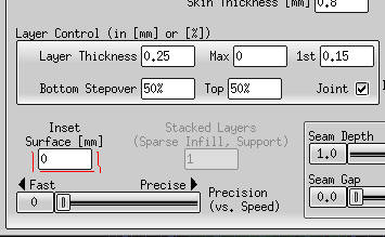

Without changing one parameter in style-setting, the small wall of the model is not completly rendered.
The value for the inset-surface is to be changed to a small value, i choose the value of zero
After this cahnge, the model can be rendered correct to print with only one loop as wanted

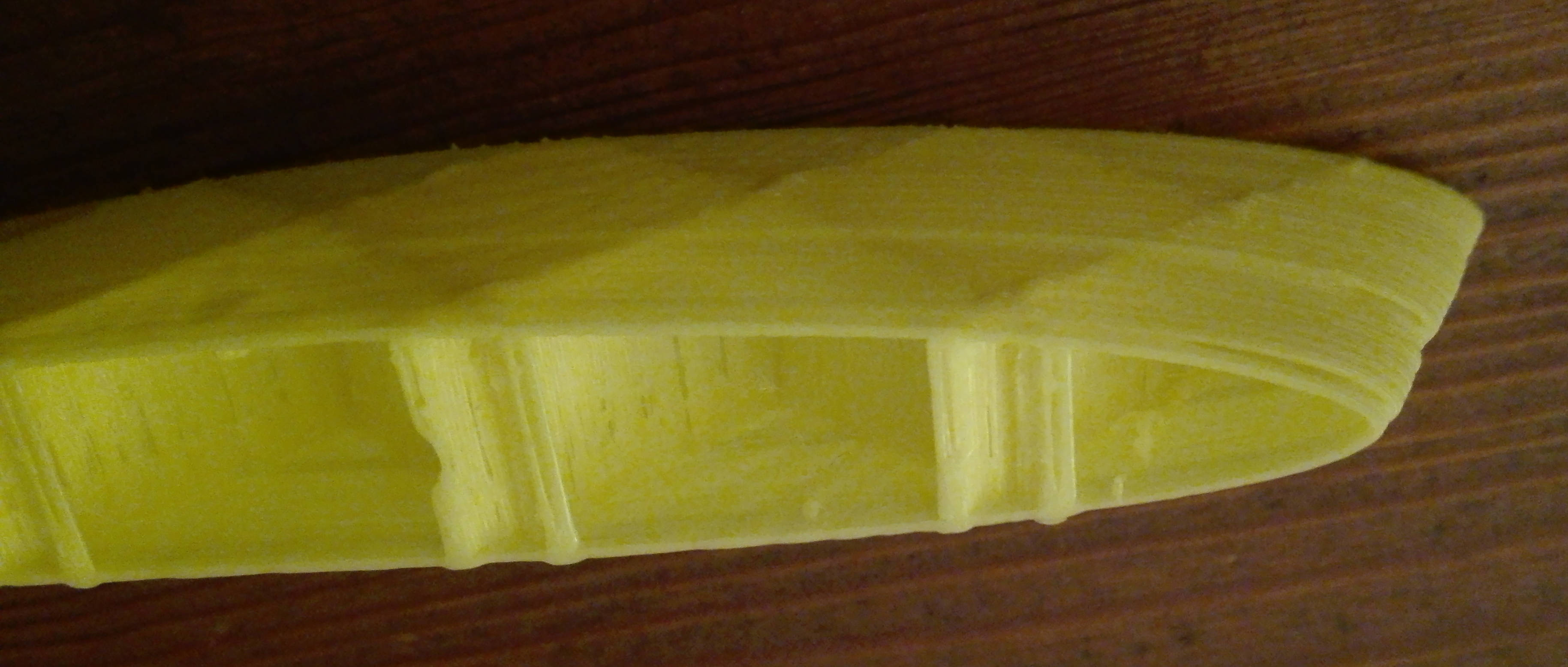

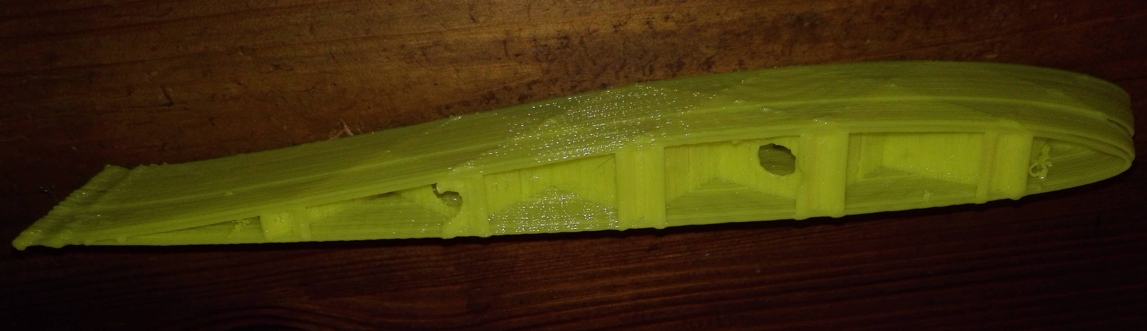

Have a look at this wing-part (was aborted cause ty y-axis looses a step)
Its a very stable thing, you can not bend or break it easily, but i need to put more current on my y-stepper.
