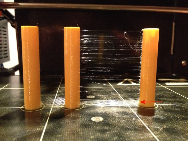

I'm experimenting the destring wizard. I own a Prusa I3 MK2. The preload was done (I found a value of 0.62).
First I was experimenting a lot of stringing but in two stages (printed at 195°c):
- first stage (red arrow): dense stringing. I think this is destring parameter gradually increasing (I configured the wizard from 0 at 0mm to 1 at 50mm) am I correct ? This dense stringing disappeared around 5mm and the seam is perfect around 7mm. This gives me in the wizard a value of 0.14 for the destring.
- second stage is the light stringing until the top of the print (by the way why is there more stringing when parts are more distant ?)

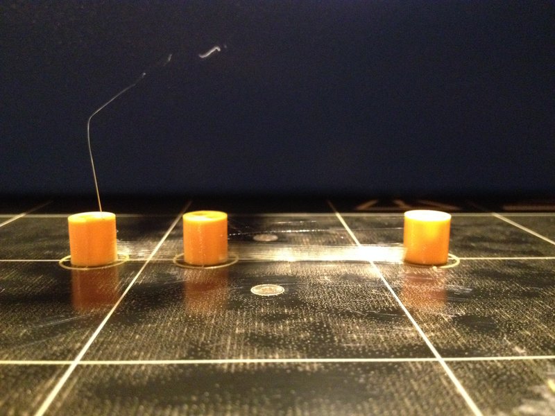

Peter told me to put 1mm into the wipe parameter to correct this. You can see the result in the picture below:
I stopped the print because there were no stringing anymore above 5mm (or very very light), and there was no blobs anymore. I think I've got now good preload and destring values to tune the seam.
But in fact, the destring wizard didn't work for me the first times because I was printing around 210°c, all the stringings were confusing, I didn't know what to do until Peter advised me to change my printing temperature and my wipe setting. So don't you think the temperature wizard should be the first one to be configured, before preload and destring ?
