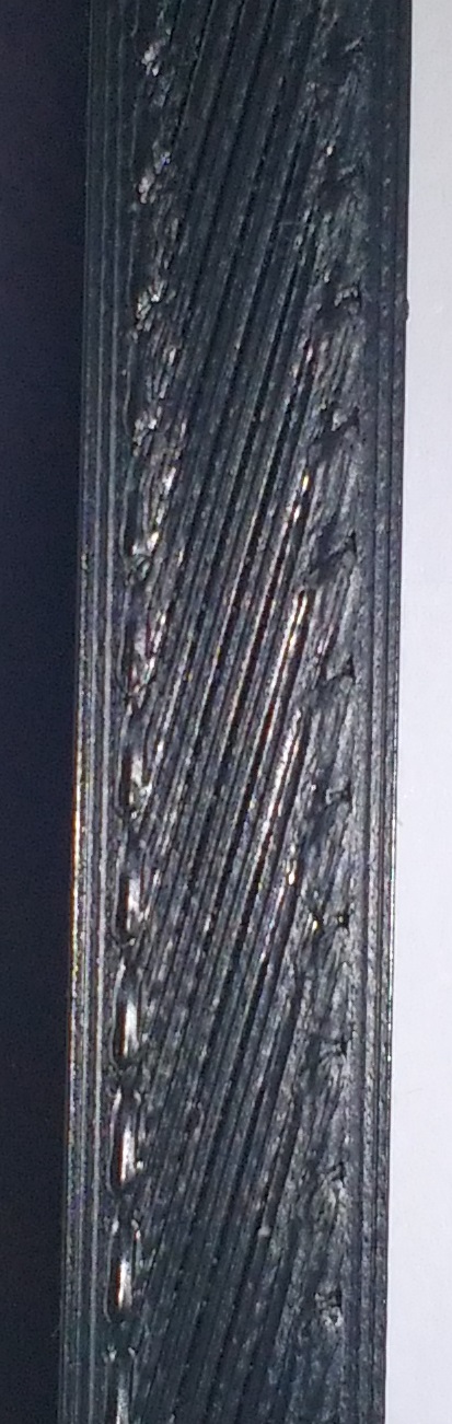

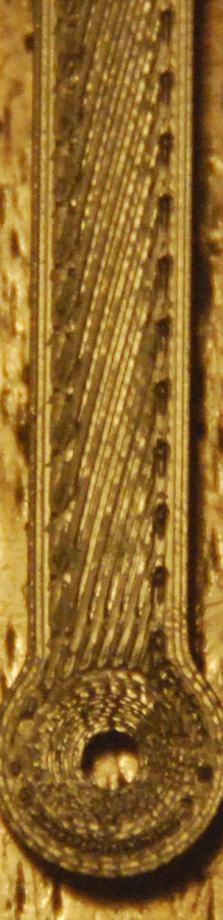

Hello,
I've got the same spaces between the lines on the top layer.
A bit hard to photograph with black filament, looks like a gap on some fill angles of 0.1 to 0.2mm.
Not all parts of the model have the same problem.

Do you know about Style->Crown? and Printer->Loop/Solid Infill Overlap? What do you have these set at now? You can make adjustments, slice and look at the g-code until you are satisfied that the gaps are filled. You can also rotate the part on the bed to try to get the infill to hit the perimeter at a less sharp angle - shoot for 45° if you can.

I found a setting that problably is causing most of the issues I have: Shrink xy (0.8%)
A slightly better picture with the spaces between lines problem. Emile
