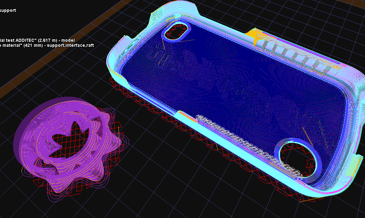

Hi Jonathan
Thanks for this new version.
  • Is it possible to keep the diameter of the Prime pillar independent of the "Inflate Raft & Prime Gap" value?
  • Destring / prime : Could we keep distinct Prime & Suck (speed/length)?
  • the grid do not cover all the surface of the object (hole in object = hole in grid see picture)...can we have an option to allow the grid to cover all the XY area of the part without "Inflate Support" or "Inflate Raft and Prime Gap" ?
Regards
Olivier
