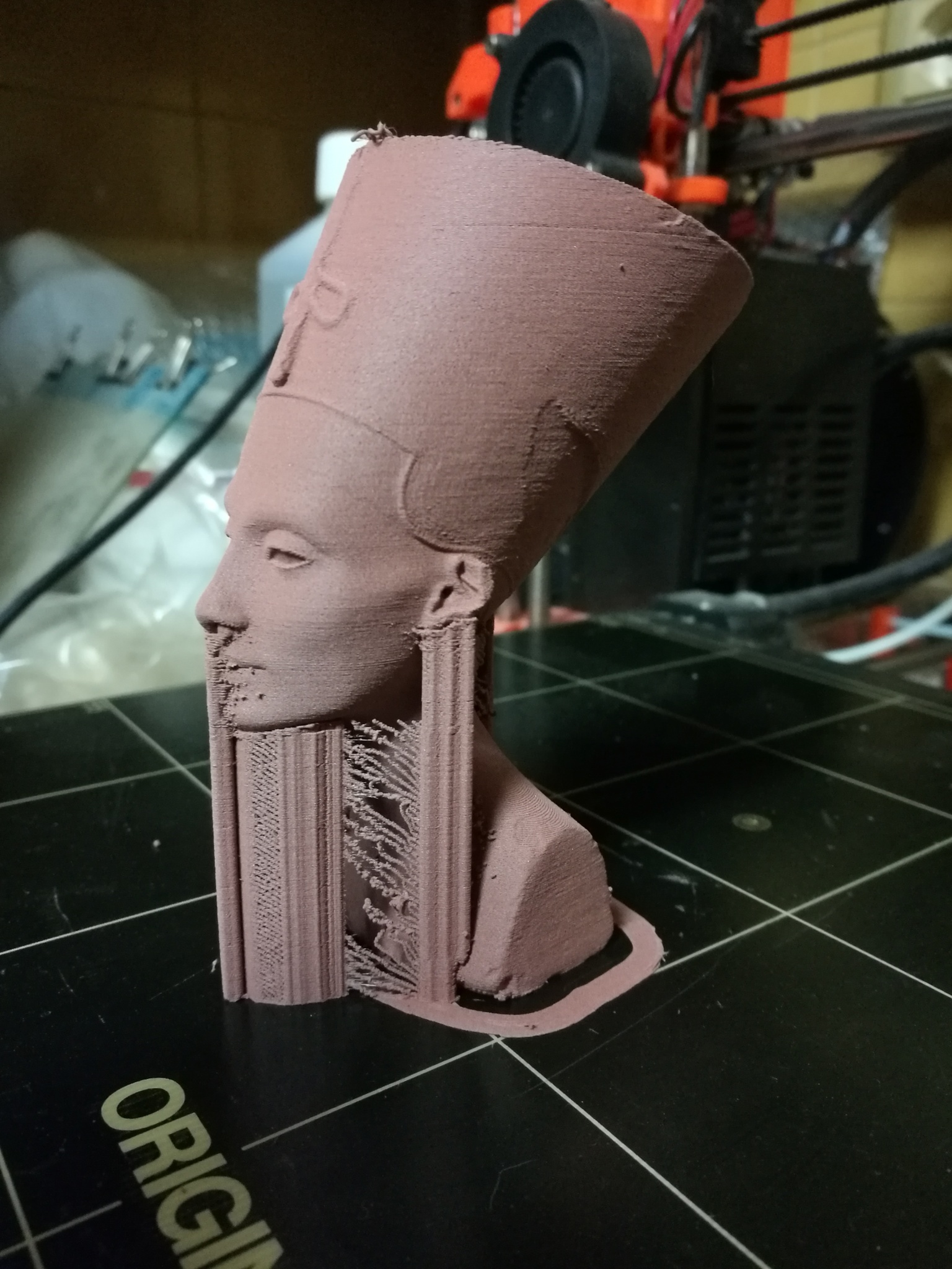

I just printed a 20mm test cube; some have printed OK, but as soon as I try the actual model I really want to print, I get a fail.voyt wrote:In my case the hotend gets clogged right at the start. I can workaround this by starting with plain PLA, then changing to ALU/PLA at +- 2nd layer. Then it prints well till about last 20 layers, when the printer slows down a bit and it cloggs again.. (Later I will upload photos and project files). The model for tests is this one: https://www.thingiverse.com/thing:33974
Again: with 1.5 I can print dozens of these with this material - without even single sign of any problems...
My printer has an E3D V6 hot end. Will try on my other printer, bu being the same, I expect the same result...
Update: Switch to my second printer (older and in need of service - bearings etc), a test cube printed fine (1.6) and now one third of the way through the Nefertiti model without issue.

I am running 2x Prusa i3 "originals" both with MMU (Bowden, 535mm), both with E3D V6 originals hot ends, but modified heat breaks. I even swapped out the heat break for a standard one on the printer having blockages.voyt wrote:WOW! I also have E3D V6 class printhead (with PTFE tubing passing through radiator and the upper/wider, threaded part of heatbreak). Extruder is the direct type (103 mm from the nozzle tip).
Measurement determined that the blockages were occurring just above the bottom of the heat sink, where the heat break can have a step caused from imprecise drilling from both ends of the 2 mm hole.The modified heat break has a 2.1mm hole from the top end, which leaves a small step when reducing to 2mm (lower end); the heat creep was causing fluid filament to pass up to the step, solidify and prevent feeding.
If your heat break has that step, then it's most likely the cause. It is possible to (very carefully) effectively burnish the step out with the flutes of a 1.8mm drill bit.
However, I am currently printing with PreloadVE at 0.1 (velocity 10) and Destring at 0, min flow at 1.5mm^3, wipe 0, Z-lift 0.1, fan 0.6mm 40%/40%/100%, temp 205 (first) then 200, bed 55.
