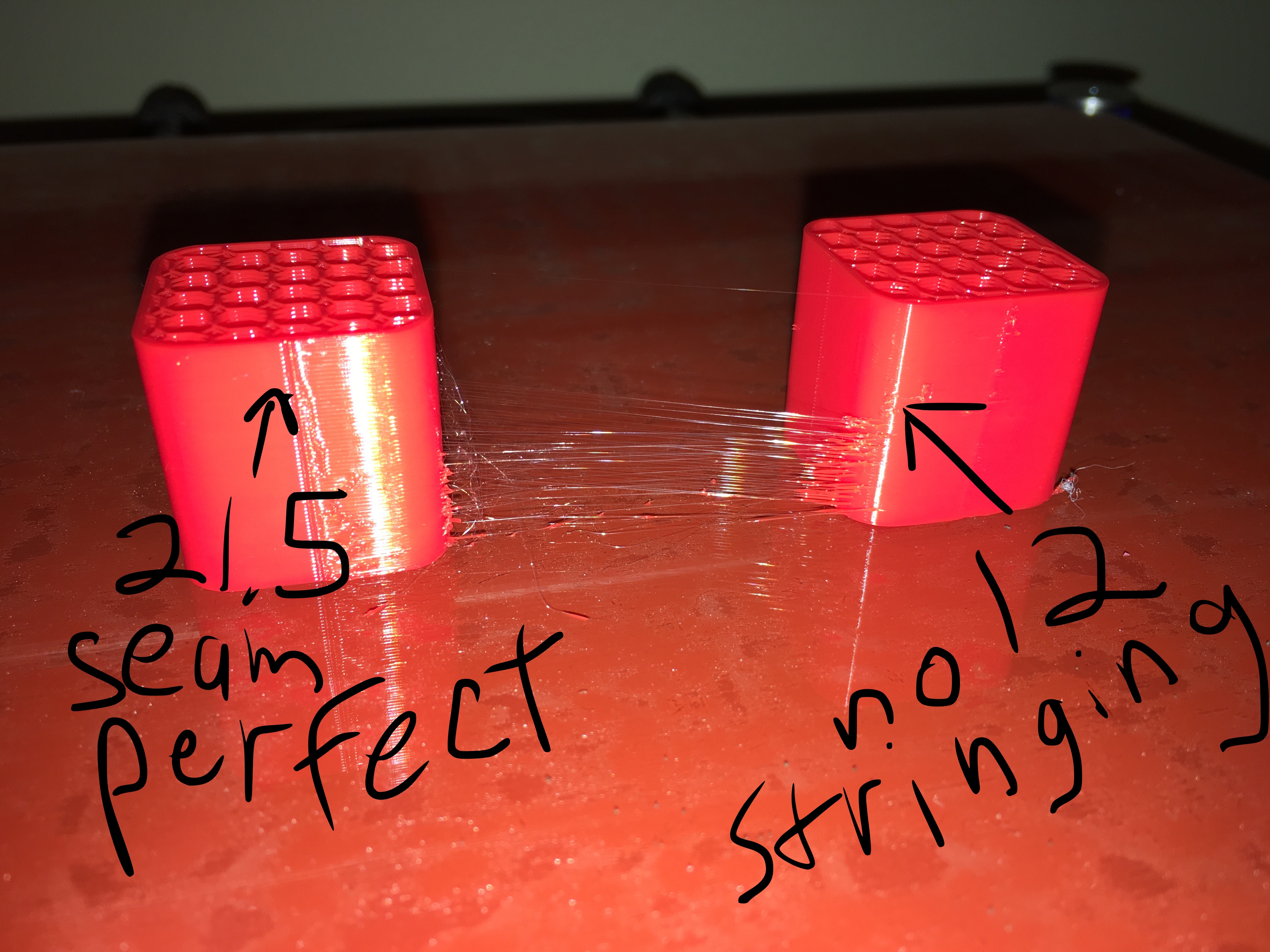

Thanks for mentioning how you use your PreloadVE model (middle of page: viewtopic.php?f=6&t=1903&start=70). Just wondering if there are other models you use for the other wizards or if they all use the same one?
Interestingly, I thought matterhackers method of two cubes (both 25mm) spaced 40mm apart and checking for stringing would be the best way to use your Destring Wizard. What I found is checking the seam was more important than checking for stringing. Here's a pic to illustrate
Destring Wizard: The seam is good at 21.5 mm, but the stringing stopped at 12 mm. I printed (all 4 speed variables) at 10 mm/sec:
