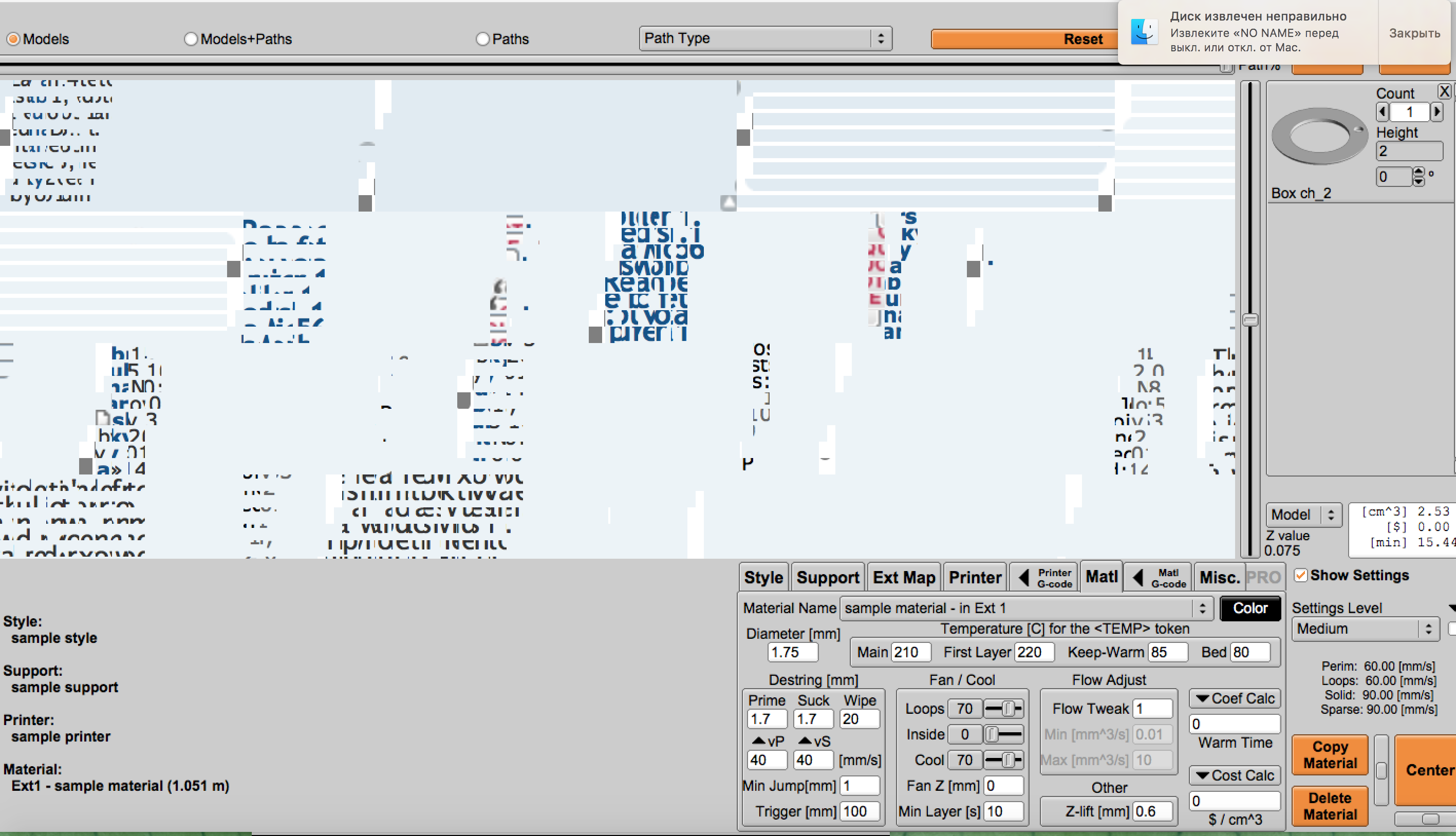

Kisslicer 1.5 RC2 bug when i tapped slice Show Image> Please help
Bug Kisslicer 1.5 RC2 Mac os Capitan 10.11.5

I am also on El Capitain .5. I haven't seen this happen in KSrc2. However I have seen similar video garbage in previous versions. I believe this is a bug that hasn't been solved yet. perhaps try restarting. for me it eventually went away.
Re: Bug Kisslicer 1.5 RC2 Mac os Capitan 10.11.5
I'm pretty sure it has to do with how FLTK (the cross-platform "widget" library I used in KISSlicer) handles OpenGL windows on Mac. I just saw that the upcoming FLTK release (1.3.4) better supports El Capitan, but they aren't ready for a release. I'm not very comfortable releasing a version of KISSlicer that uses an unstable build of a library. However I will compile what they have now, build a test version for you guys, and we can see how/if it works. It will probably take a few days to get up and running, though.
In the mean time if anyone can find a consistent workaround for this problem I would love to hear it.

Nice music. LOLixotdog wrote:video https://youtu.be/YqkaQd4C5gk
I can not get the video bug to happen. does anyone know of a way to make it occur? It will be hard to test a fix if we can't replicated it.

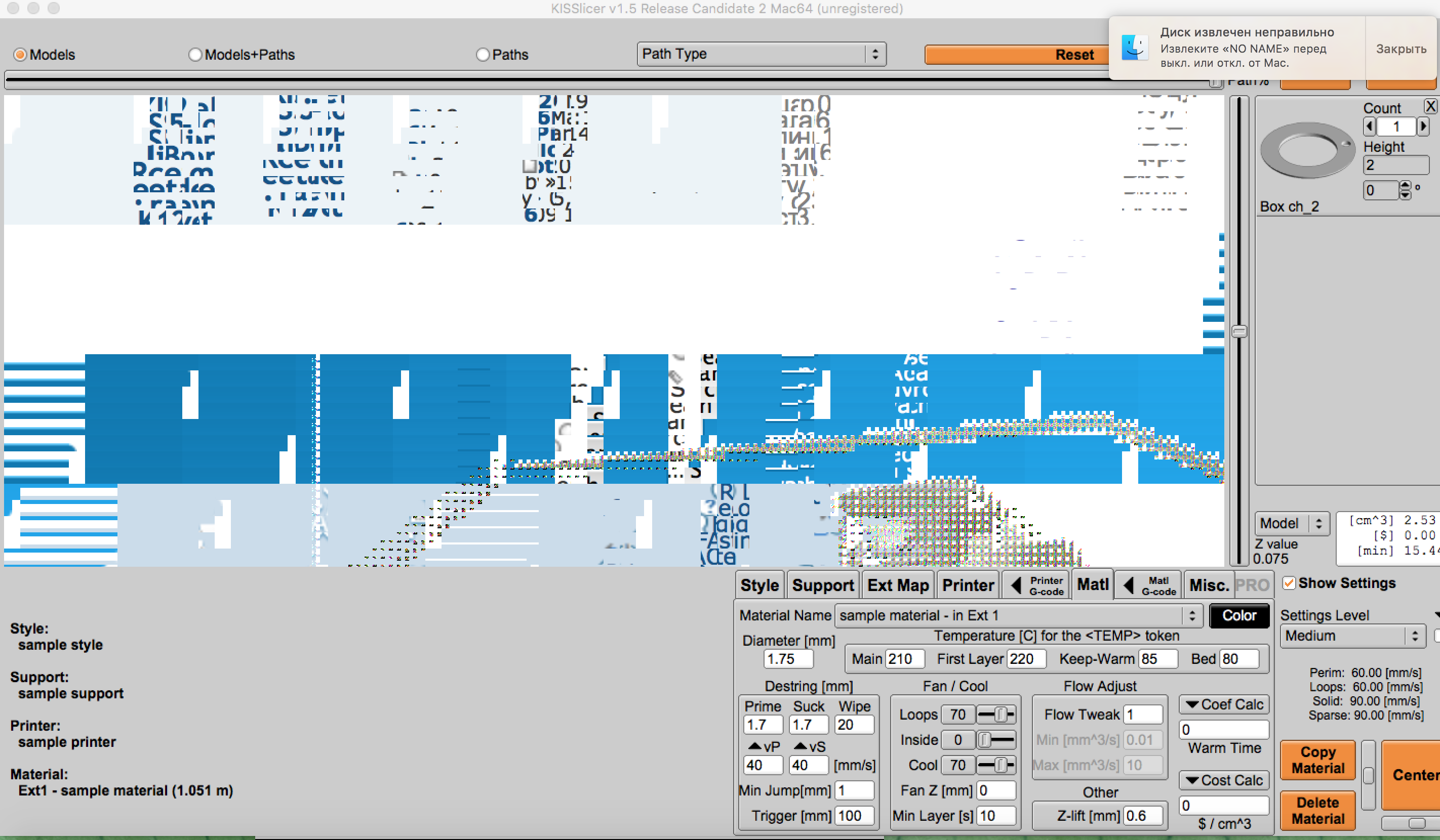

Does the 3D display work again after the export, or does it stay broken?
it stay broken. only after restart program 3D display work

Do you see the same behavior on 1.5 RC1? (And if so, could you please work backward through the versions and find where the bug started?)
yes! on rc1 bug repeat too

I would like to get rid of those two pop-up messages and try again. (I don't really think this will fix the problem, but it might be worth trying.) In the [< Printer G-code] settings tab, please copy the text from the tab [Select New Ext & Warm] and copy it to the empty tab [Warm Same Ext]. Then please copy the text from the tab [Cool & Retire Old Ext] and copy it to the empty tab [Cool Same Ext].
Does that change anything?
