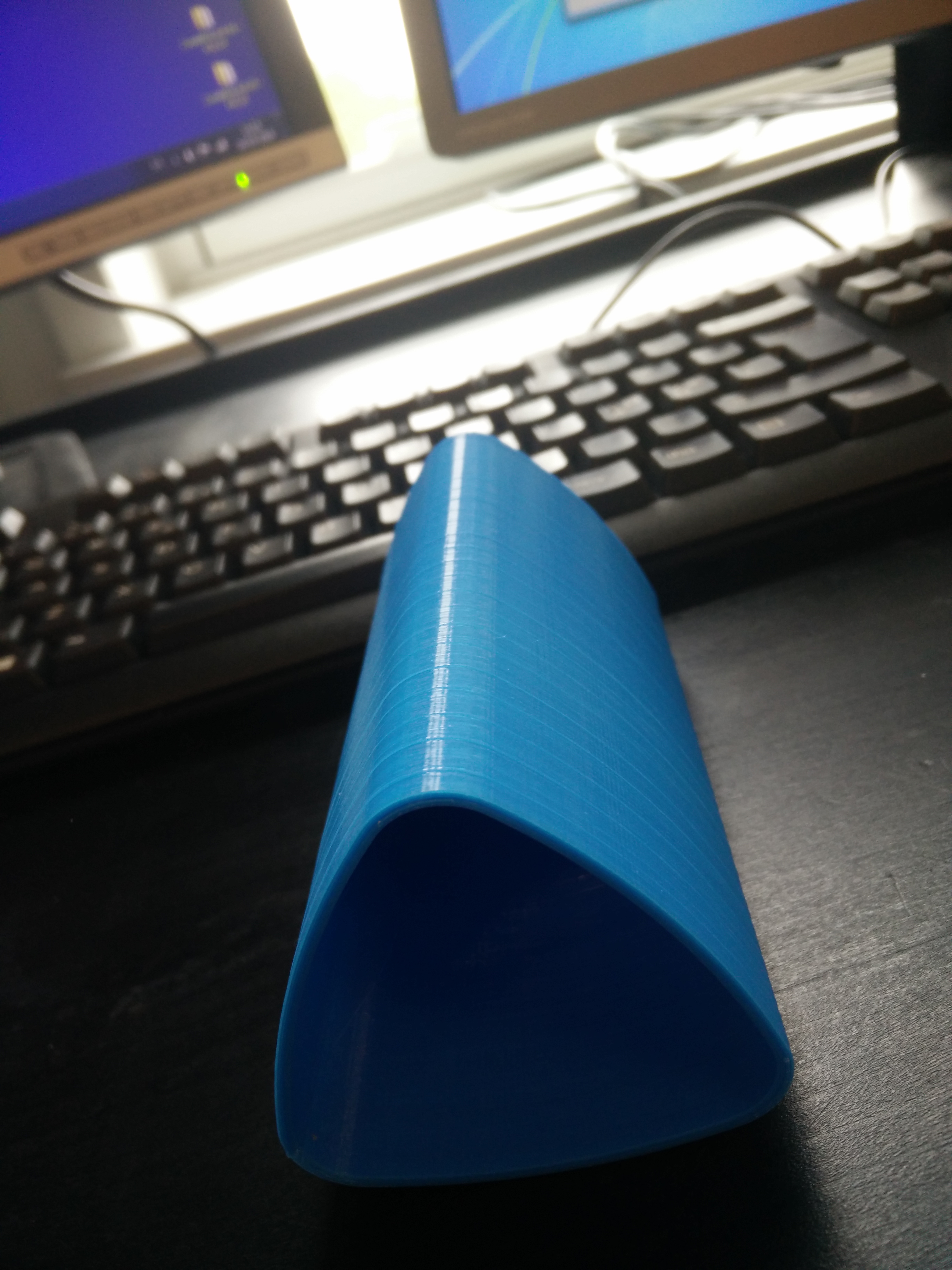

Hey
I have some funny/weird "rings" along my print... Anyone knows whats wrong?
gastonfama
Posts: 45
Joined: 29 Sep 2015, 12:21
Re: Weird rings on the print
Post by gastonfama »
I am not completely sure but it could be some kind of failing the exact same position as the layer before.
Some bad tension on the belts?
Too fast maybe and the inertia is playing you a bad time?
Perhaps the more experienced members have a more accurate answer.

Speed sounds reasonable, since I did print with 40mm/s on my cubex

What cubex is it? 1 2 o 3 extruders?
rantzaus
Posts: 105
Joined: 14 Dec 2015, 04:14
Post by rantzaus »
Its a duo, with two extruders.
gastonfama
Posts: 45
MMMMMM, that is not too much aparently
Giovani sayd in other post
I've a Duo and 50 is OK, if you have a Trio you probably need to go to 40-45 to be safe and if you have a single extruder you probably can push the speed up to 55-60.
I Have a Trio and my speed limit is 50, but the speeds used are:
  • Perim: 30
  • Loops: 35
  • Solid and Sparse: 54
rantzaus wrote:Hey
check belt tension, put some grease on the guide bars X, Y, Z and also on the trapezoidal thread of the z axis.
Use a layer thickness of 0.18 or 0.21, use only multiples of 0.03.
Try and let us know.

Are you printing on a heated bed? You may be getting bed flex from the temperature swing on the bed.
