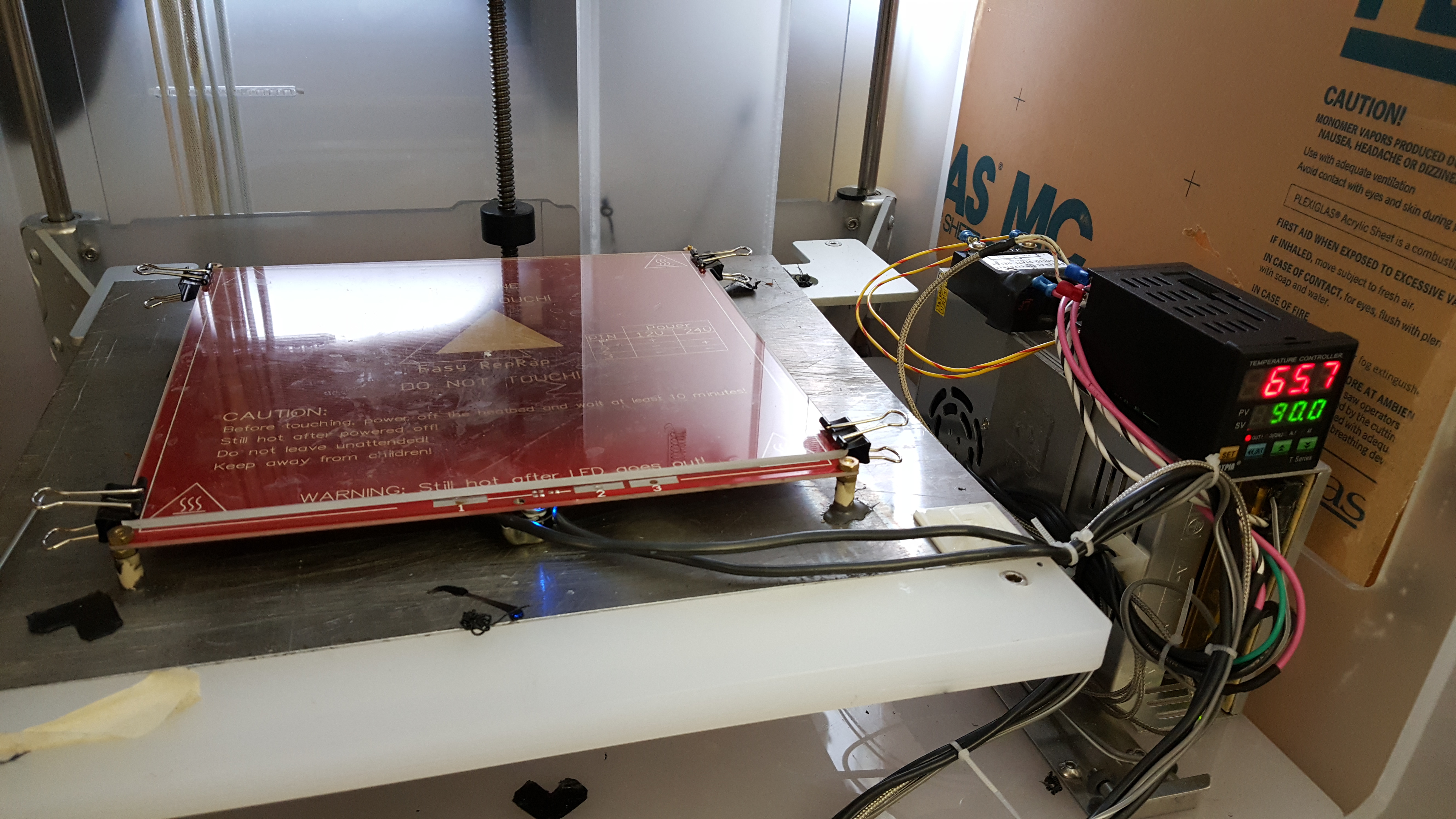

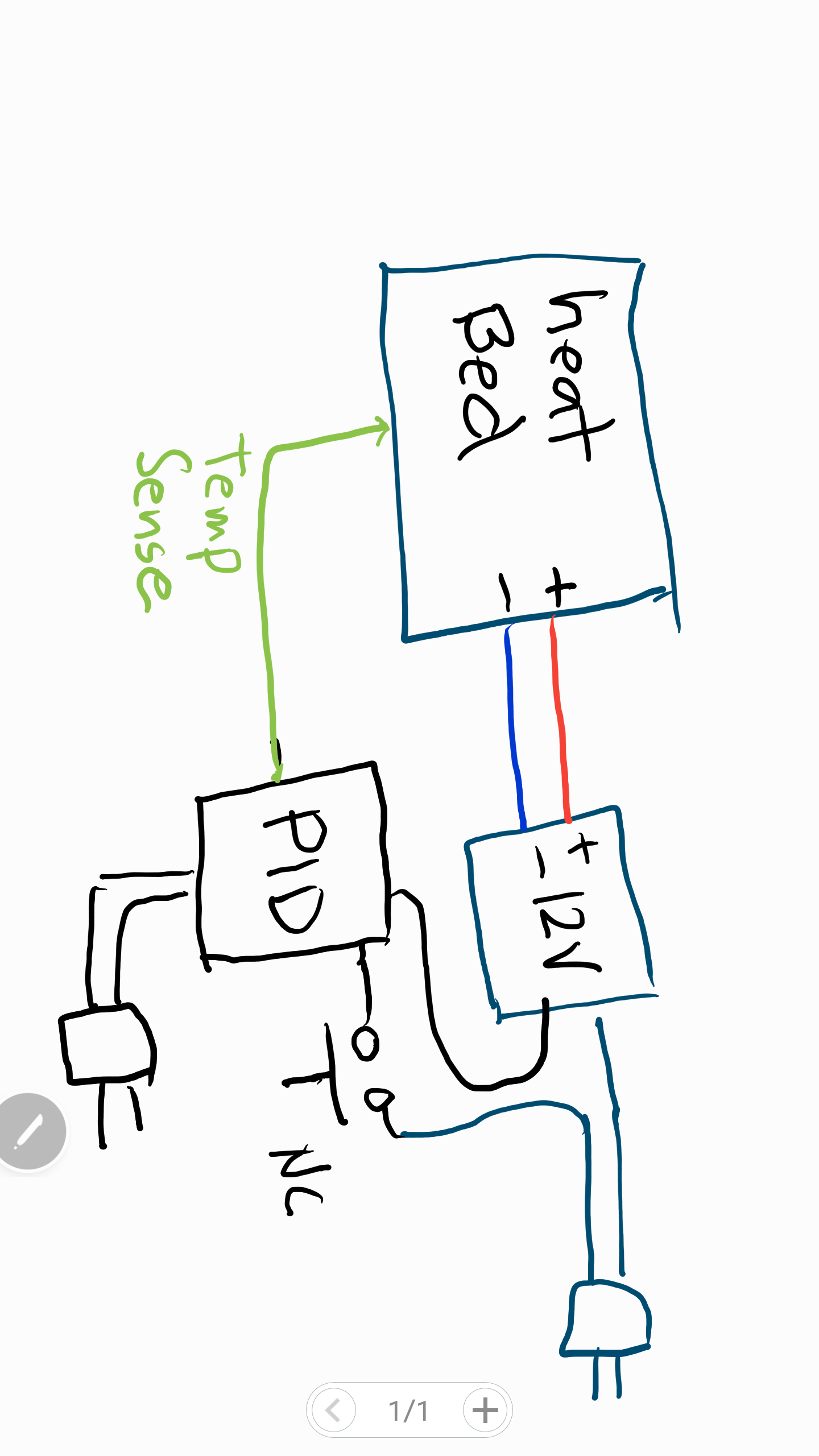

I roughly upgrade my Cubex DUO with a heat bed. I say roughly because it is half done, it works but does not look nice well i am still experimenting with it. Here's my rough schematic how it looks like. Yes now I can print ABS with less problem with warping, down fall of this heat bed upgrade for me is I have lost bed capacity.

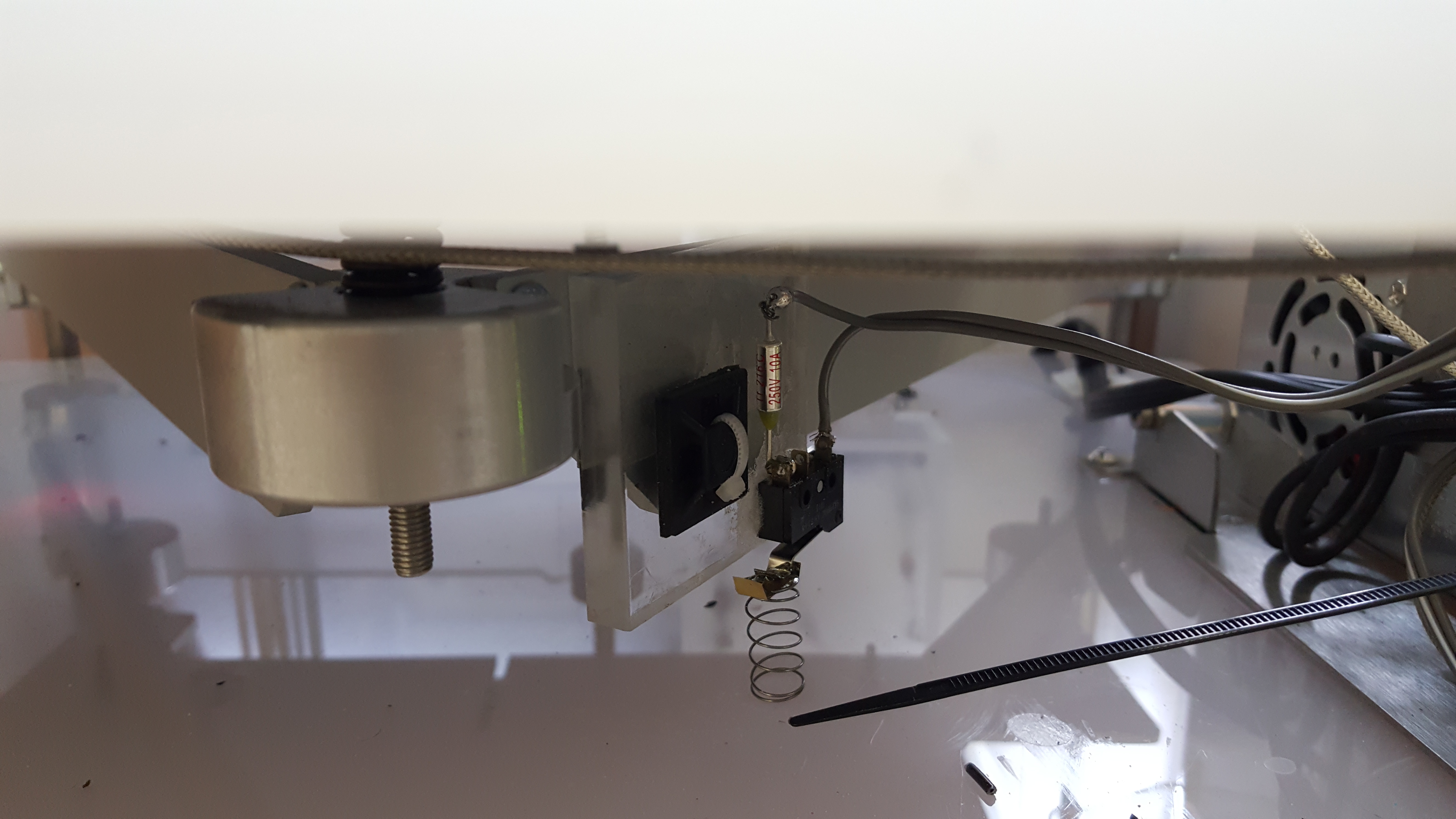

I also have a normally closed switch that will open the circuit when printing is done to cool off the bed. I just placed it under the bed since the bed usually goes all the way down when done printing. The problem with this is that the bed will only go down when it finish printing but not when an error like for example filament failure and therefor the heat bed won't turn off. For now I am not doing any un attended printing with my set up.
If you look at the photo you will see how it was implemented and I know the thermal fused I put is a little or no help at all, I should attache it to the bed it self and will on my next revision.

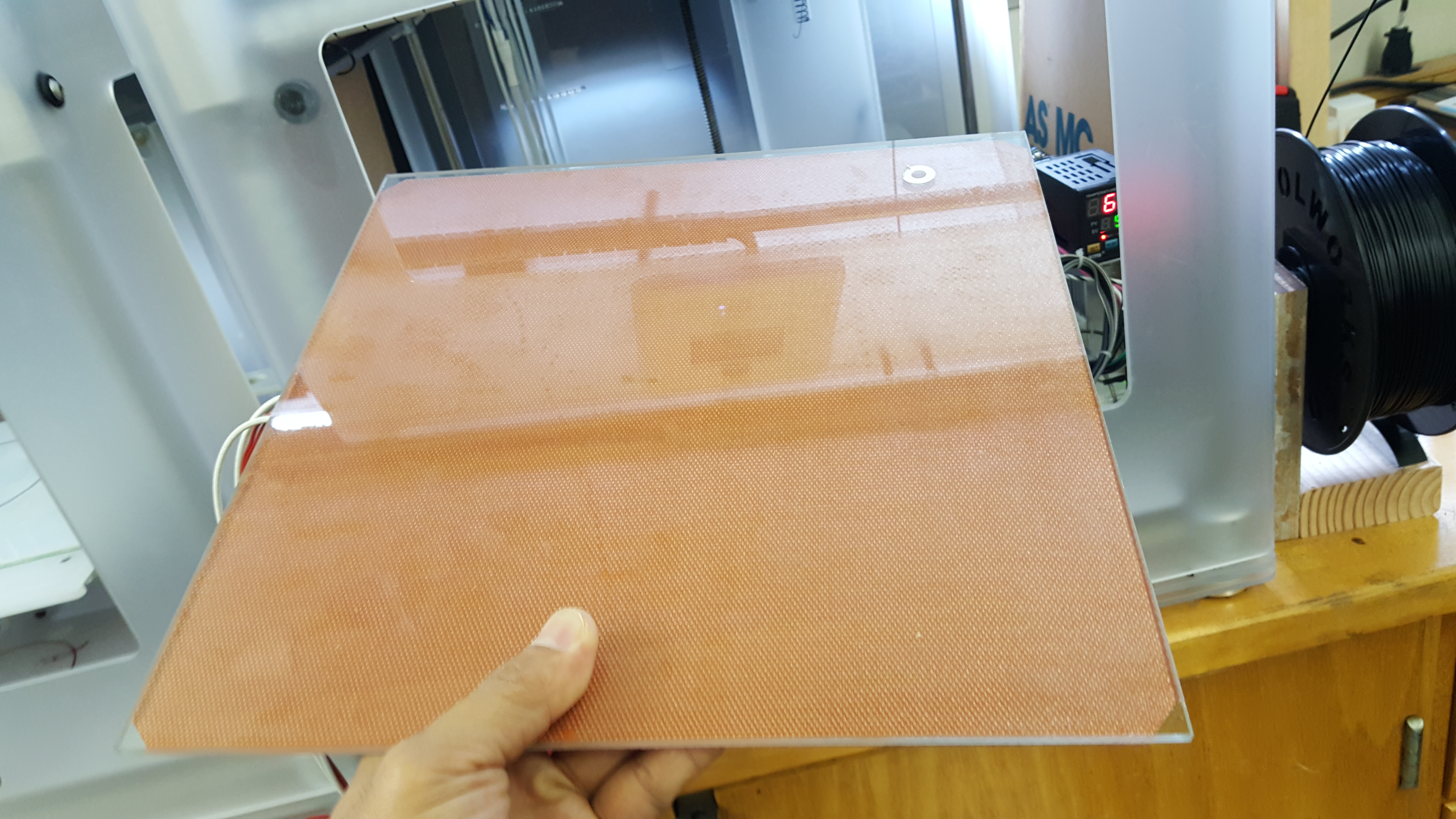

You say you lossed bed capacity. As I know, its possible to to get a headbed that measures 300x300. That size should give you lot of bed capacity.jaydie wrote:I roughly upgrade my Cubex DUO with a heat bed. I say roughly because it is half done, it works but does not look nice well i am still experimenting with it. Here's my rough schematic how it looks like. Yes now I can print ABS with less problem with warping, down fall of this heat bed upgrade for me is I have lost bed capacity.
- Posts: 25
- Joined: 24 Mar 2016, 15:24
Re: HeatBed for CubeX
Yes there are bigger heat bed, to save money I planned to make one so I just bought the heating pad then cut a piece of glass. I will install this when I find time.
