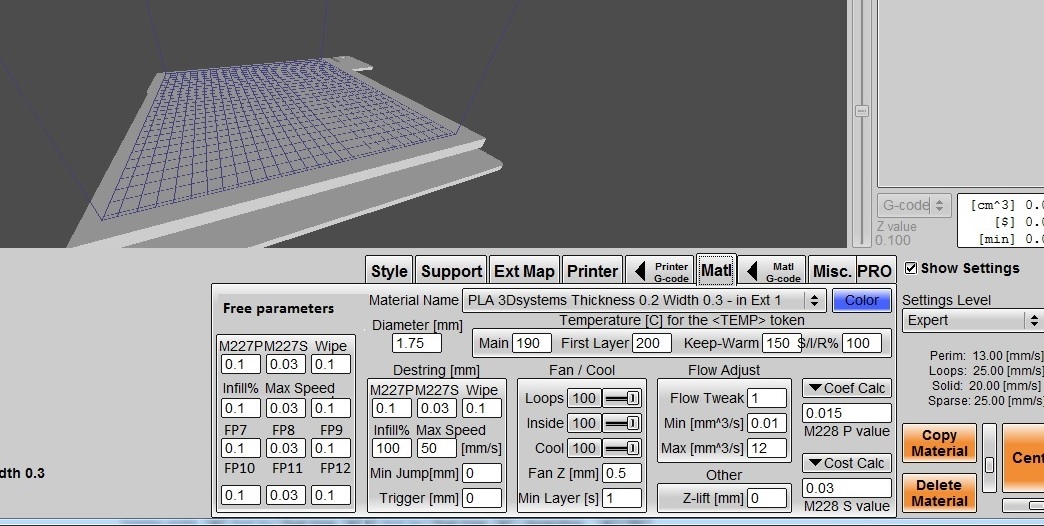

A post-processor like Cubeitmod requires a lot of parameters, at the beginning I've "hijacked" some unused KS parameters but with the last version of Cubeitmod I had introduce more parameters and I had to write them into the G-Code tab.
It would be much more better to have some free parameters ( specially on the material tab, because the parameters are mostly related to material/extruder ).
More free parameters for post-processing

I've put version 1.5 on feature freeze so I can actually finally release it, BUT this feature is already on the list for version 2.0. It will have user-settable token text as well as the value (so <RANDOM_TOKEN>="some value"). I don't think I understand all the ways it might be used, though, so I definitely appreciate your feedback!

I would like to have something like this in every tab ( Style, Support, ....) this way the parameters are automatically saved by KS and using the .po language file I can put the text I want : Thankslonesock wrote:I've put version 1.5 on feature freeze so I can actually finally release it, BUT this feature is already on the list for version 2.0. It will have user-settable token text as well as the value (so <RANDOM_TOKEN>="some value"). I don't think I understand all the ways it might be used, though, so I definitely appreciate your feedback!
