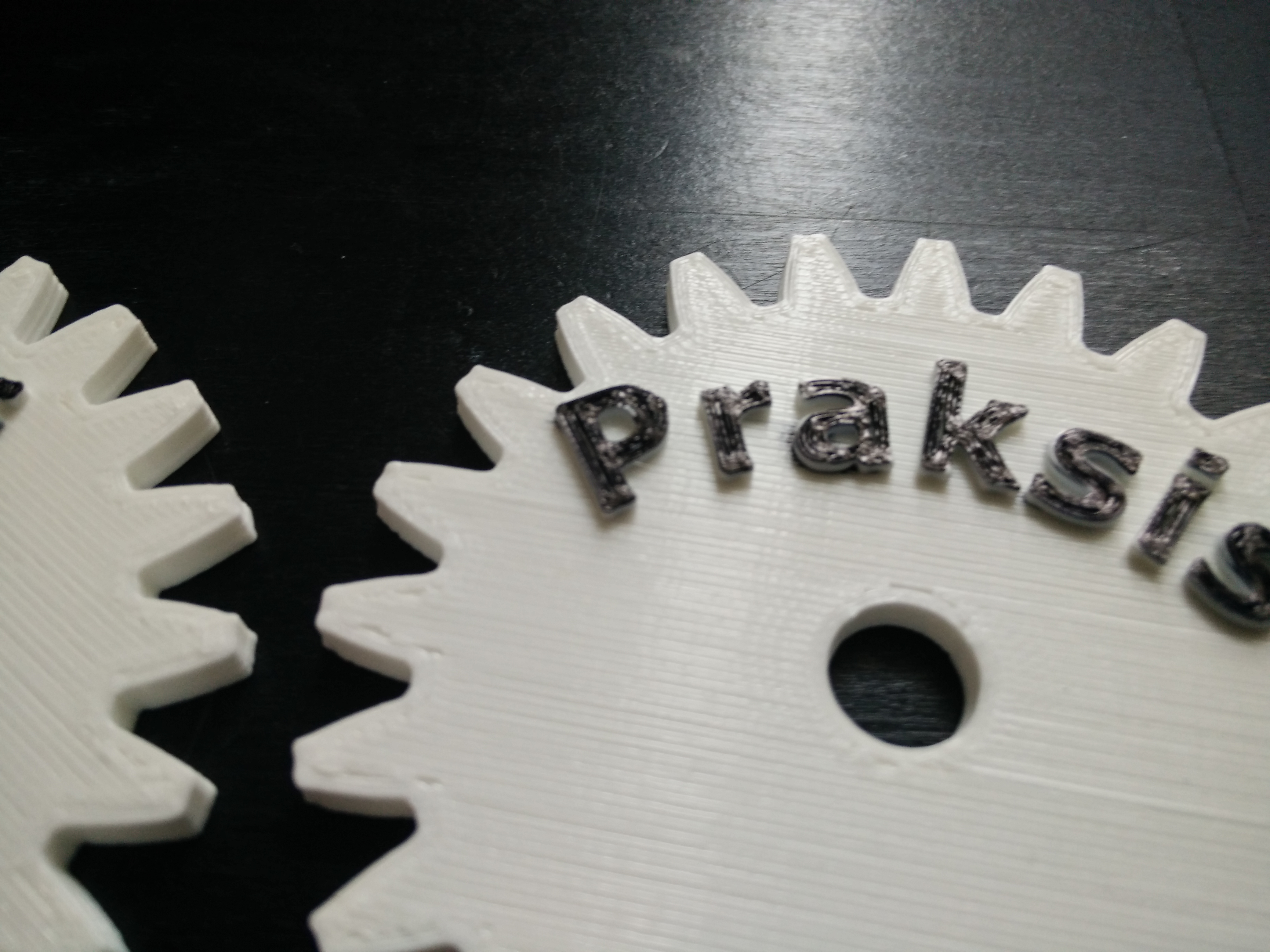

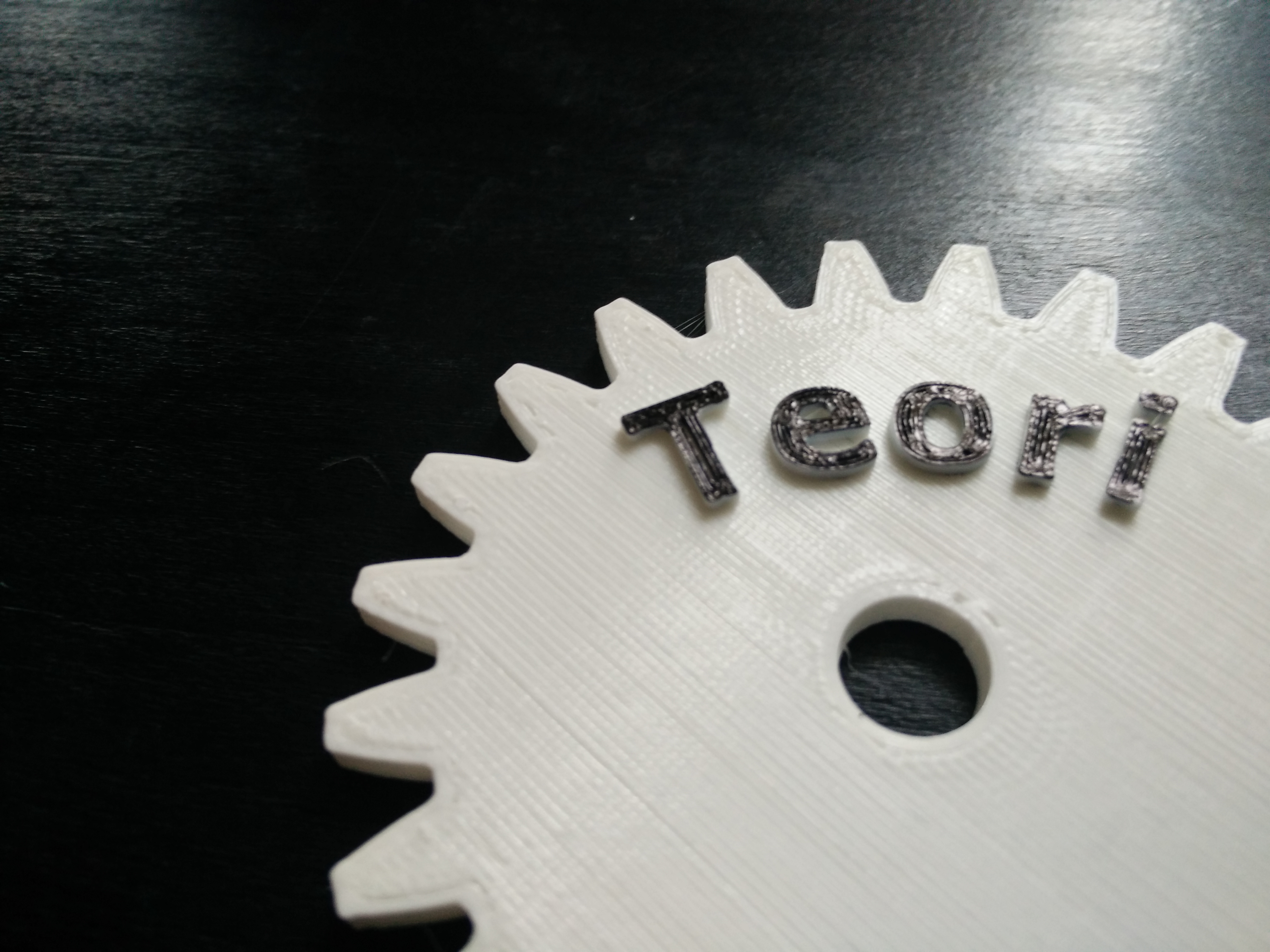

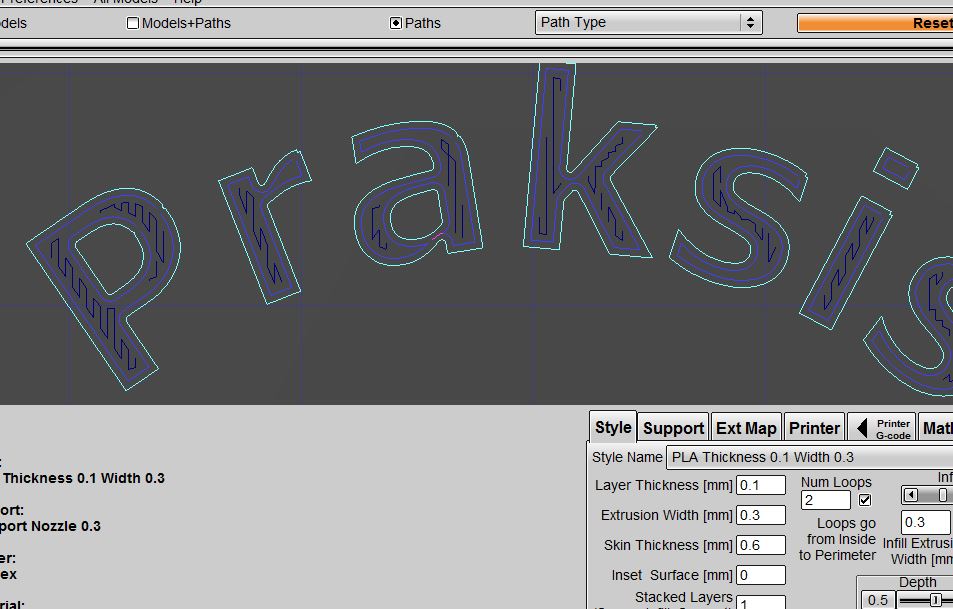

have printet 2 gears with text in them.. See picture
But the text is very poorly printet, Its like it did not fill the geometry... I have tried to take som pictures.
I have included my ini files, bfb, bak and STL files. Hoping someone can explain why its printet that way..
bfb, bak, stl.zip
(1.04 MiB) Downloaded 270 times
ini files.zip
(2.17 KiB) Downloaded 265 times

Hi Again

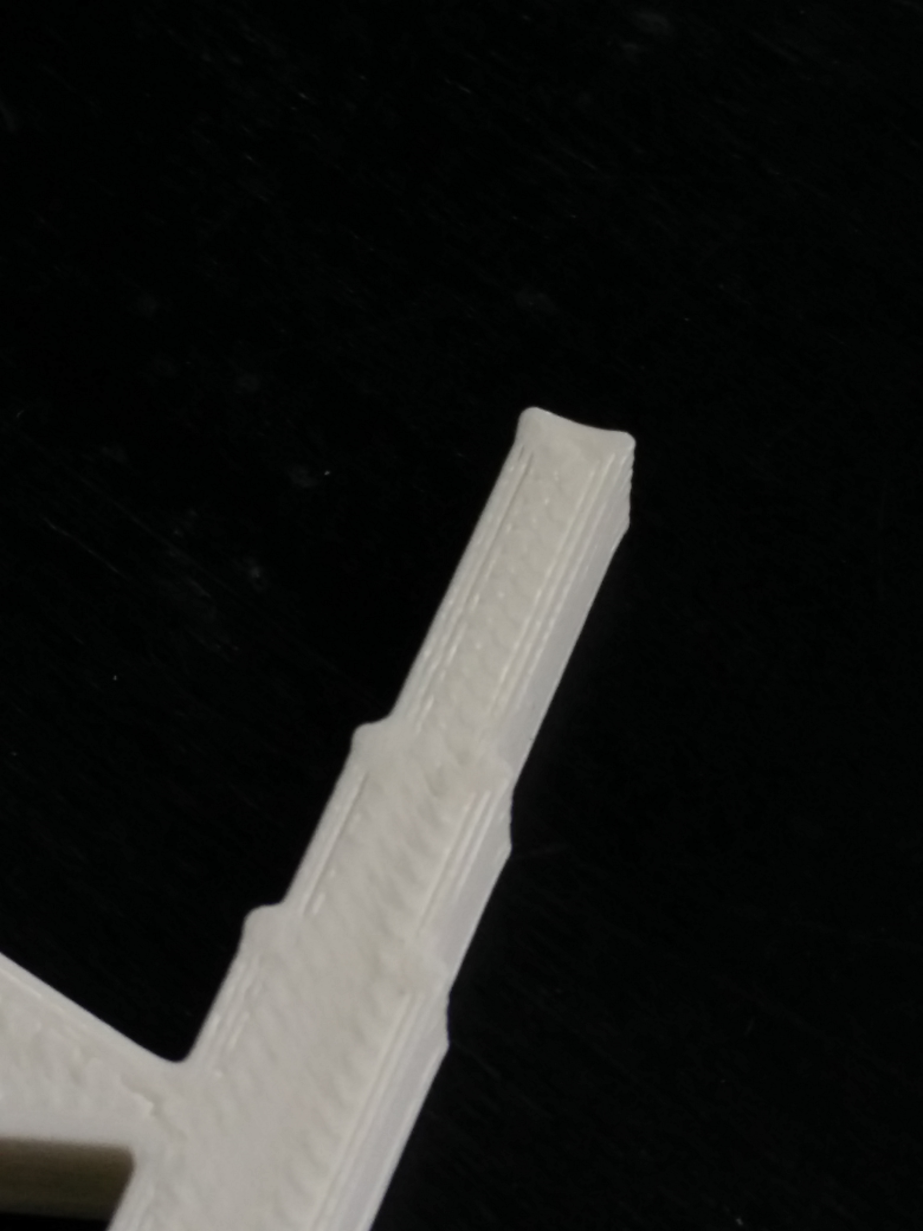

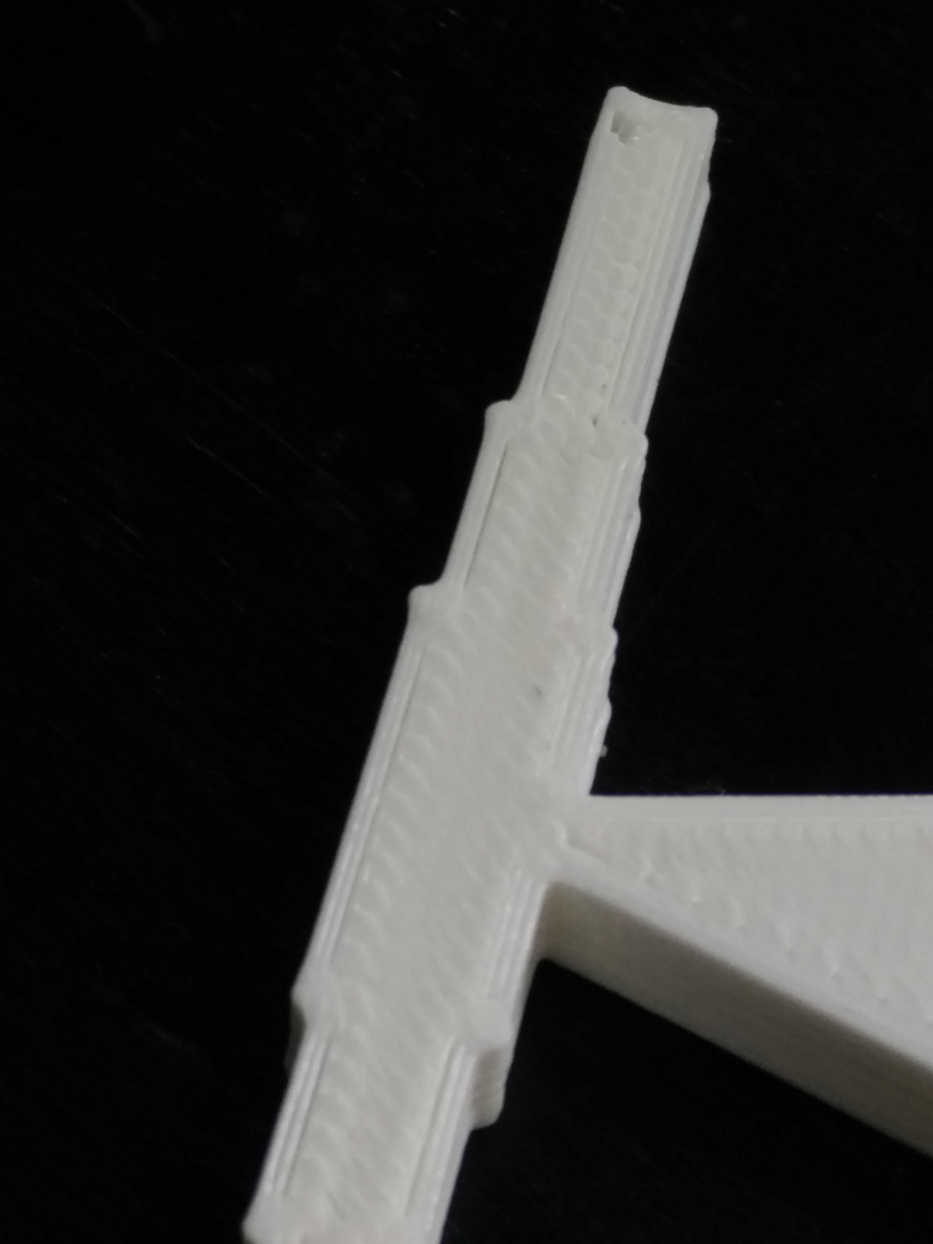

Im experiencing the same problem with my perimeter loops. I have taken some pictures.
I have tried to modify the ShortSolid% without any improvements.
Any Ideas?

ShortSolid% affects only the SOLID path and for lengths smaller than SolidPivotLength

rantzaus wrote:have printet 2 gears with text in them.. See picture

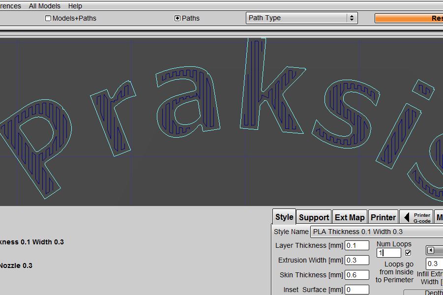

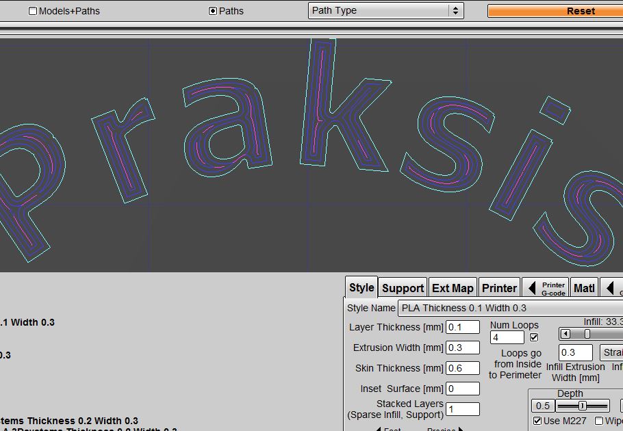

Print letters is a real challenge for the slicer, use KS 1.5 Beta 2.20 because it has better crowning than 2.22, then change the number of loops until you find the best path.
1 Loop and 4 loops look better than 2 loops.
You also have a very low loop/solid infill overlap.

Sorry for the dump question, but where do I change the loop/infill overlap?
Printer/hardware tab

Do you have a good idea for a better number?
