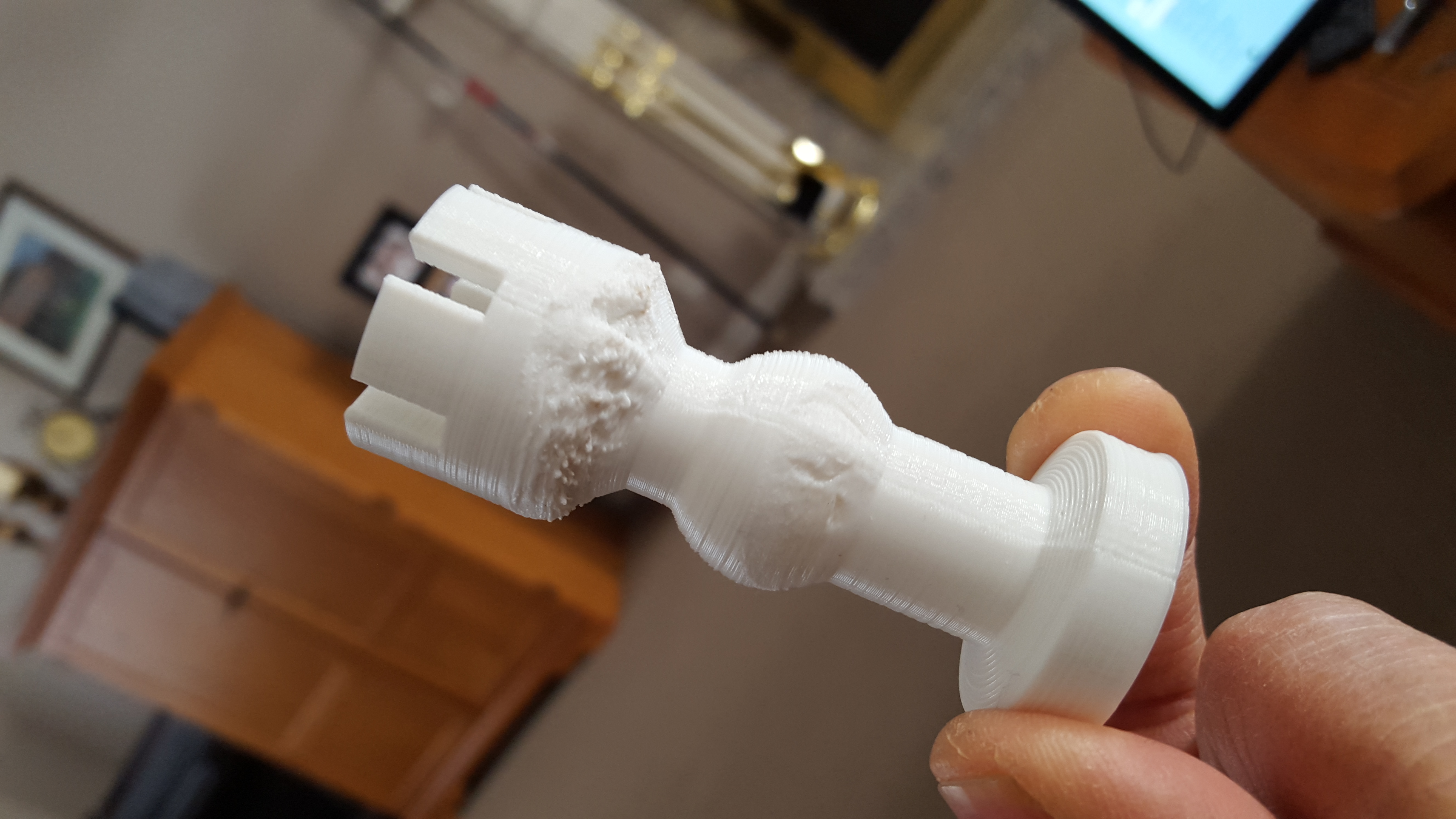

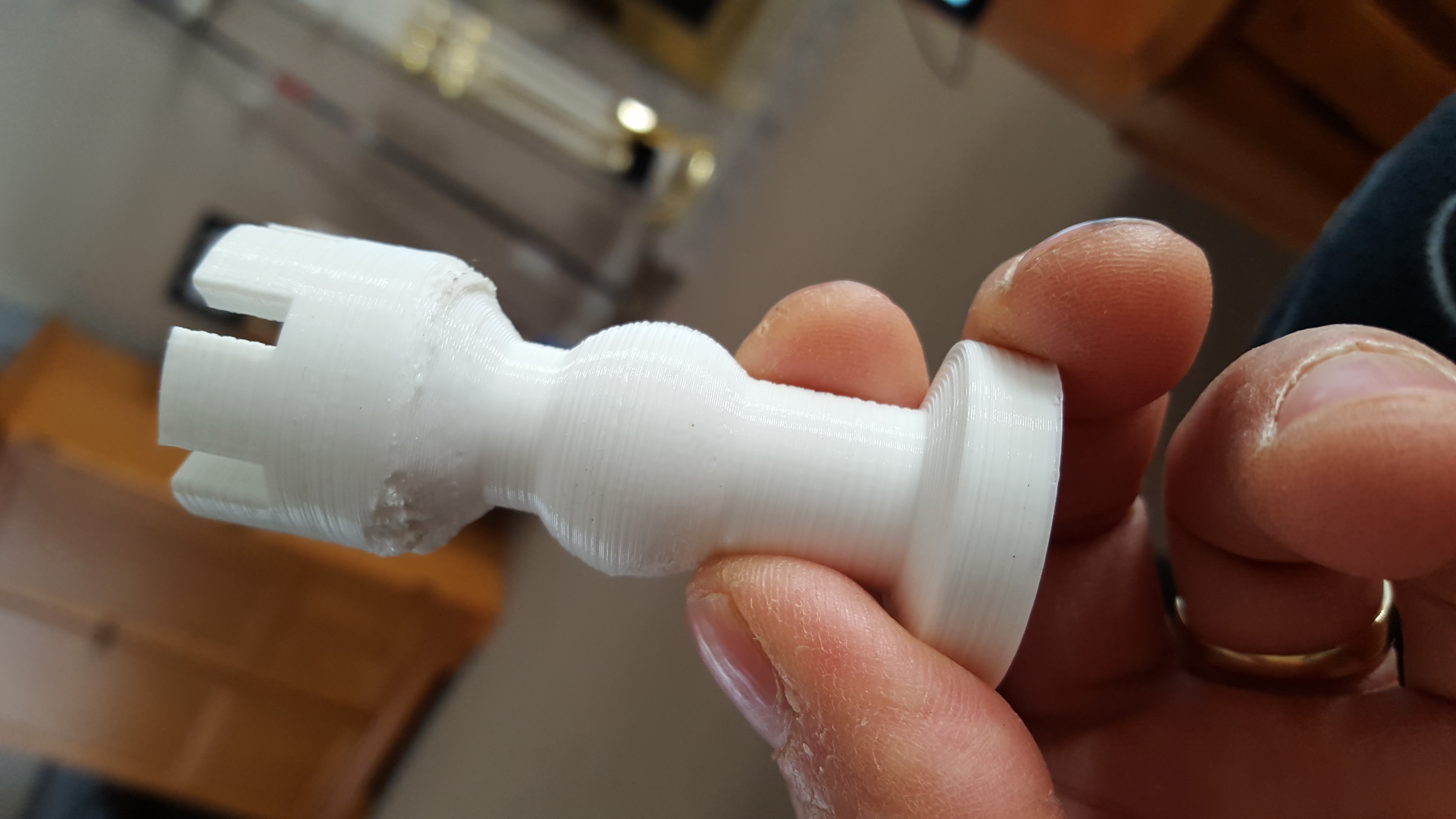

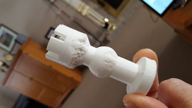

Any Ideas??? Bad seam?
- Posts: 57
- Joined: 14 Nov 2014, 17:53
I printed this with the attached settings. One side came printed ok and the seam side did not. Any ideas? Material PLA Cubex thickness .2
- ini files.zip
- (2.84 KiB) Downloaded 182 times

Re: Any Ideas??? Bad seam?
It's strange, try with a lower temperature if it's better.joestefano wrote:I printed this with the attached settings. One side came printed ok and the seam side did not. Any ideas? Material PLA Cubex thickness .2
Post the stl file too.
Can you try to change this and print again :joestefano wrote:STL file posted
- infill 50%
- remove the the setting "Loops go from inside to perimeter"
- set the main tempereature to 200°C
Another thing but not related to the problem, the flow tweak is very high, did you change the extruder's voltage?
No I didn't increase the voltage. What should the Flow Tweak be? I will try the changes you suggested as soon as I have time.
- Posts: 241
- Joined: 18 Nov 2014, 09:34
Kisslicer and Cubeitmod are calculating the extrusion with a lot of precision, if you measured correctly the filament's diameter the flow tweak should be 1, small variations (tweaks) are possible like 1.01 0.98, but 1.1 means 10% more !!! this is too much.joestefano wrote:No I didn't increase the voltage. What should the Flow Tweak be? I will try the changes you suggested as soon as I have time.
If you need to push the the to flow tweak to 1.1 to have good results there are 2 possibilities :
1- your settings are not good : Filament's diameter, Extrusion width ...
2- the motor on the extruder has not enough torque and looses some steps resulting on a under extrusion that you compensate with the flow tweak. This is a well know problem on the Cubex, the solution is here : With 1.8V and Heat Sink you'll have much more consistent extrusion.
