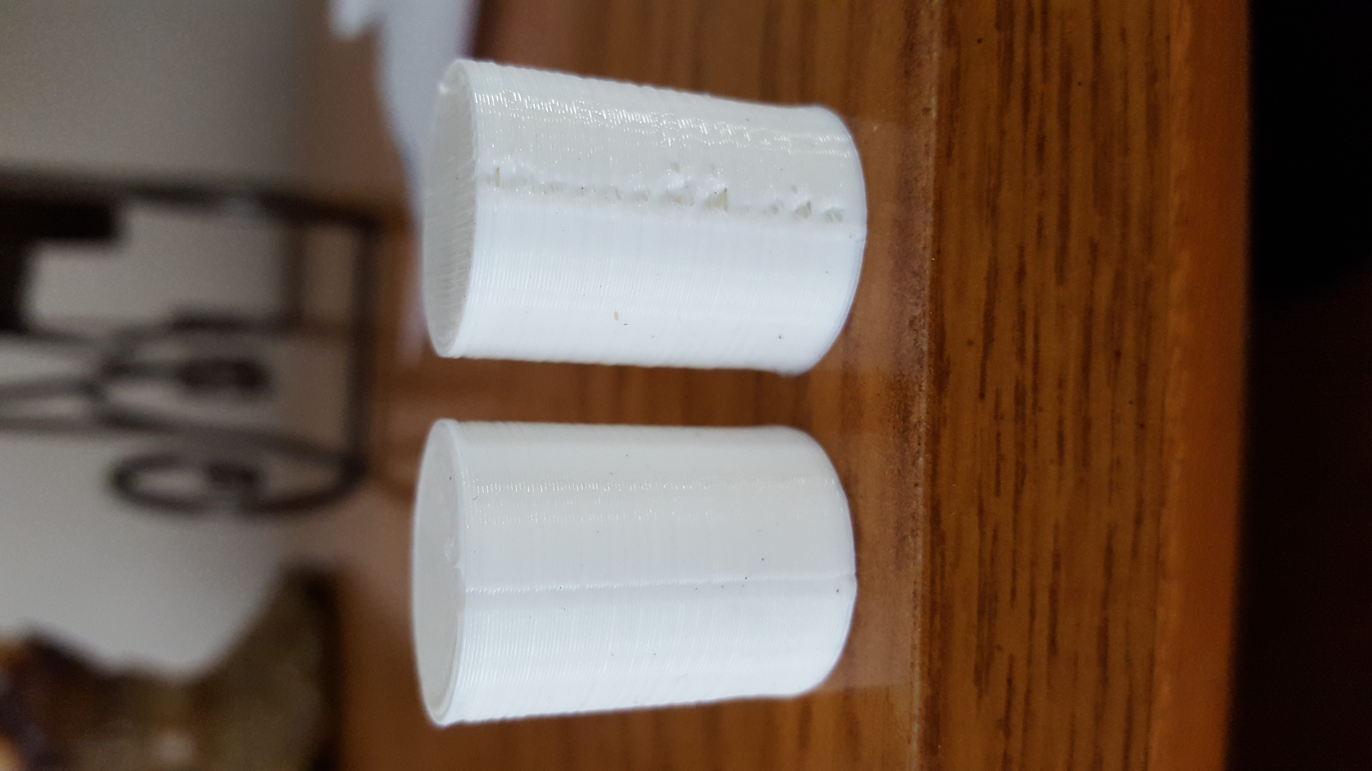

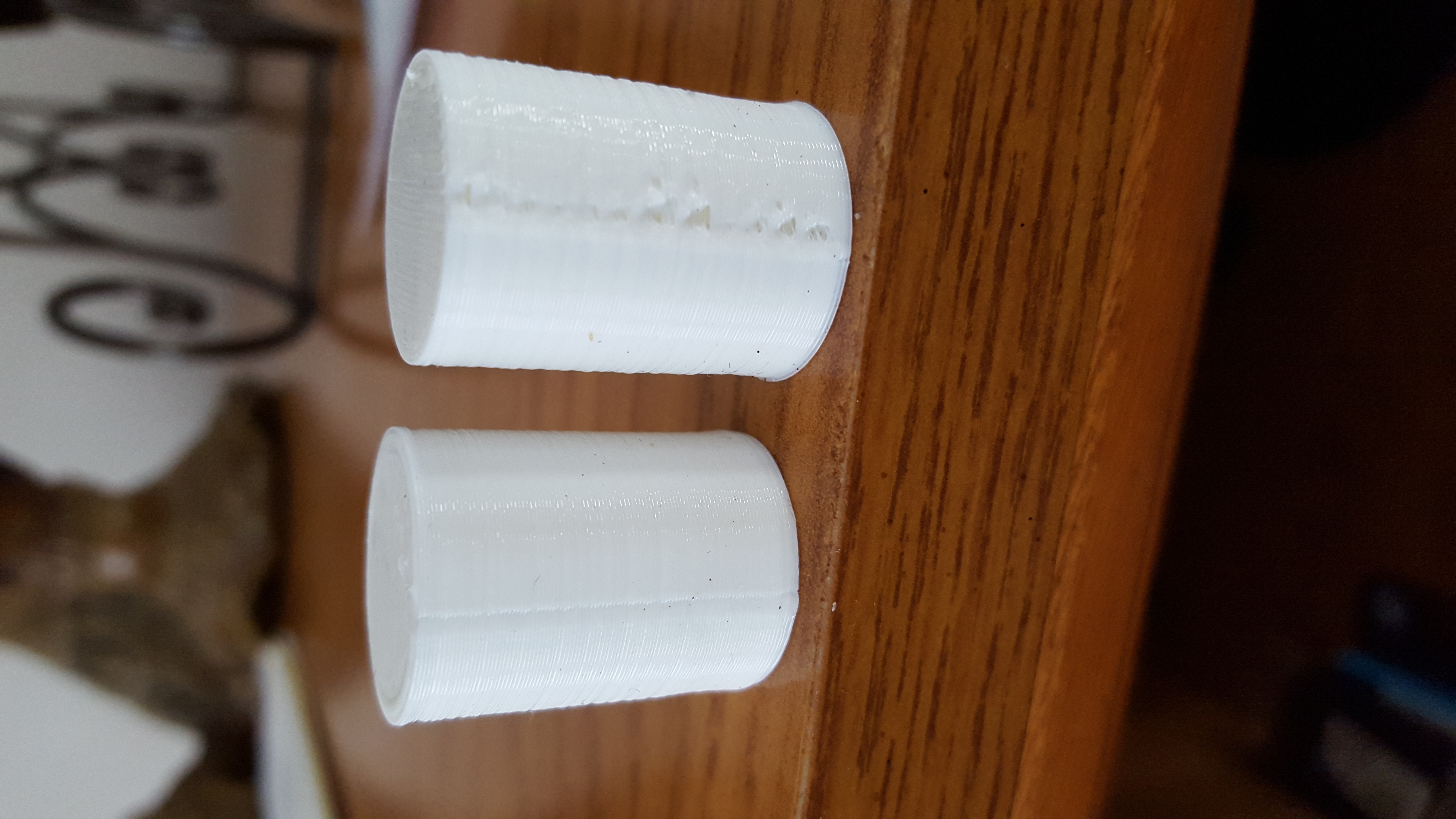

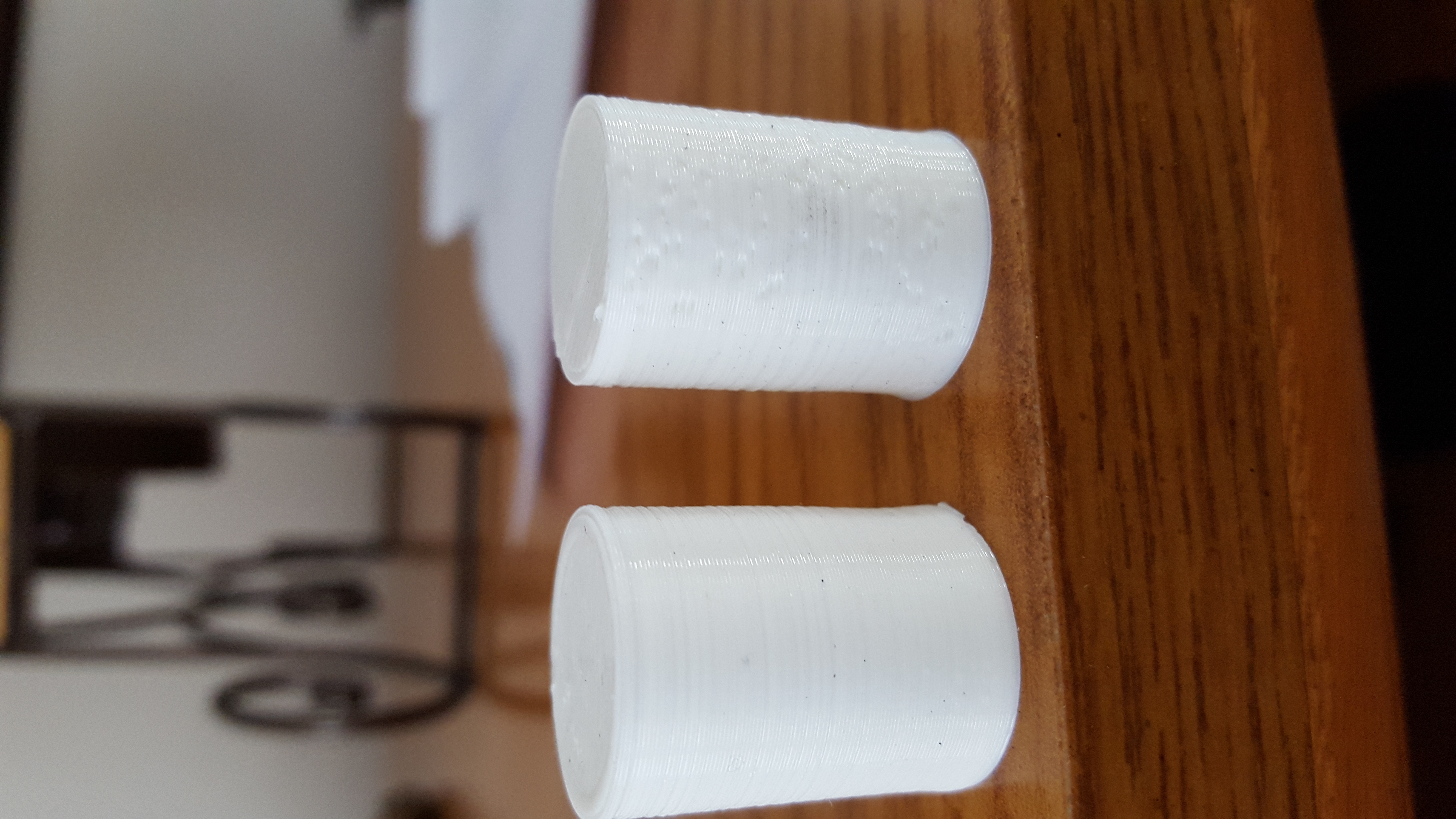

Part on left printed using CubeX, part on right using KS. is there a way of comparing g codes to match speed and flow to get the same results? I have attached the cubex bfb file

This is mainly a problem with M227 M228, to use the same parameters as the Cubex Software put :joestefano wrote:Part on left printed using CubeX, part on right using KS. is there a way of comparing g codes to match speed and flow to get the same results? I have attached the cubex bfb file
M227P 0.09
M227S 0.1
M228P 0
M228S 0.09
