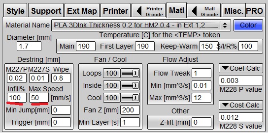

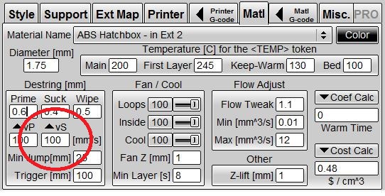

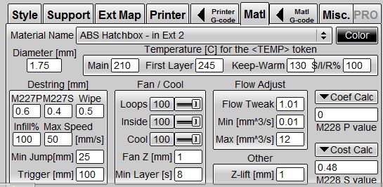

First load the language file CubeitmodV6.po into Kisslicer, this way the menu will look like the one into my previous post.
This setting will be renamed "Max Speed"
For a Cubex Duo I use 50, I've tested with 60 but it's too much for the printer.
Go to the Printer/Speed tab and reduce the speed that are over 40 ( If you've used max speed 50)

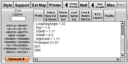

Go to Printer G-Code/Prefix tab and check if it looks like this :
; InterfaceSpeed [mm/s] = 25
; ShortSolid% = 40
; ShortInfill% = 20
; SmallLoopSpeed = 4
; LoopSegLength = 0.4
; LoopSegAngle = 22
; Exp = 1.4
; VShift = 1.11
; HShift = 0.3
; HighLimit = 1.11
^Firmware:V1.07
G21
G90
If you still cant print post here the ini and bak file.

^Firmware:V1.07
; [mm] mode
G21
; absolute mode
G90
That how my G-Code prefix tab look like.
