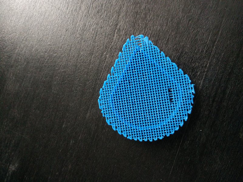

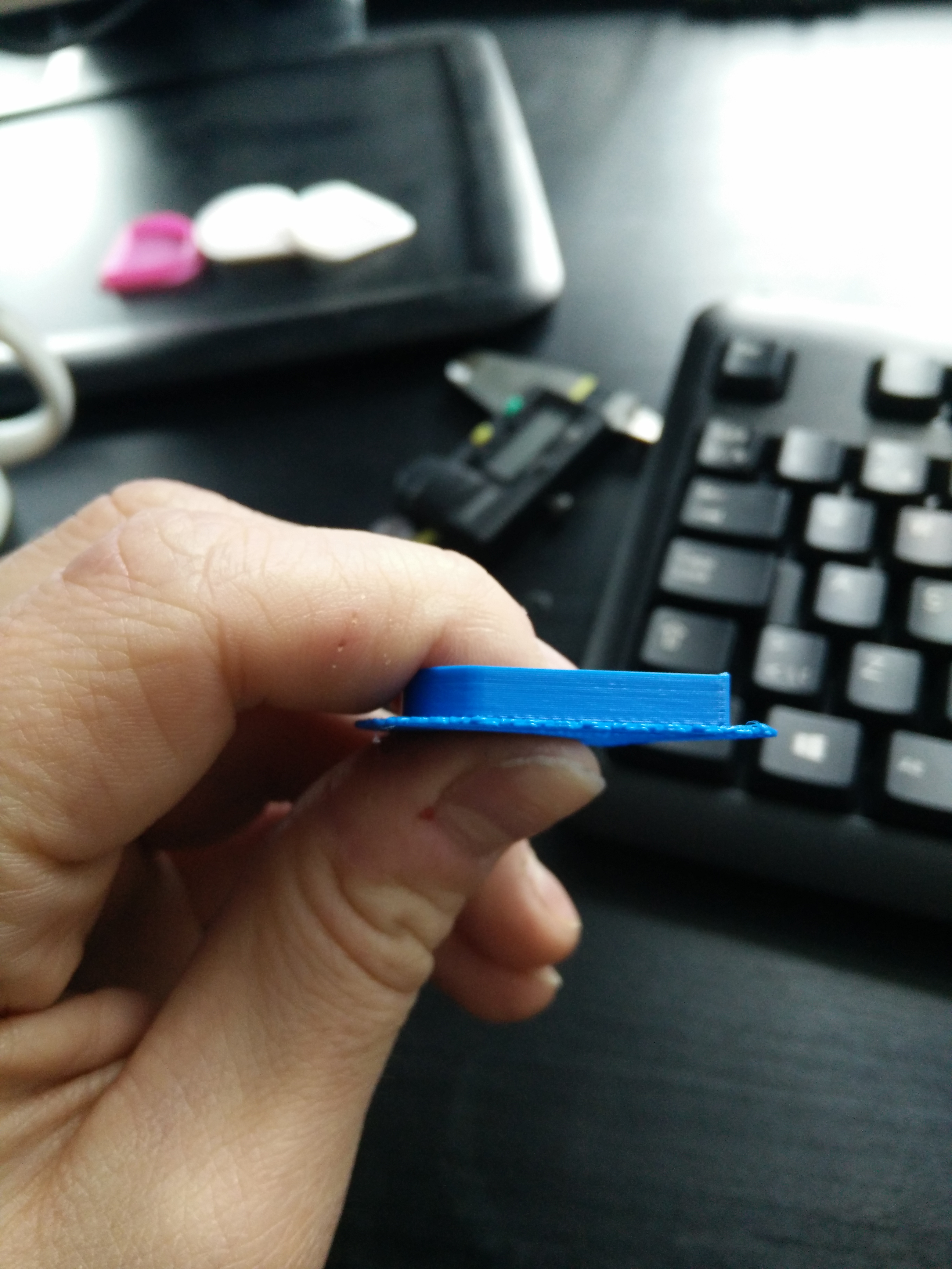

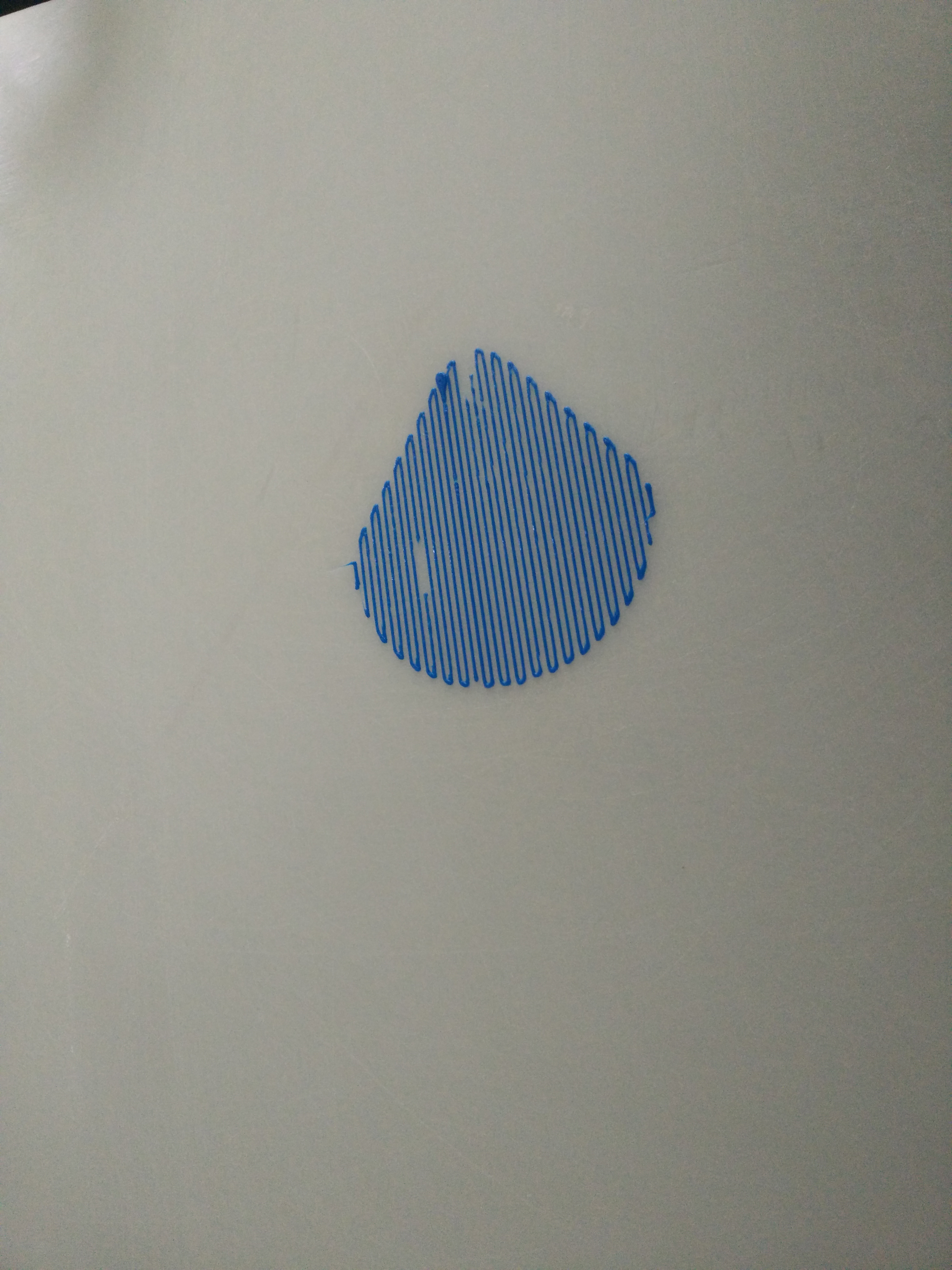

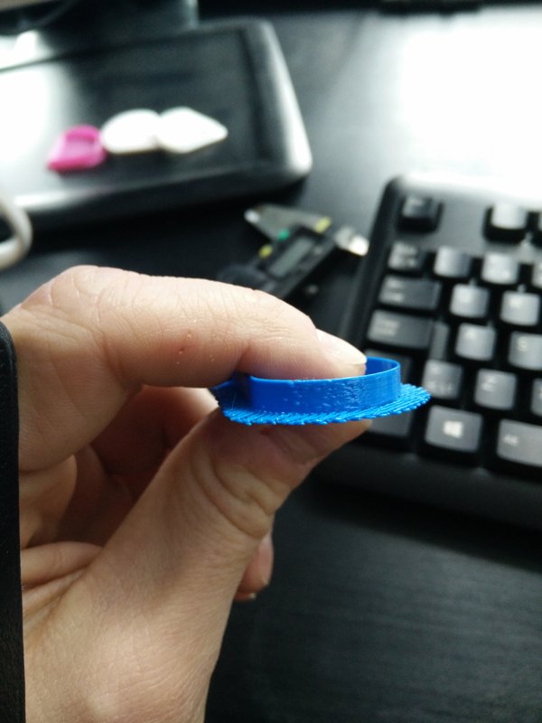

1: 1. Layer is a mess, regardless what the first layer is (Part or an raft..) Picture added below.

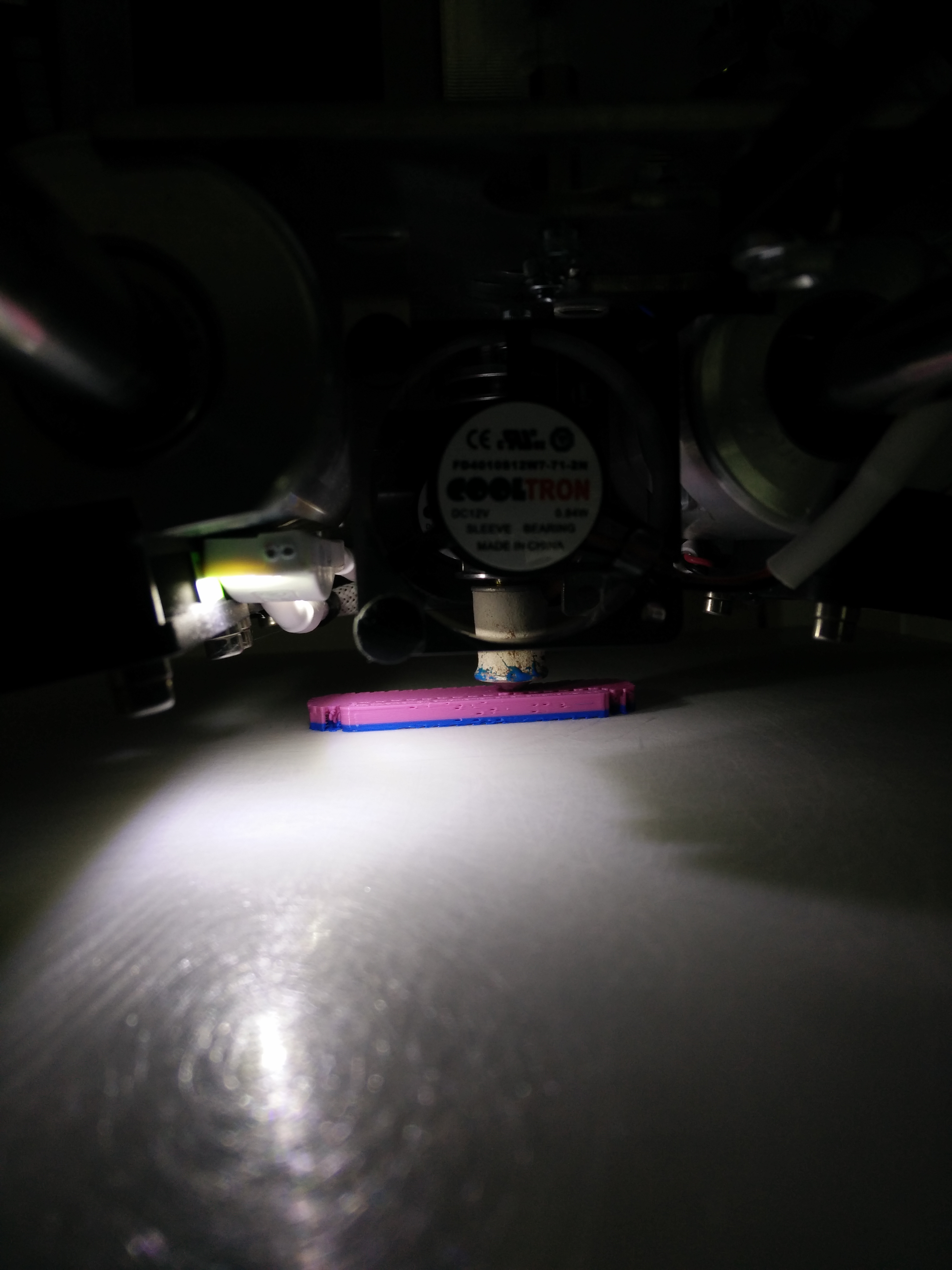

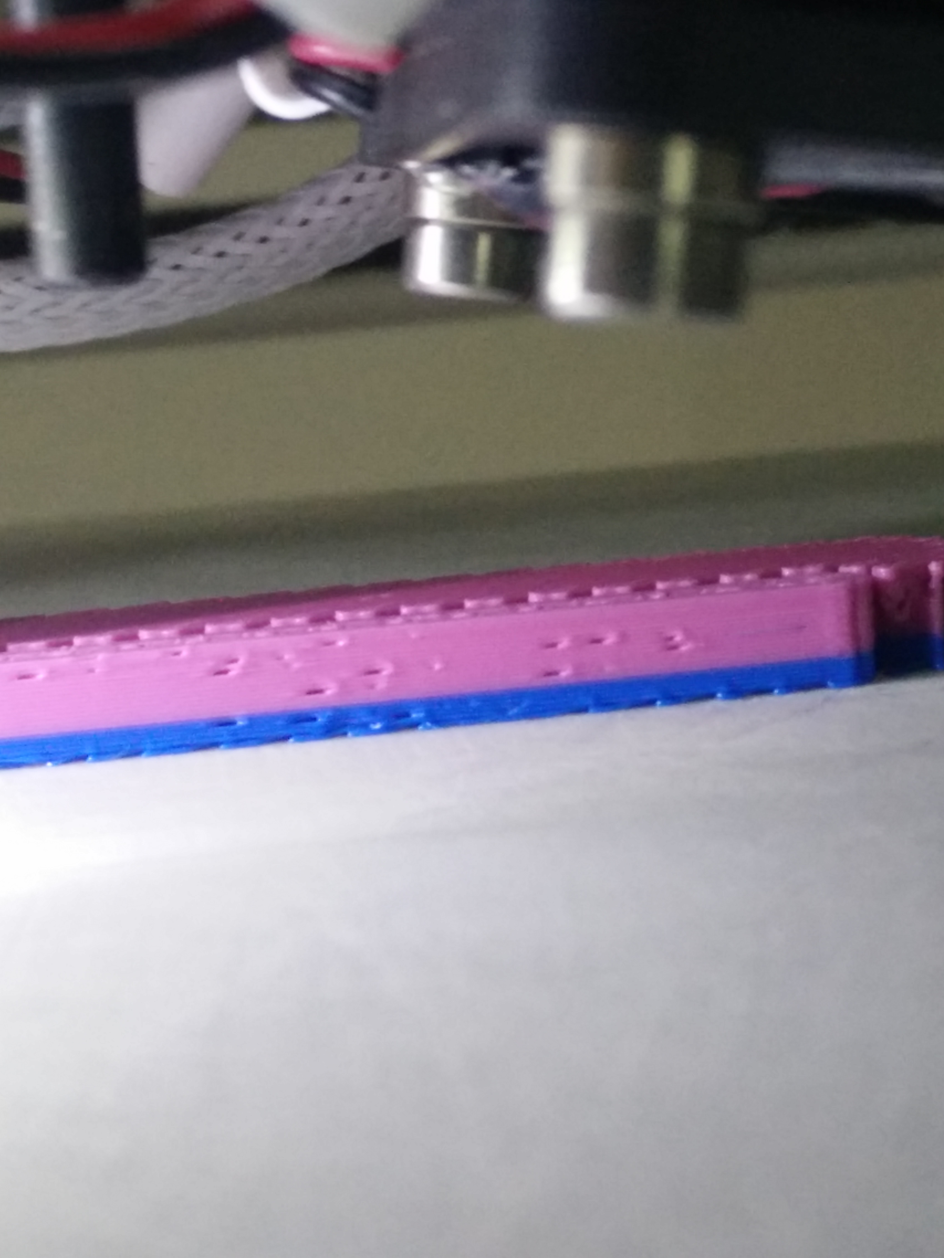

2. I get smal holes/blobs at one place on the side when I print. Picture added below.

Several possibilities :
- Increase your flowtweak in material tab and check with your calliper the thickness to accord with your nozzle 0.5
- Check your extruder motor and if you've a clicking sound, try to increase your extruder voltage.
regards,
Hugues

Hi
The wall is measuring 0.5mm, so the flowtweak seems OK?
No clicking sound from motor...
When I use kiss 1.4.5.10 there is no problem...
The holes/blobs are only at one place along the surface of the wall..

Ok,
Try to increase the perimeter speed, you setup 13 and i think the cubex is unable to manage it. Try something like 20
regards,
Hugues
www.cubexupgrade.com

Post by Hugues »
I do not confirm, 13mm/s will give you really low rpm speed for the extruder. This can do some error cause the encoder wheel into the extruder have a low resolution.
Usualy the cubex print well between 20 and 35 mm/s
regards,

For me there's air sucked into the nozzle during the M227&228, the settings are not good for your filament.
try to put
227P = 0.06
227S = 0.02
228P = 0.01
M228S = 0.003
