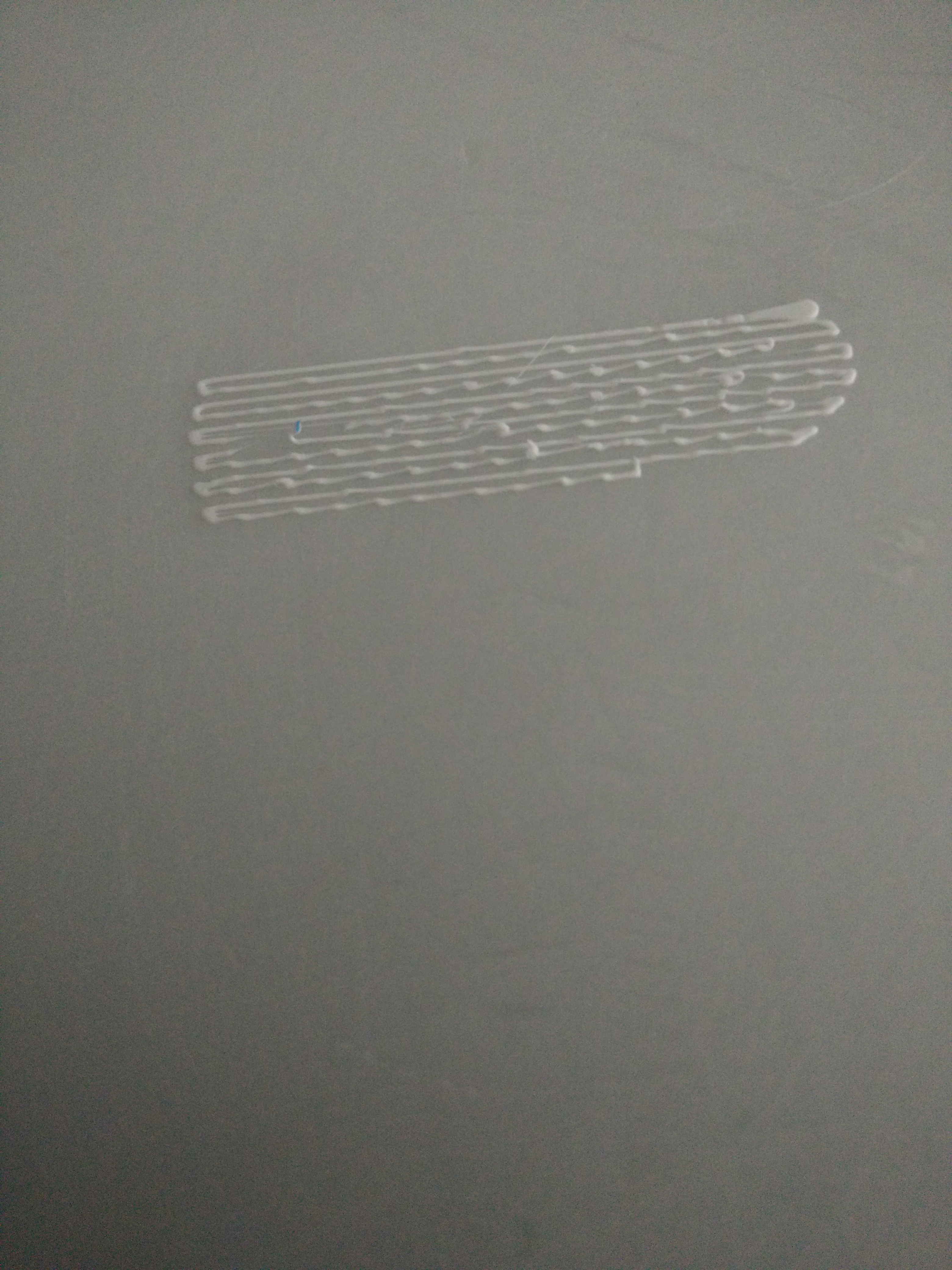

Hey Again
I have tried the new settings. I still have problems with the Raft in kiss 1.5 Beta 2.22. See picture.
- Posts: 241
- Joined: 18 Nov 2014, 09:34
Re: Flow/Printing Problems - CubeX and Stock Nozzle
The pic shows too much gap or too little RPM.rantzaus wrote:Hey Again
Reduce the zgap and/or increase the raft width.
It's difficult to say just by looking at the picture but I think is more a problem of zgap.
