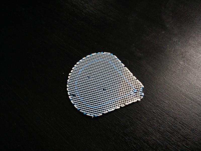

When using the old version 1.4.5.10 there os no problem. I have installed the GRM sensor for a more constant z.gab...
I have tried to change the flowtweak of the support, and that did help a lot...

I did change the wifth to 0.7mm and the raft is very nice and need.
Thanks!!
