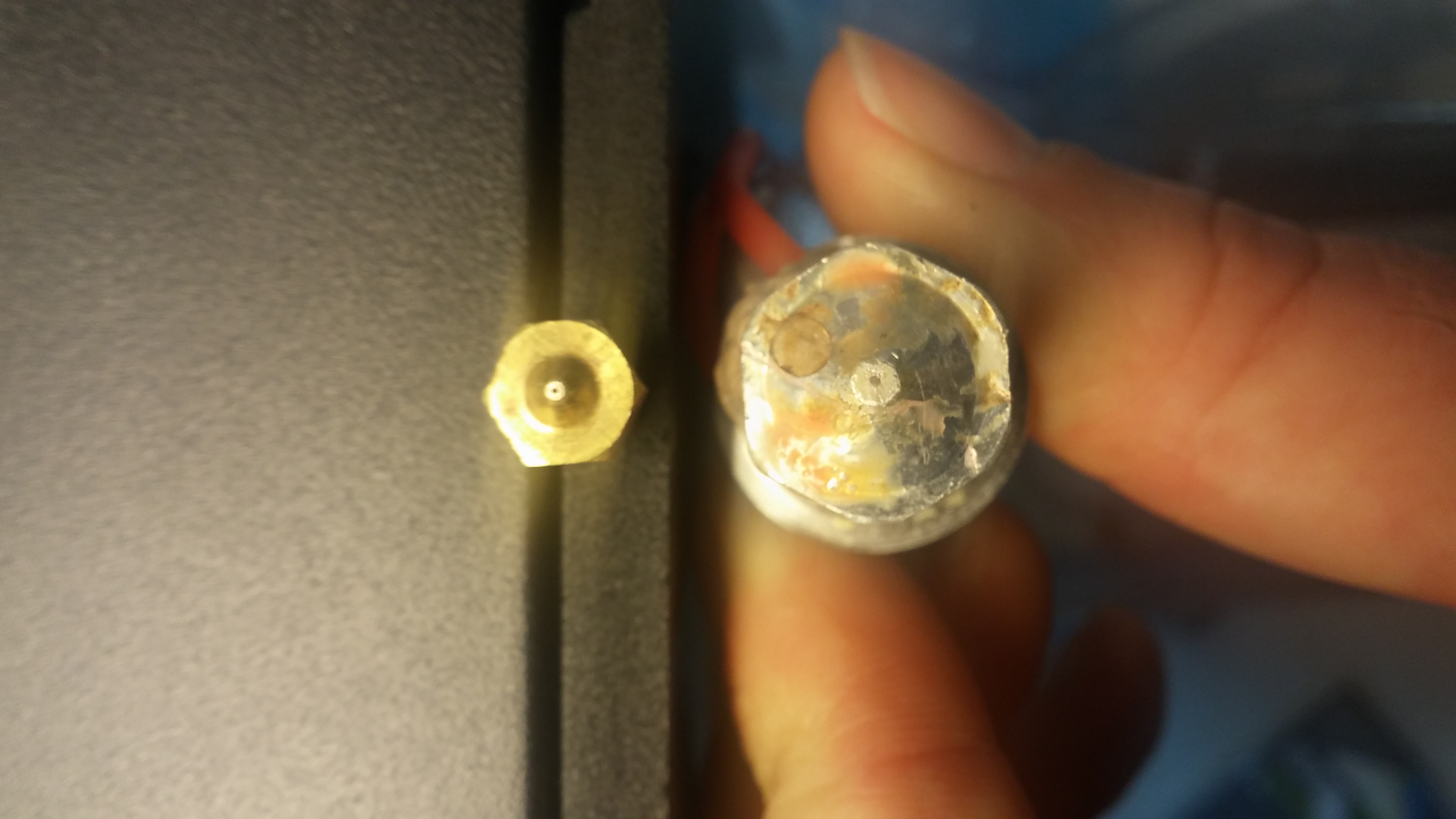

For cubex, i'm sure that's a 0.5 mm . To compare a take a picture of it near a 0.3 nozzle from e3d.
There no reason for 3ds to sell a 0.3 nozzle, the bot is enough slow to not add 2 more time print.
