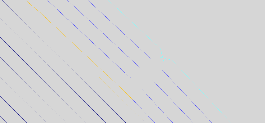

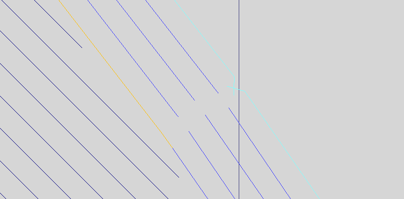

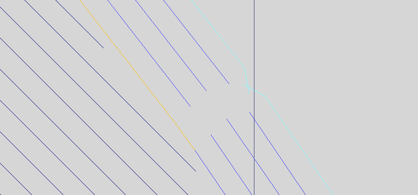

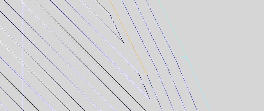

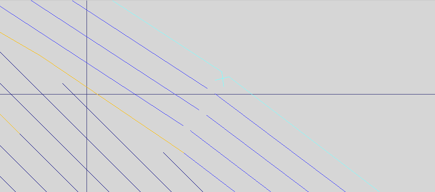

Re: Seam Hiding Gap
Here you go, a set of different gaps so you can see what's going on.
0 gap, .5 gap, [1.0 gap], 1.5 gap, 2.0 gap

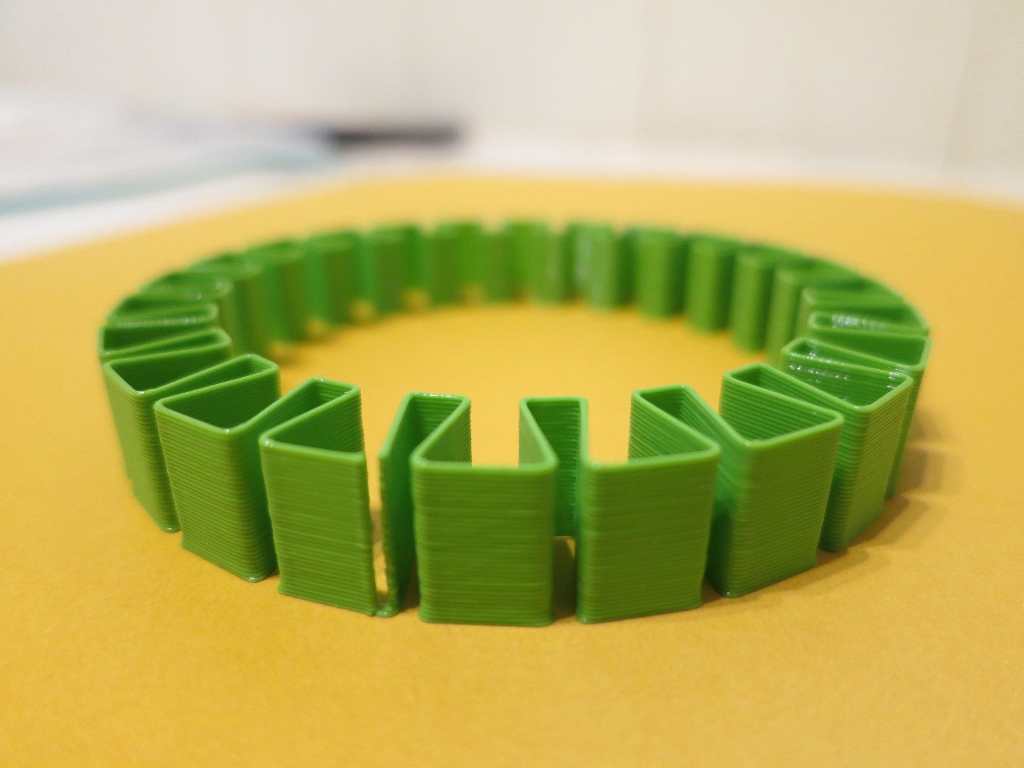

I have been having trouble with thin-walled objects (ok, modified stretchlets) having gaps. Some of this may be down to filament type/colour, or temperature of my workshop now we have frosty mornings in York, England.
I thought seam hiding jitter would help, as the part is breaking where the start/stop for each layer is.
I think that the seam hiding jitter does not work on layers for parts where the path is a single loop. I have made STL files for a simple hexagonal box with different wall thicknesses. When the thickness in my model is 1.6mm, I get two loops for the walls. I can play with the seam hiding settings, and I see the effect of gap, width, angle and jitter by looking at the paths at different Z-values. When I add another hex box with wall thickness 1.2mm, this slices with a single loop for the walls. These loops *always* start and finish at the same corner, regardless of the seam hiding settings.
