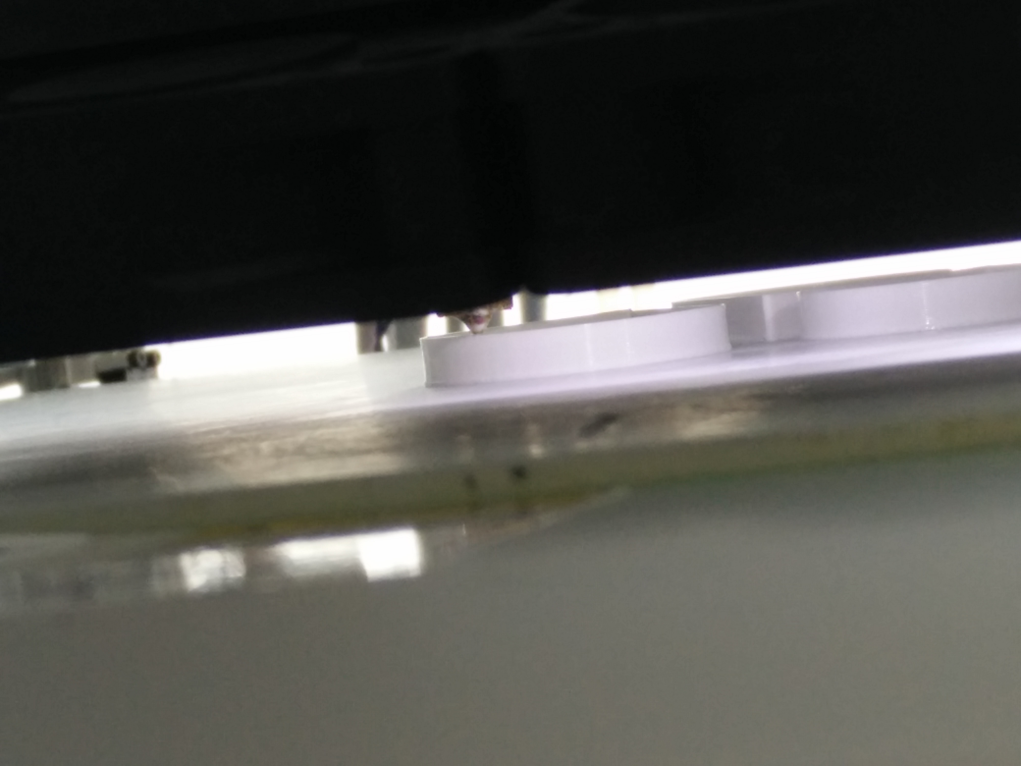

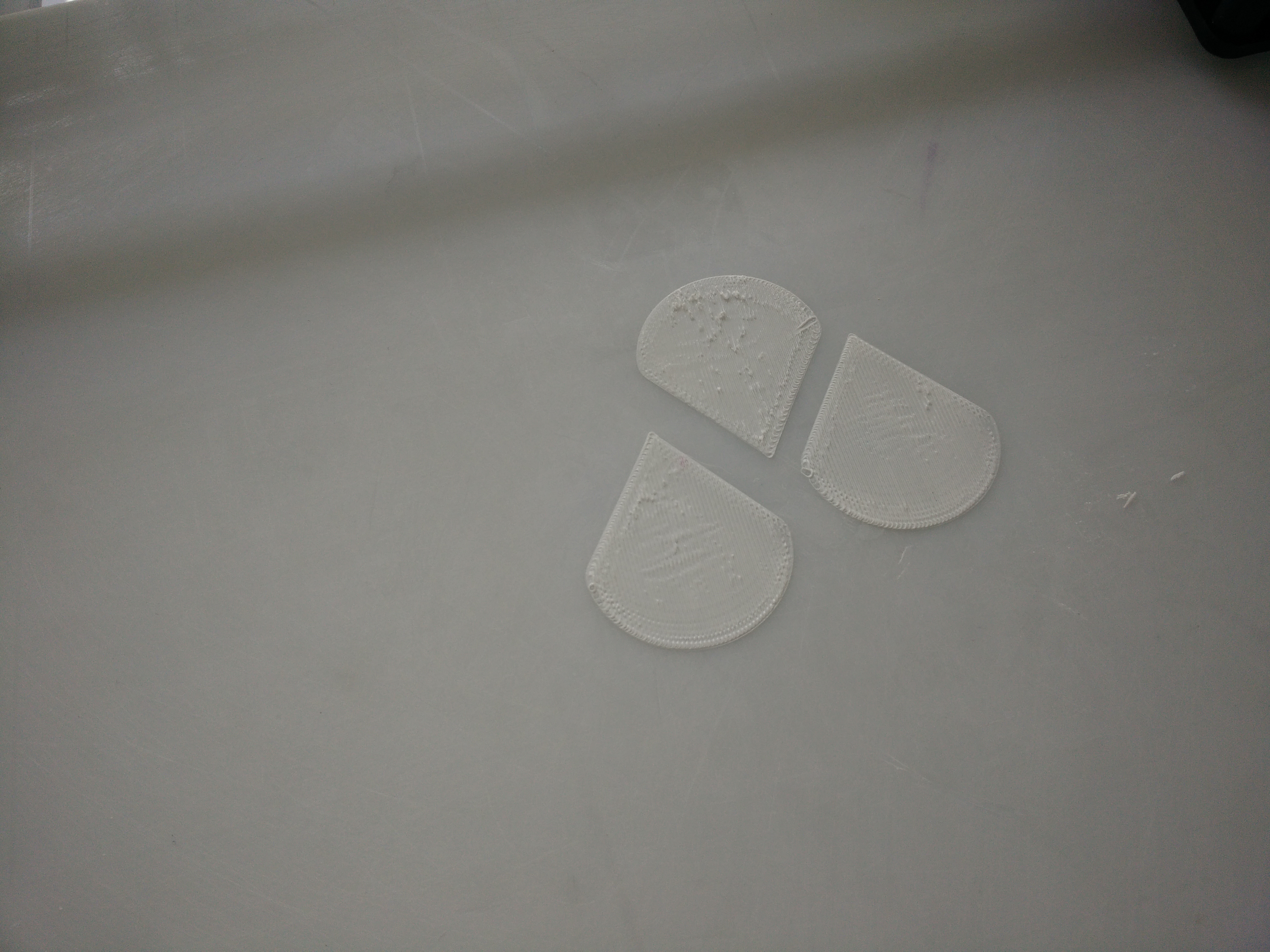

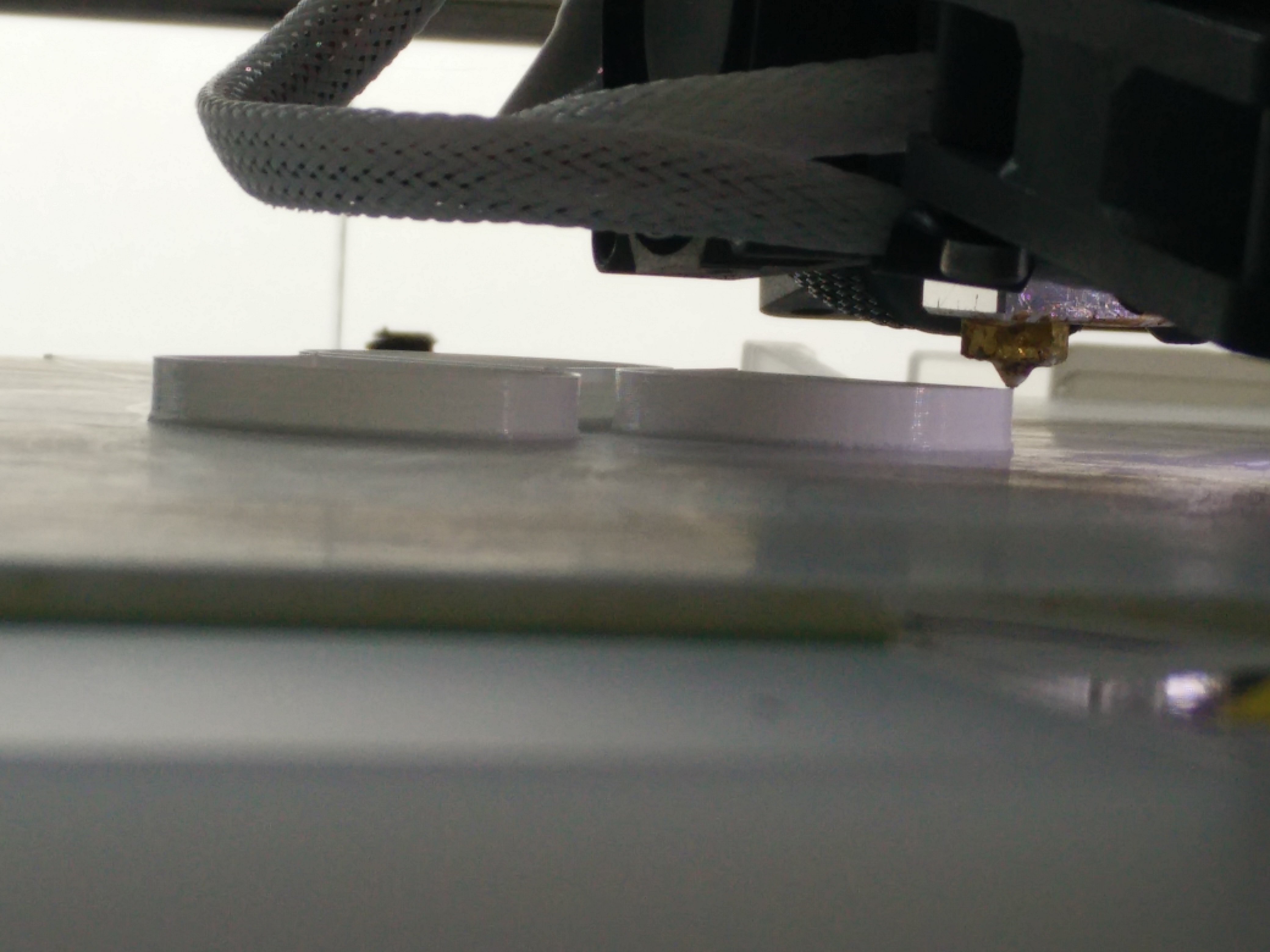

It seems wierd.
When printing the bottom layers, its like the printer os pushing to much material.
When printing the top layers, its like the printer pushes the right amount.. but it leaves small holes around the border.. See other topic: Bad printet text..
Looking at my prints from the side, it also looks like the print is squeezed in the lower layers, since the bottom is wider then the rest.
I cant figure this out right now.
- Posts: 241
- Joined: 18 Nov 2014, 09:34
Re: New Version CubeItModV6.05
it's a Z-Gap problem, the first layer is too much squished on the bed, this cause a problem that looks an over extrusion.rantzaus wrote:It seems wierd.
- Posts: 105
- Joined: 14 Dec 2015, 04:14
Bogus! The z gab is configured to match my 0 1 layer configuration. Is it possible to solve this by adding a z offset in kiss of 0.1?Giovanni V. wrote:it's a Z-Gap problem, the first layer is too much squished on the bed, this cause a problem that looks an over extrusion.rantzaus wrote:It seems wierd.
- Posts: 241
Z-gap or Z-offset is the same, the first is on the printer the second is in KS.rantzaus wrote:Bogus! The z gab is configured to match my 0 1 layer configuration. Is it possible to solve this by adding a z offset in kiss of 0.1?Giovanni V. wrote:it's a Z-Gap problem, the first layer is too much squished on the bed, this cause a problem that looks an over extrusion.rantzaus wrote:It seems wierd.
