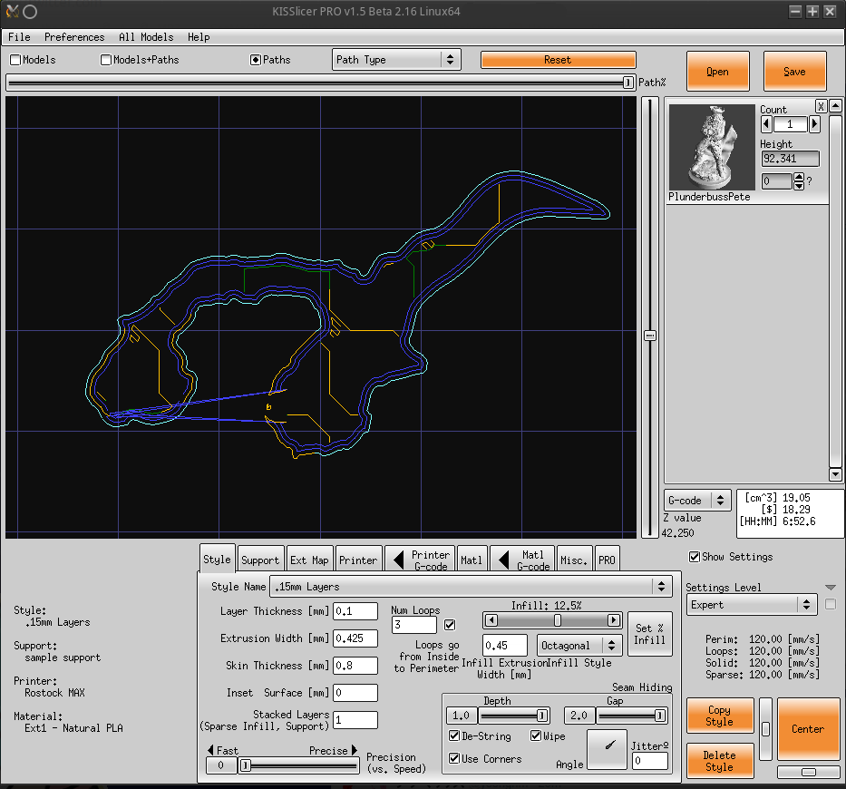

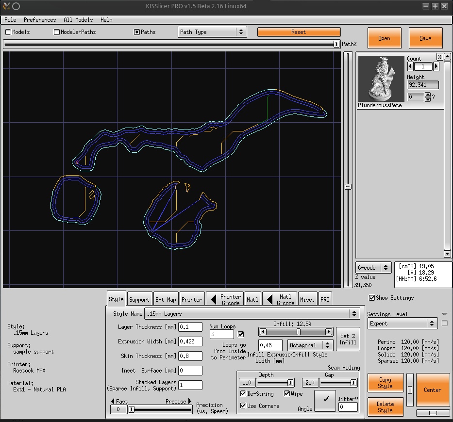

- Posts: 33
- Joined: 28 Jan 2015, 22:24
Found another bug - it's pretty bad! In some layers of a complex model (Plunderbuss Pete), some loops are not closed, and interior paths travel in strange ways (sometimes even crossing empty space) to get from one path to the next. The majority of layers are fine, with maybe 5-10% showing this behavior.
Model: http://www.thingiverse.com/thing:144775
The model loads with no mesh errors at all, so this has to be internal to KISSlicer. It may have to do with the extremely fine resolution of the mesh. I tried another complex mesh ( http://www.thingiverse.com/thing:40094 ) and this error didn't manifest.
- KISSlicer path corruption 2.png (49.68 KiB) Viewed 5837 times
- KISSlicer path corruption.png (52.31 KiB) Viewed 5837 times

@626Pilot
The open loops are from your Gap set to 2.
Error checked the mesh, there are 3920 self-intersecting faces that KS is not error flagging.

I checked your model, and although Kisslicer doesn't flag errors in the stl, there were some.
I repaired it for you. It seems much better now. I hope it helpt!
the repaired file:
http://www.thingiverse.com/thing:729684
Bart
the repaired file:
Bart
Bart ter Haar
- Posts: 33
A normal model doesn't get sliced with a giant concavity in any of the layers. It has to be a side effect of the mesh.frozen.rabbit wrote:The open loops are from your Gap set to 2.
You're right on this. I ran it through Netfabb and it slices properly now. Sorry for the false alarm!Error checked the mesh, there are 3920 self-intersecting faces that KS is not error flagging.
