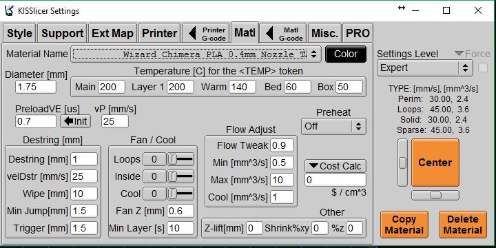

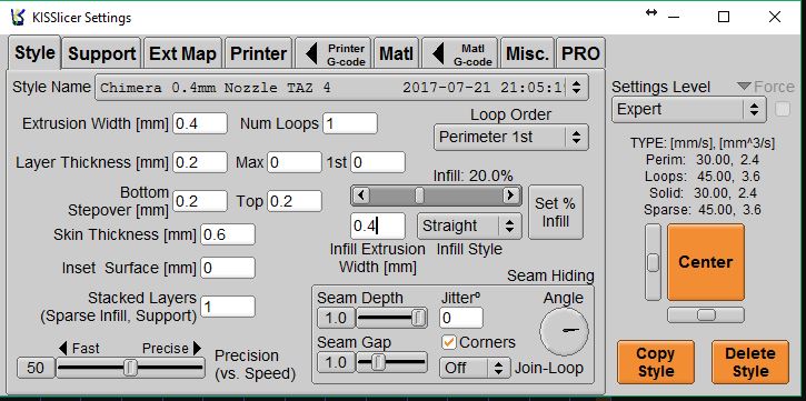

I'm printing some text on a part for a customer job and the second extruder always clogs on layer 2 of the text even with Preload set to 0.2 (I think it also clogged on Preload = 0.131892). I attached a text file showing some of the gcode. It shows the following sequence of prime / suck:
Destring Prime 24.6379
print gcode
Destring Suck 24.3997
Destring Prime 25.3997
print gcode
Destring Suck 24.7326
Destring Prime 25.7326
print gcode
Destring Suck 25.4968
Notice Destring Suck value always creeps up the extruder higher than the Destring Prime before it. Still the Prime to Prime Value and Suck to Suck value are increasing so not sure if I'm illustrating the problem that's occurring or not. I do know for sure the first layer prints fine, but on the second layer the hotend clogs everytime.
Would it help if I increase the Destring Min jump to greater than 1.5 when using the PreloadVE feature or might there a bug in Beta1.6V1.5 causing the issue?
If this is not a bug in Beta1.6V1.5, maybe Jonathan could add a feature that makes sure the PreloadVE + Destring Suck value does not go beyond a certain fixed or variable value.

inventabuild wrote:I'm printing some text on a part for a customer job and the second extruder always clogs on layer 2 of the text even with Preload set to 0.2 (I think it also clogged on Preload = 0.131892). I attached a text file showing some of the gcode. It shows the following sequence of prime / suck:
Any chance you can upload the project file?
Project/Save Project As -> name, zip and upload as attachment.
I can then use that to slice something and see what happens.

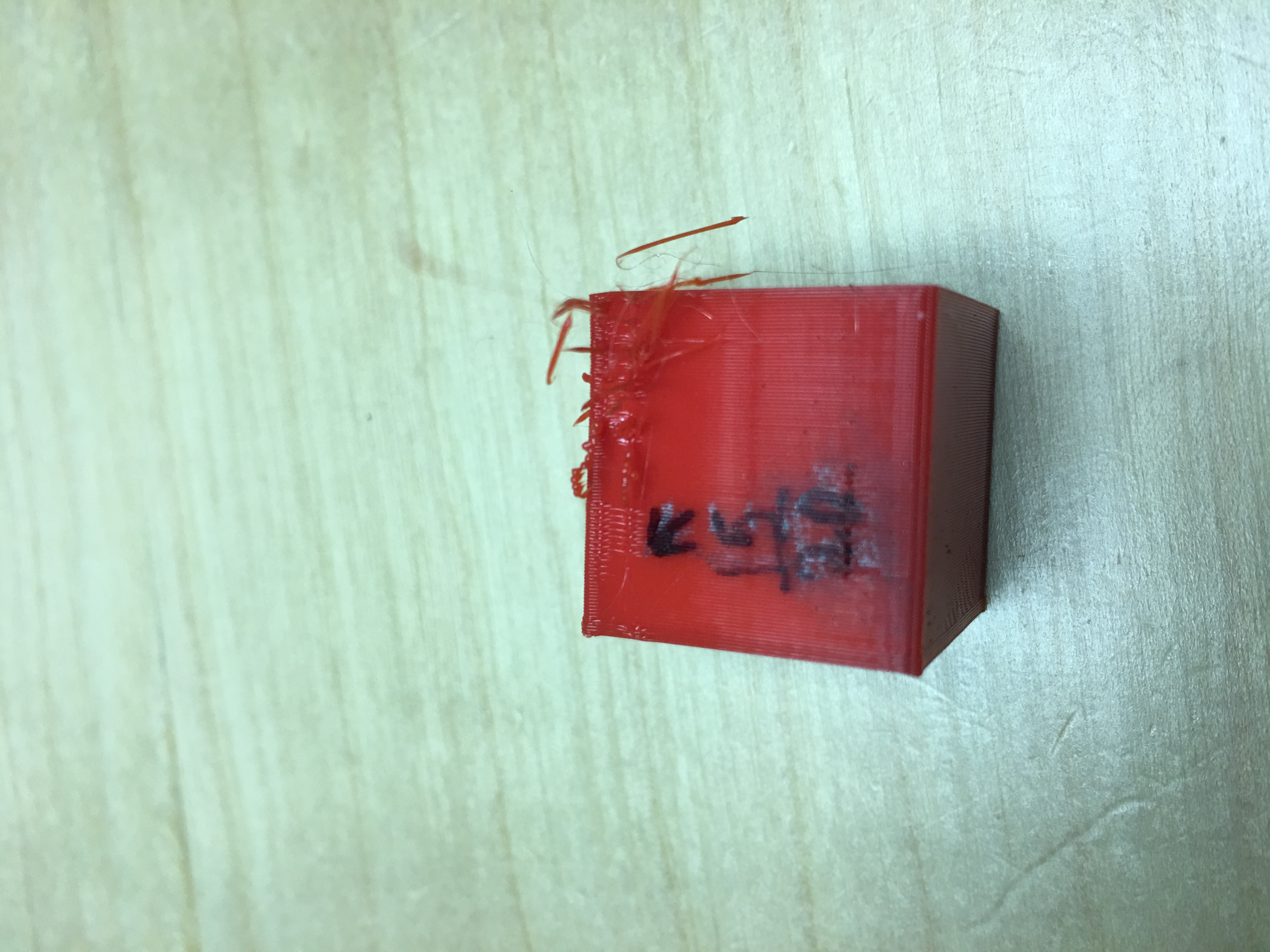

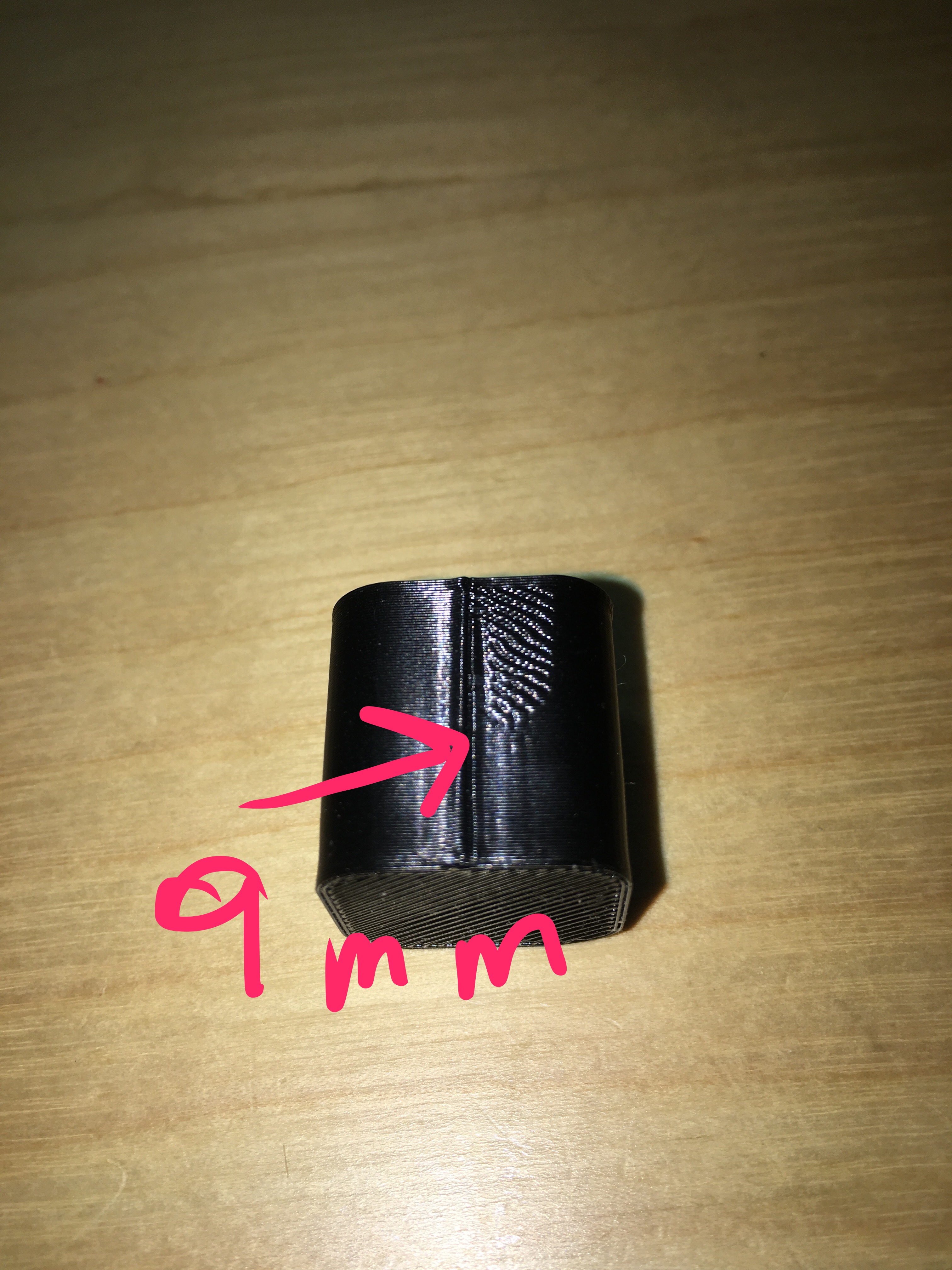

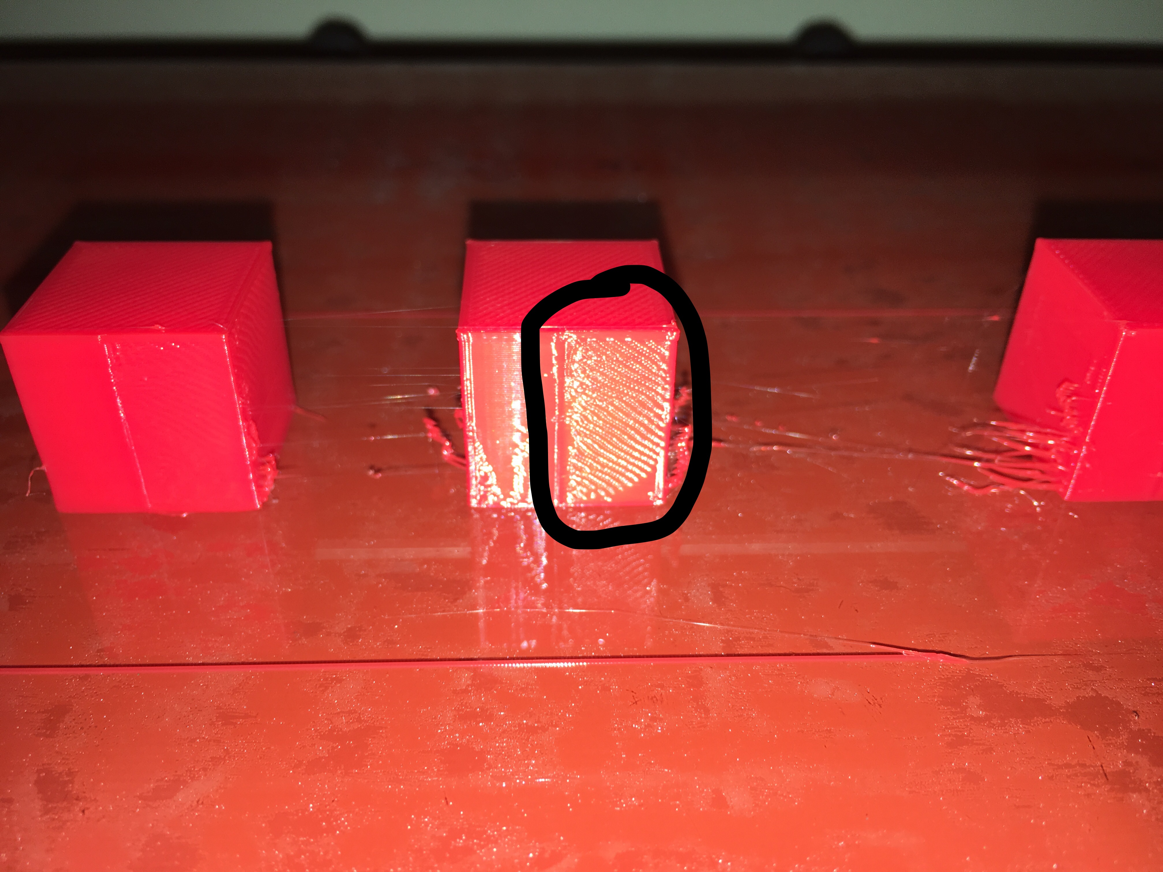

Printing with Hatchbox PLA I get wildly different PreloadVE values depending on the part used in the print.
1. Single 25mm cube - At 9 mm the chatter starts. Preload Wizard calculates PreloadVE = 0.45 at the start of the chatter
2. Three 20 mm cubes - Whole side filled with chatter. Preload Wizard calculates PreloadVE = 0 at the start of the chatter
Interestingly the #2 test with the three 20 mm cubes stops stringing at 15 mm so if I wanted to use the Preload Wizard for Destring I would use a calculated PreloadVE of 0.75.
Nearly every print except a vase has travel moves, but my travel move print (#2 above) tells me I need to use PreloadVE = 0 so maybe that's what it should be for my current 750 mm bowden tube setup when printing Hatchbox PLA. If anyone knows why PreloadVE should not be 0 when printing PLA w/ a 750 mm bowden tube please let me know. I look forward to trying the #2 experiment above w/ Ninjaflex and comparing the results.
