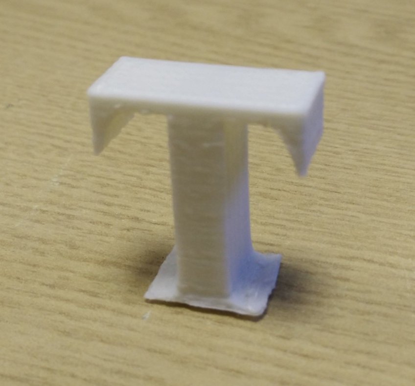

Mr Herron thats brilliant!
I'm proud to report that I took those settings and managed to get a print straight off!
As you can see from the picture, a successful print, but not quite perfect. The first layer was VERY flattened, and the top layer not flattened enough! Any ideas?
I've got settings from Epop as well (I now have a desktop full of different Kisslicer.exe and .ini files) so I'm gunna run some comparisons to see what I can tweak, but this is my first proper print using KisSlicer! Very Happy indeed!

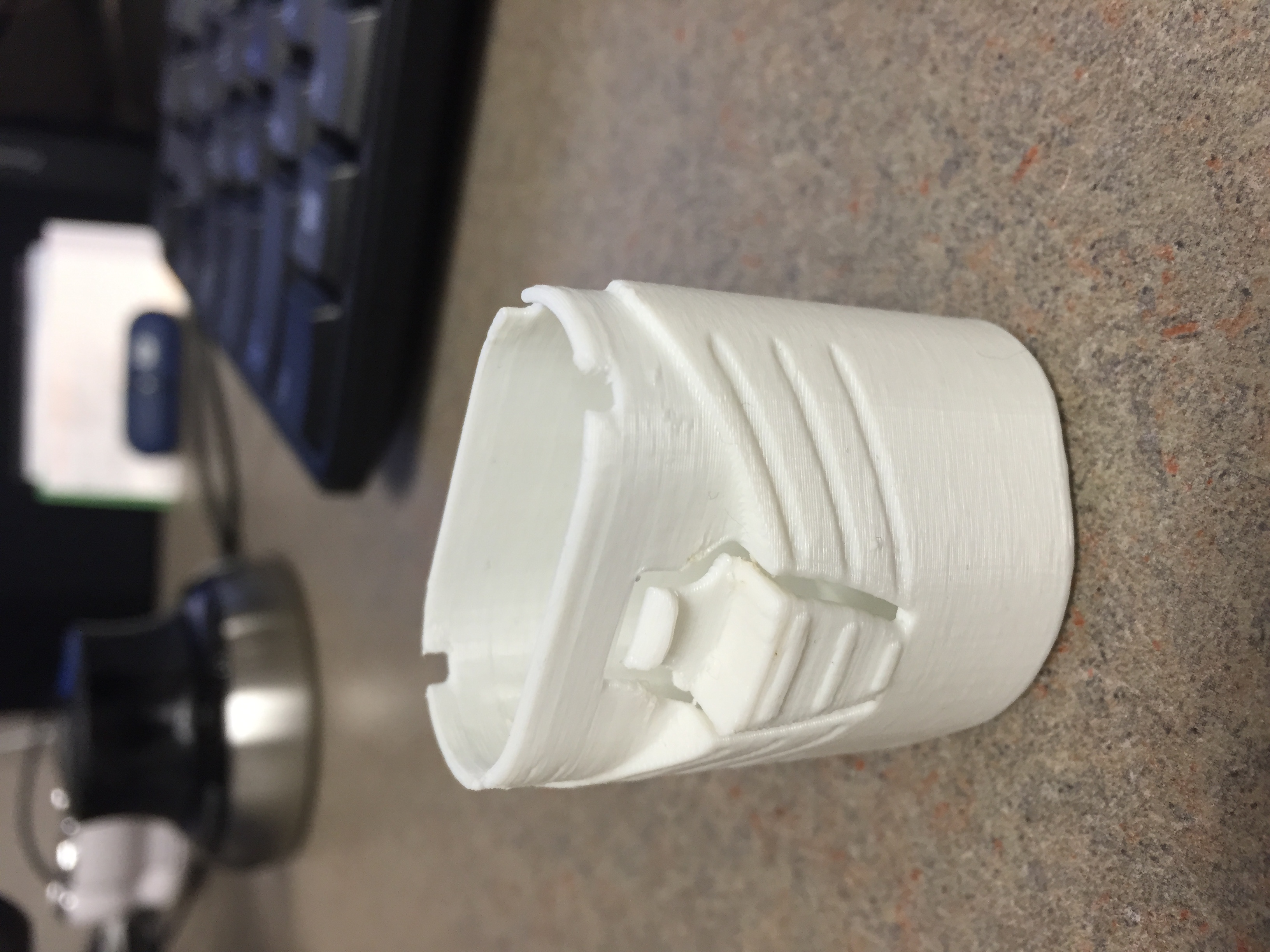

Here is the file I printed... Its not what I would consider excellent, but It is pretty darn good. Dimensionally it is also "Pretty good" being just 1/2 mm small on the inside and about perfect on the outside. This is a VAST improvement over the CubePro slicer. We've now produced several different prints using the KISSLICER/CubitMod/Codex workflow, and all are good--visually and dimensionally.
Simplify3D is working on a profile for the CubePro. We are sharing our results and files with them to further develop this profile. That is most likely the route we will go--just to simplify our workflow and increase our flexibility. Until we get there, i'll keep posting... My files thus far will only work on the left extruder.. I may try to get it working with the other if I have time...

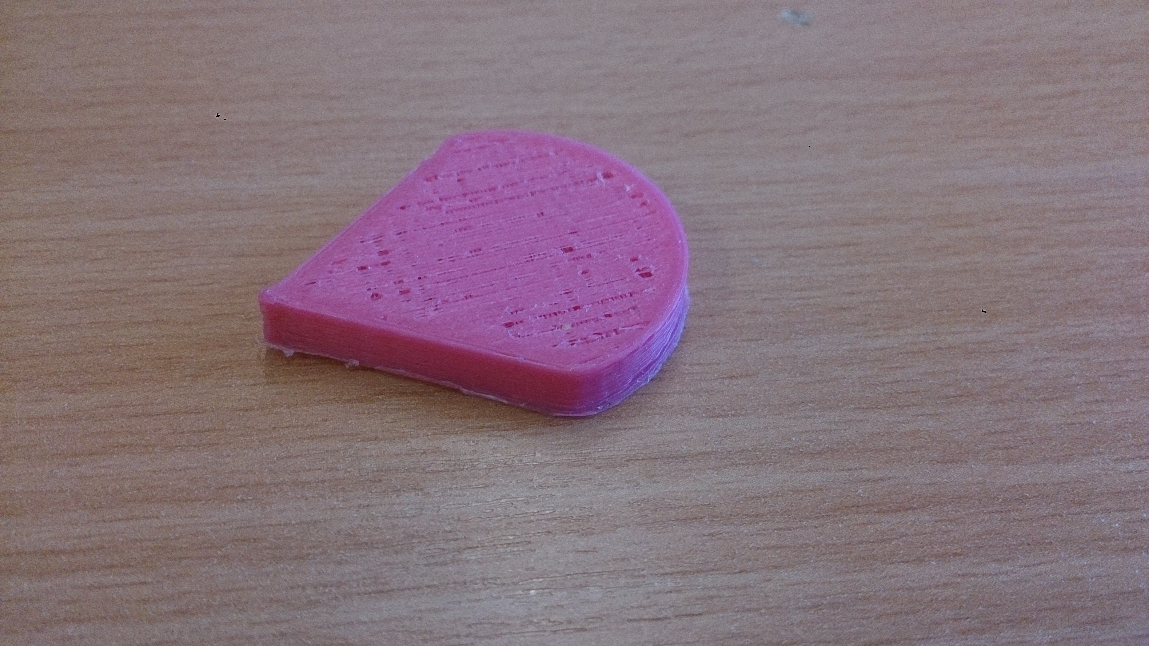

I just wanted to add one to the success pile.
I took the settings exactly as MichaelHerron had posted and got my first successful print out of Kisslicer on the Cubepro Duo.
Its not perfect and definitely needs tweaking but we are very close now. Great work MichaelHerron.
I used a test part that I use for all my benchmarking and testing. The first layer didnt go down too well and looked too thin.
The speed was way too high and the whole machine was rocking, but it finished the print with no errors despite a few unnerving sounds from the motors and belts. Because of the rocking some of the support was welded to the model but was still easier to remove than the cubepros attempt.
For the second attempt, I moved the speed slider to half way and was a lot closer to the cubepro speeds which was confirmed by decoding a cubepro file of the same part.
The resulting print was much better with smoother walls and the support came away so easy and actually looked like the preview in Kisslicer. Im not sure its ready to be first choice slicer just yet, but will definitely continue to tinker and use it for the parts where lots of support are needed.
