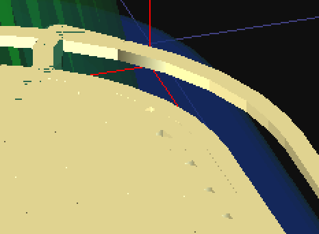

And while we're at it, this display problem:
see that thing going from skirt to the part in the same model? It is in fact a travel move in g-code, but isn't displayed as such (unless you color by path type, in which case it's colored as a travel move).
But I believe I'm using the wrong thread anyway.

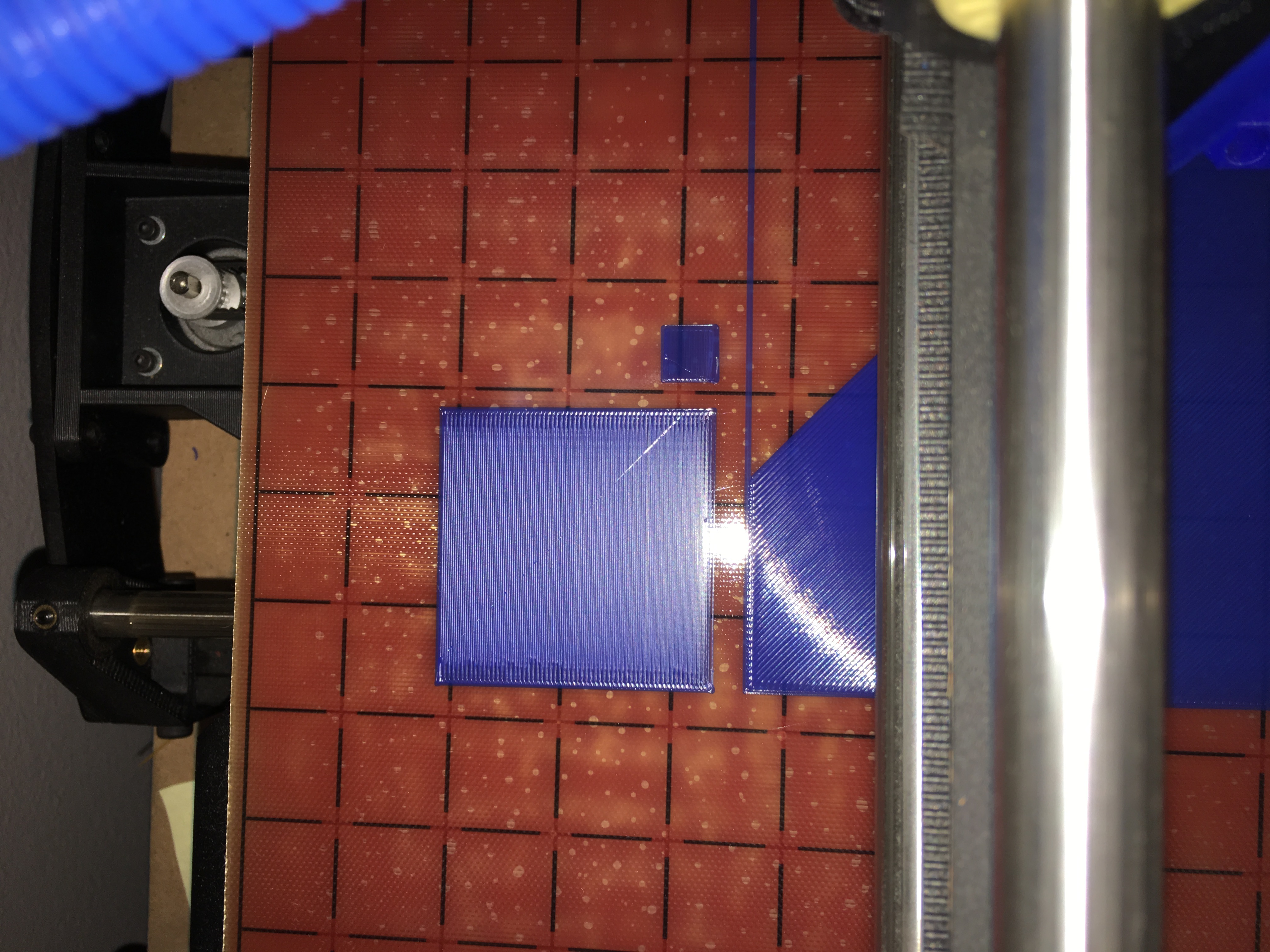

1. Allow for the purge octagon have two speeds, one super fast for most of the purge (60 mm/sec+) and one super slow at the very end of the purge (5 mm/sec) to make the purge super fast until the end where it slows down to prevent dripping as the hot moves to the part. Shown here as a large fast (50x50) and small (10x10) slow purge towers, but Jonathan can make them into one:
Large Fast + Small Slow Prime Pillar
