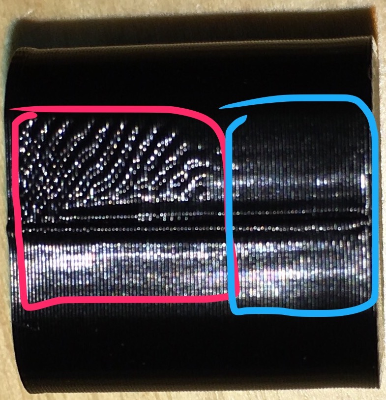

I started using the VE Tuning Wizard.
Here's my print. The enclosed red area has chatter at the seam. The enclosed blue area is clean at the seam except for the first three layers (0.6 mm) from the edge.
Is there a sweet spot in the blue area to pick for best Z? In other words should I pick the middle of the blue area, the point in the blue area furthest from the red chatter area or does it not matter? I've had limited time to experiment; hence the reason for my question.
By the way, I used to use retracts of 3 mm with my 750 mm Bowden extruder pre Jonathan's VE Wizard. When I ran the retract wizard (away from my computer and can't remember it's exact name) using values from 0 to 3 and picked the midpoint of the enclosed blue area (5.5 mm) for the VE value, my extruder clogged due to excessive retraction distance. I'm going to try the default retract values of 0 to 1 in the retract wizard next time and see how it goes.

The best way to do this if there is question is to pick the middle of the good area. Then re-run the calibration print using a tighter range around that in the preloadVE wizard.
So lets say that the wizard calculates a PreloadVE of .75 when you pick a best Z in the middle of the blue area. Rerun the wizard with a value of Z=.5[us] at Z=0 and 1.0[us] at Z=top. That will let you determine a more refined best z.
Once you get some experience you'll likely know where that best z is without reprinting.
Re: KISSlicer 1.6 Beta 2.4 is here! (UPDATED 2017-07-14)
Thanks mhackney, that matched my intuition. Last night when I used the midpoint with my pre-wizard-version-of-Kisslicer retract value of 3 mm I got a clogged extruder. I'll be running the Retract Wizard later today when I get home from work so I can get an optimized retraction distance to match my optimized PreloadVE value. It will be amazing if Kisslicer's optimum PreloadVE value works well with a small, say less than 1 to 1.5 mm, retract distance on my 750 mm Bowden extruder considering I had been working with a 3 mm retract value.

inventabuild wrote:Is there a sweet spot in the blue area to pick for best Z?
As far as I am aware, the best result is in the blue area as close to the red area as possible.

Destring wizard. Didn't seem to be any different on a 20mm model with the bounds set 0 to 4mm. So I left everything alone.
Still trying to get the seems perfect; the "Join Loop" really helps, but I still need a "Seam Hiding Wizard" for both depth and gap. Too many combinations to do it manually...

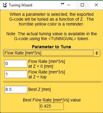

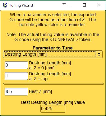

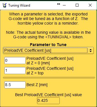

Are all the wizards functioning? I'm getting the same output value for all of them; the PreloadVE, Destring, Temp and Flow Rate Wizards.
PreloadVE Window
PreloadVE Window
Destring Window
Destring Window

Flow Rate Window
Flow Rate Window
Is there something I need to do to activate each one?
