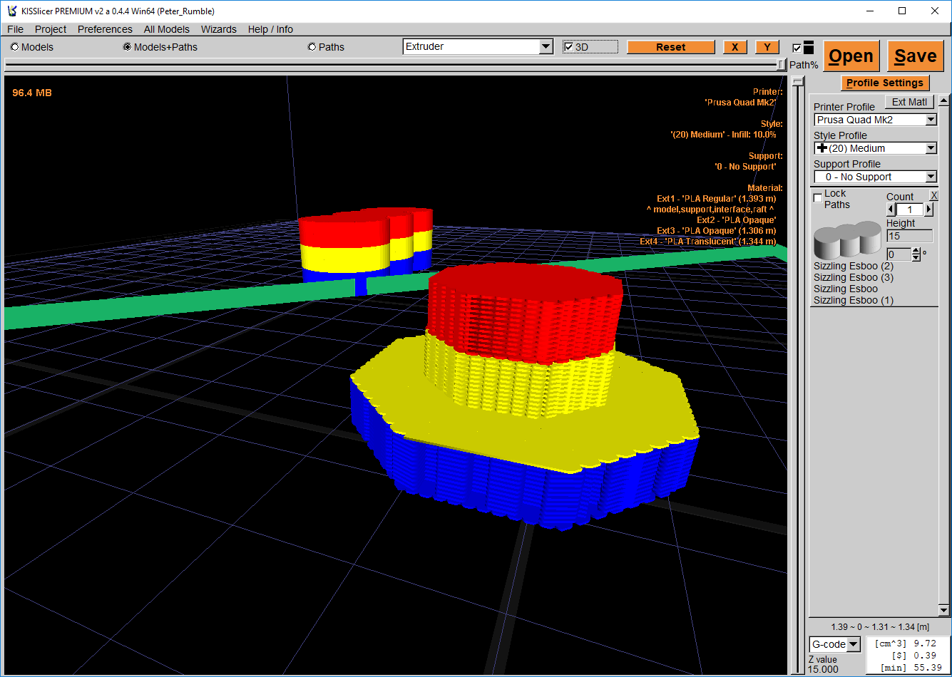

Re: KISSlicer 2.0 Alpha Feature Requests
pjr wrote:
hacker wrote:Because purge octagon looks so odd, that I suspect it's not even ready for trying?
:D
The attachment IMG_20180710_204853.jpg is no longer available
Sorry to disagree ;) It's actually quite good...
But you do need some manual G-code for tool changes.

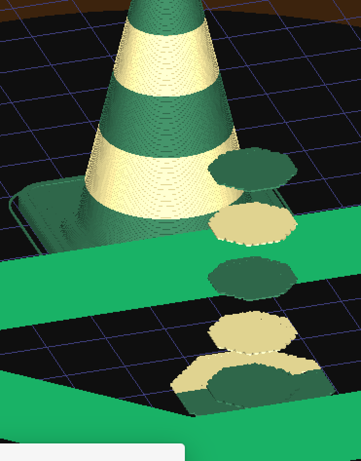

Looks great, Peter, I got this —
And it's not just display, it's also the generated gcode (there are also problems with displaying paths, where travel moves are shown like print moves, which I confirmed doesn't seem to affect g-code). I must be doing something wrong… G-code for tool change is no problem, I mastered that and even wrote a postprocessor akin to yours, worked great, wanted to cleanup the code and opensource it, but then the news of 2.0 came. Not that I abandon my plans to release it (still useful for other slicers), but will definitely postpone due to the lack of time.

hacker wrote:Looks great, Peter, I got this —
That model is not really ideal for this type of print; better to simply change the filament at the desired heights.
Do you have the STL available? I will slice it to see what happens in my alpha version (Jonathan may have changed something somewhere).
And I don't need that model to be printed either ;-), I just loaded something for testing. I've had it around for ages in my download directory, but I believe it's from here — https://www.thingiverse.com/thing:21773/files

OK, so I didn't wait (sorry), I downloaded the latest pre-alpha, changed the extruder map of a test model and came up with this:
Looks OK, so can you save your project files and let me have a look
TIA
pjr wrote:OK, so I didn't wait (sorry), I downloaded the latest pre-alpha, changed the extruder map of a test model and came up with this:
The attachment Image1.png is no longer available
TIA
EDIT: there's also a difference in the purge tower first layer...
Thank you, Peter, here is the .ksp, .gcode and .stls. Beside the possibility of doing something I see the difference in license — I have PRO and I didn't buy a new pro, that's the one I've had from the earlier release, no idea if it matters, while you have PREMIUM. And I use mac.
