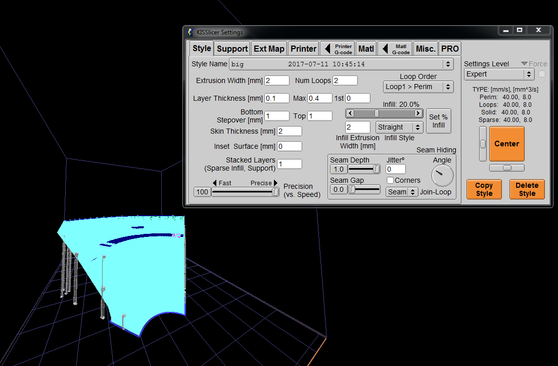

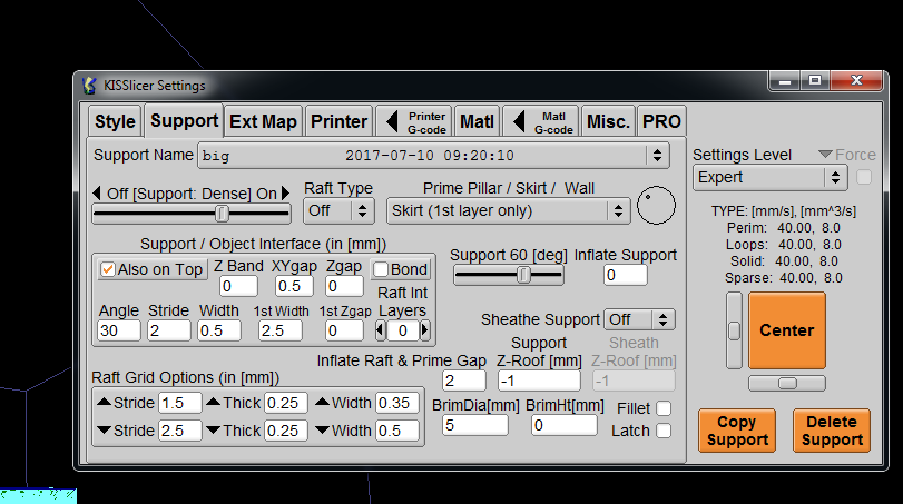

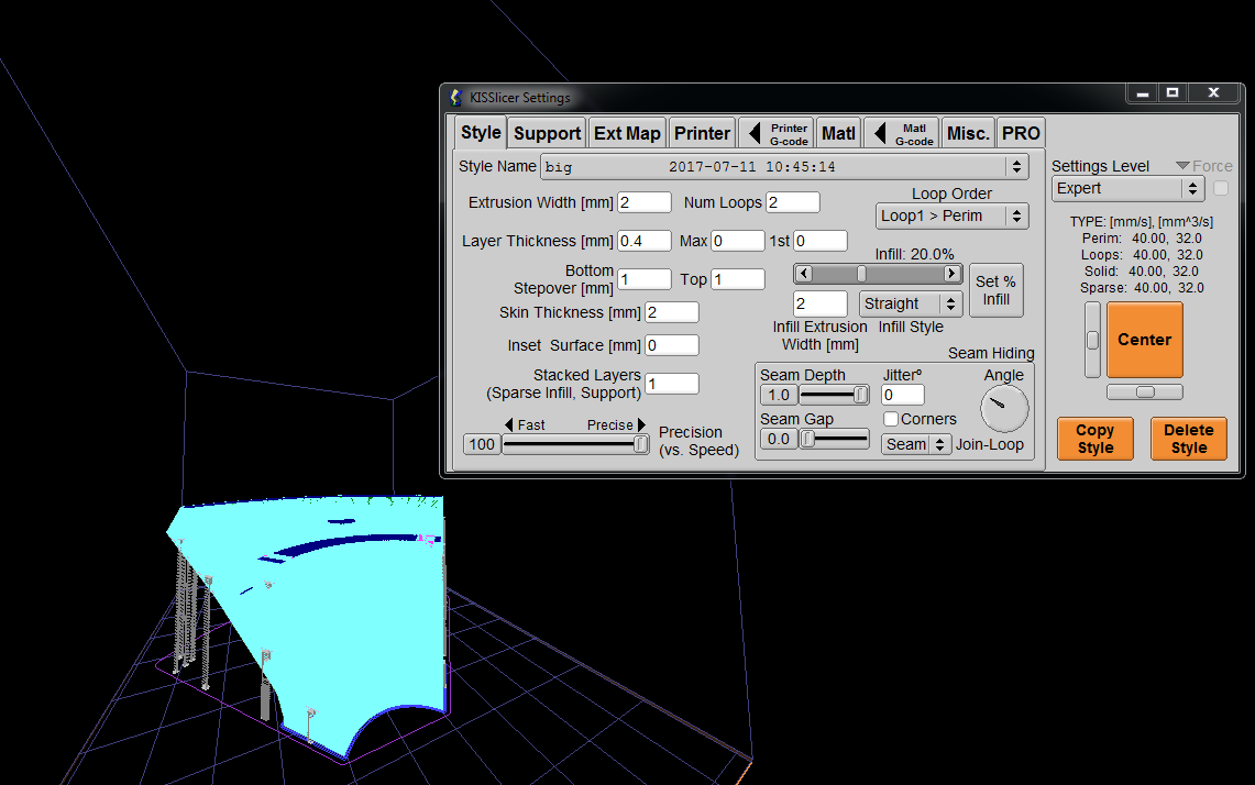

Skirt is not displayed if stepover control is enabled. The plastic consumption per second is also not displayed correctly. Can display at maximum flow?

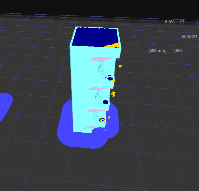

beta2.4
bug #1
no skirt, when "layer thickness max" > 0
bug #2 - flying destring paths
bug #1
- ooze_test.stl.zip
- (794.33 KiB) Downloaded 346 times
- Posts: 66
- Joined: 07 Nov 2014, 15:23
For me it is rather "Layer thickness 1st">0 which kills the skirt (having only "layer thickness max" > 0 is actually okay).abuharsky wrote:beta2.4
bug #1
