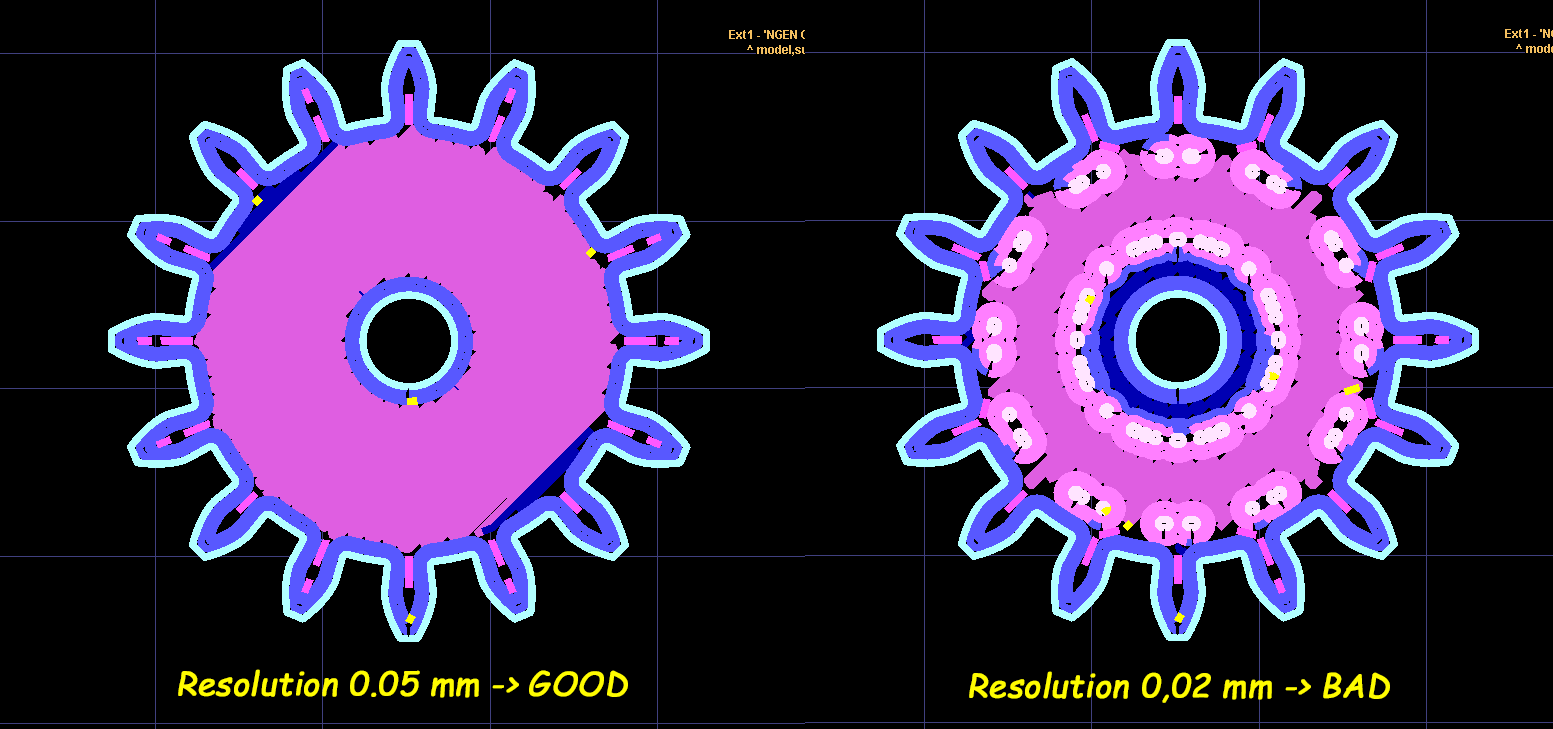

Any chance you could upload a model which exhibits the problem, along with some G-code of that model?resolution can be an issue if the model is really jagged / spiky

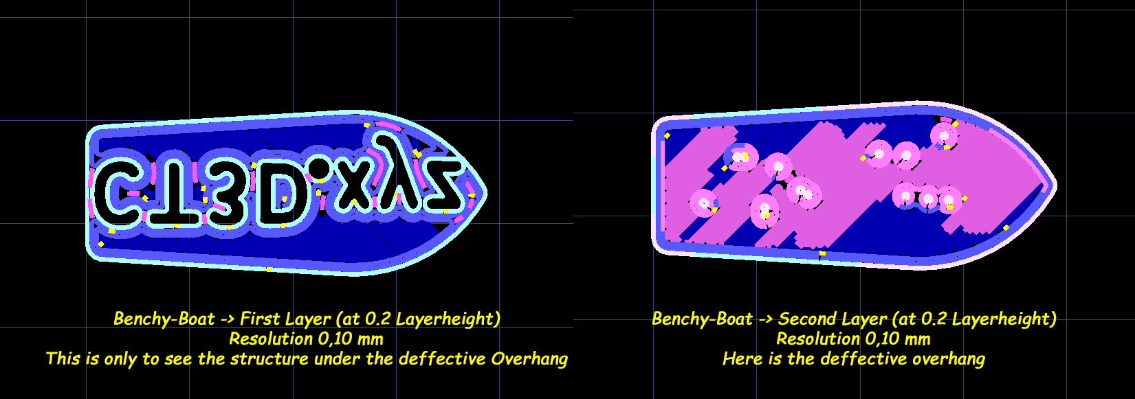

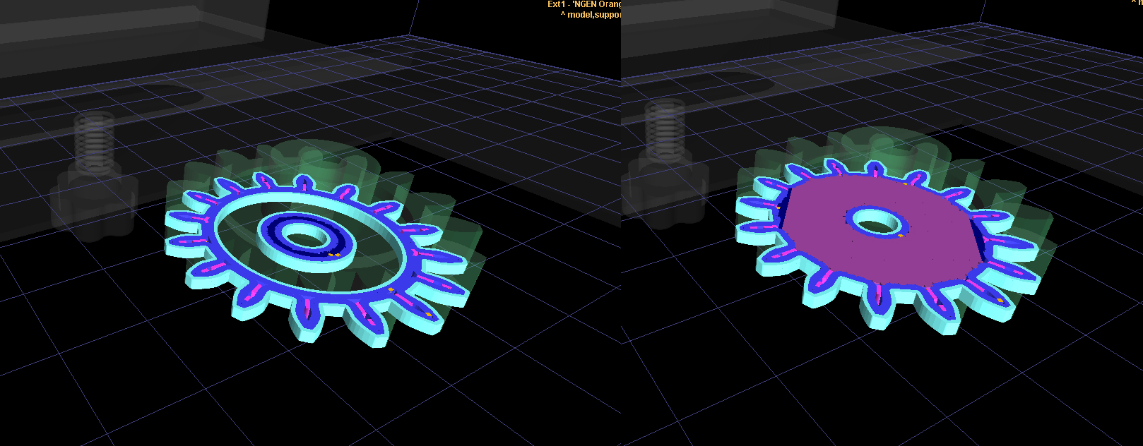

Re: Alpha Development
Hi Peter,
I attached a STL named "Gear.stl".
If you slice it with different resolutions, you see, what I mean.
You can see this problem in almost all STL's with overhangs...sometimes there are resolutions with good overhangs, but in the most cases this are low resolutions with ugly walls (too few lines).
Sometimes there is no resolution to solve the problem...and sometimes you have more different overhangs in one model where you need more different resolutions -> this is not possible
I prefer good resolutions (0.1 mm and shorter), but there is almost no chance for good overhangs. I think this is only a small bug with mathematic but with a huge effect which caused me to try other slicers from time to time.
I attached screenshots to show the problem. I already saw other people with screenshots of this problem in other thread...
Please scroll down in the pictures (or click in the pictures)...i placed some comments on it...
Thanks. This has been passed on and added to the fault list.Beefi wrote:I attached a STL named "Gear.stl".
I think I recall someone else reporting this issue before, but I never got to the bottom of it
