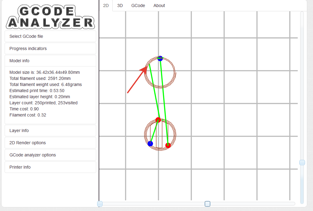

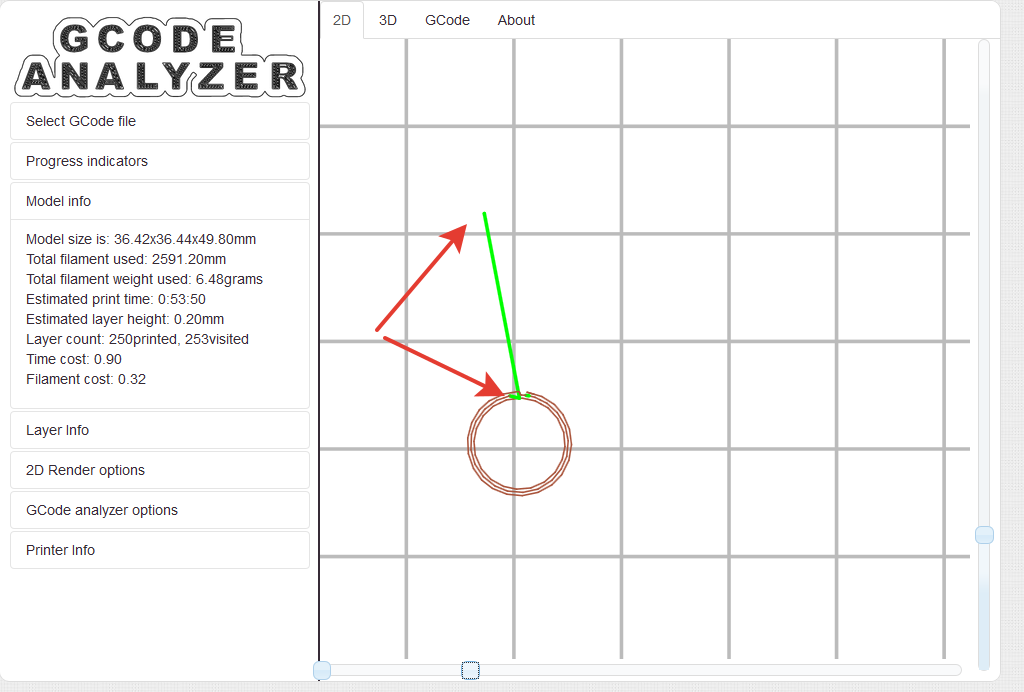

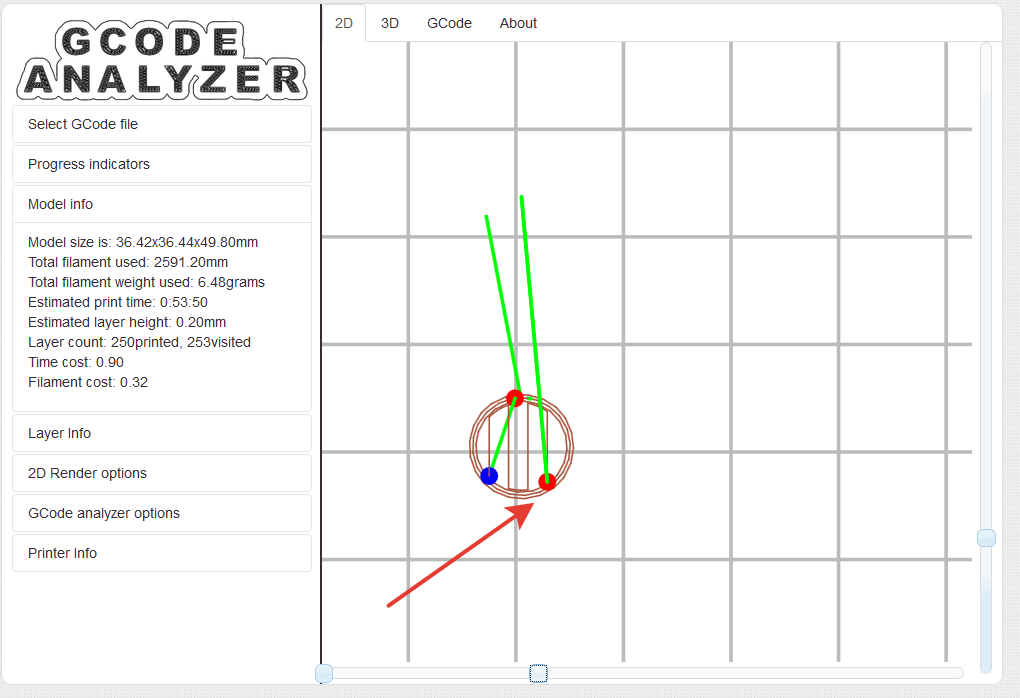

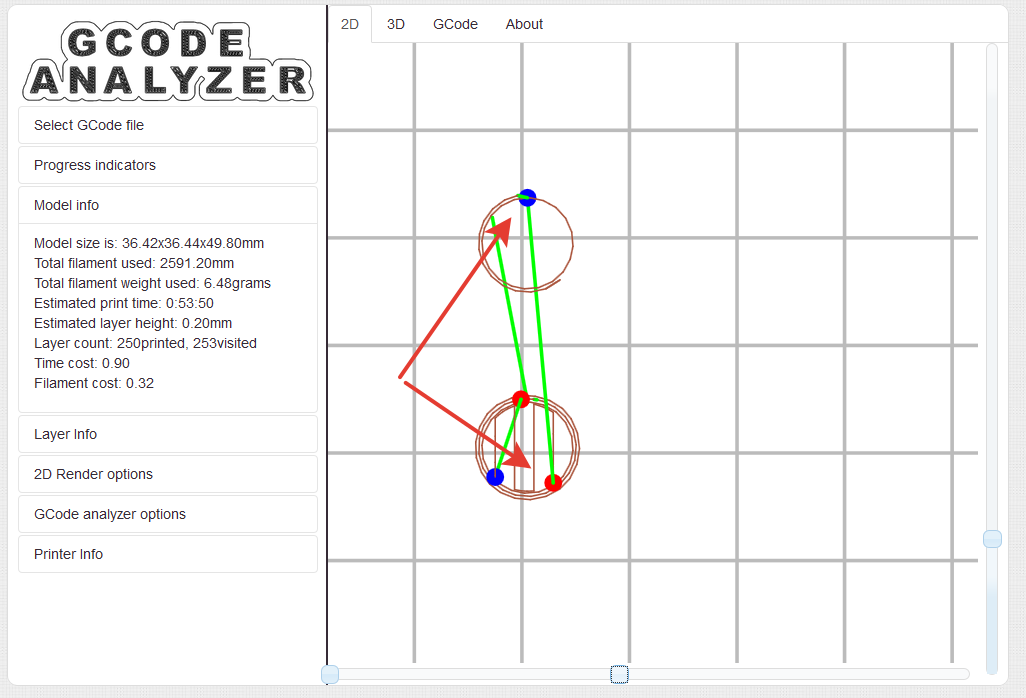

There is no retract when moving to a new layer of the next model. Travel = simple, Preload = 0, check Disable Bookend destring.
- Stolb x3.zip
- (195.64 KiB) Downloaded 532 times
- 0.png (92.2 KiB) Viewed 13549 times
- 1.png (82.03 KiB) Viewed 13549 times
- 2.png (82.53 KiB) Viewed 13549 times
- 3.png (93.1 KiB) Viewed 13549 times
Re: KISSlicer V2.0 Alpha Fault Reports
Thanks. Yeah, it's the same when moving to the purge tower at the end of a layer. Already on the fault list.StrannikZet wrote:There is no retract when moving to a new layer of the next model. Travel = simple, Preload = 0, check Disable Bookend destring.

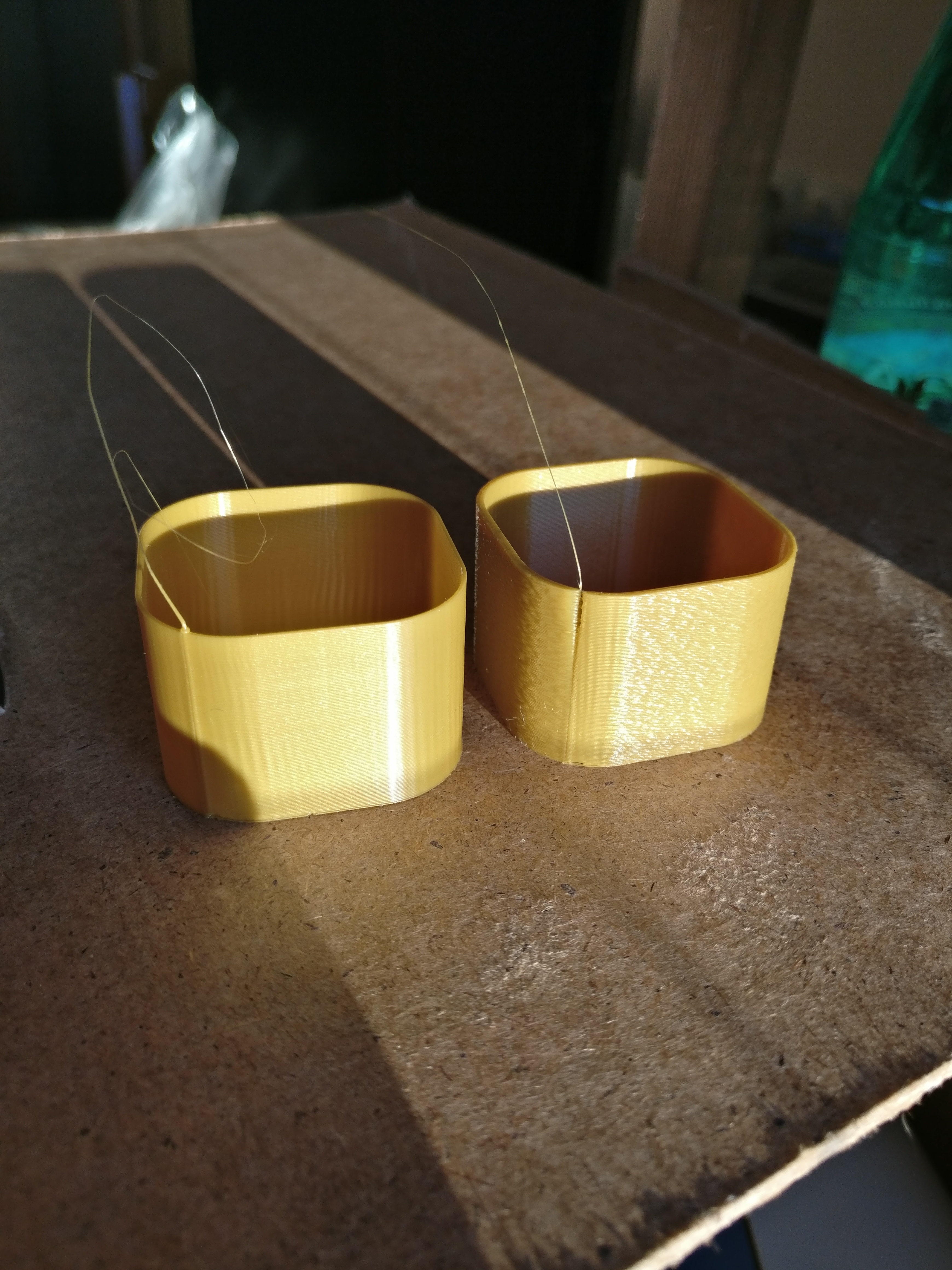

Spontaneous texture mode turn on while calibrating?

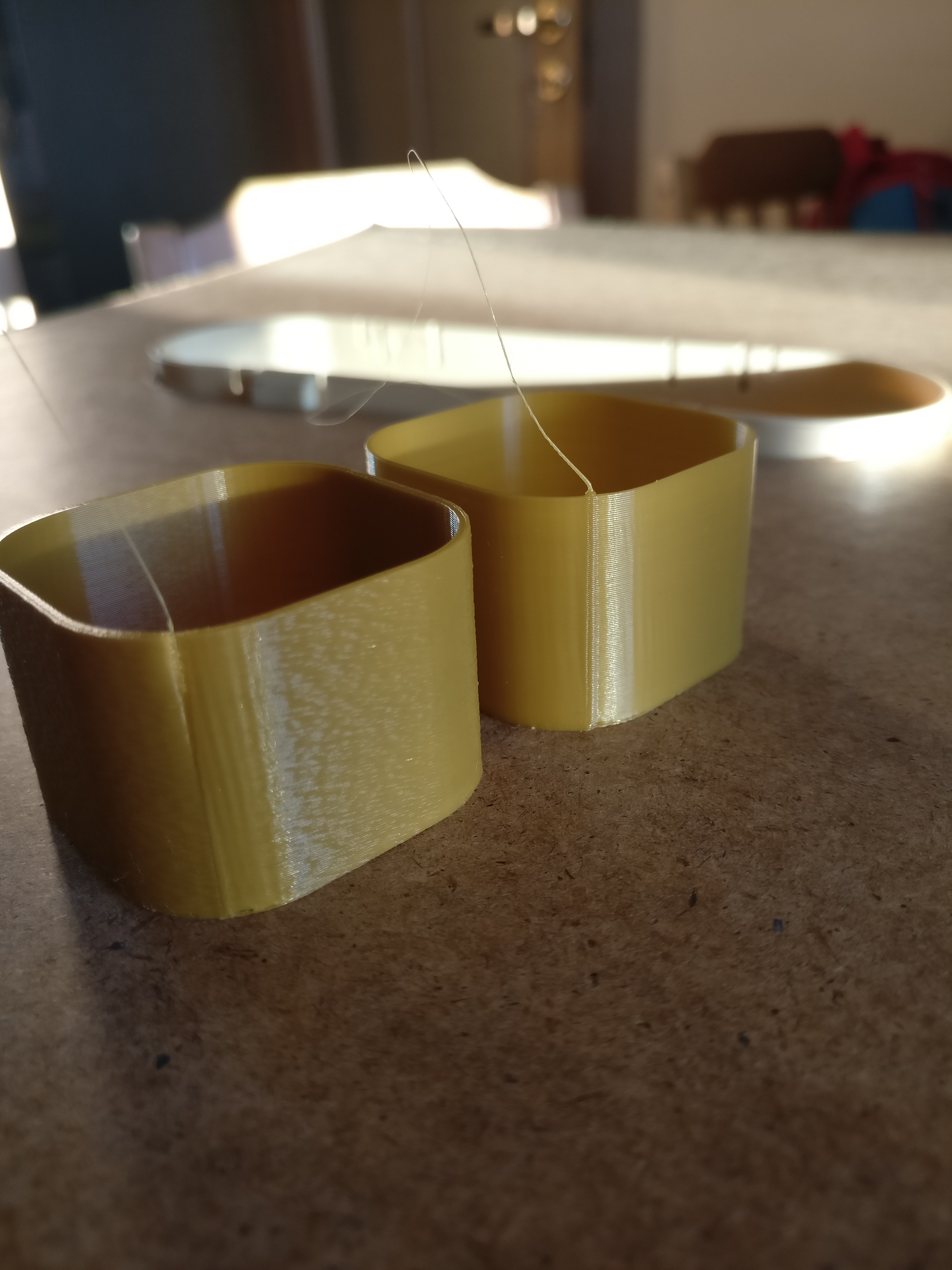

Hi, everyone.
Kiss 2.0 on linux 64bit (prusa kinematics printer) did well on flow calibration. But on pVE calibration strange things happened:
- While printing external perimeter the nozzle moved with frequent accelerations and decelerations along X and and table along Y. It produced rough outer surface.
- On the same time the inner loop was printed with even fast speed.
- After the seam on the external perimeter the nozzle fast jumped for the first about 10 mm producing even surface.
I attach pics:
cube with smooth walls is the flow calibration and with rough wall is the pVE calibration.
If needed I could upload the settings.
The tuning wizard on the seam is anyway functional and informative. The bug only prolongs the test time and wears off the mechanics.
Let me know what I did wrong if I did.
Thank you.
I attach pics:
Thank you.

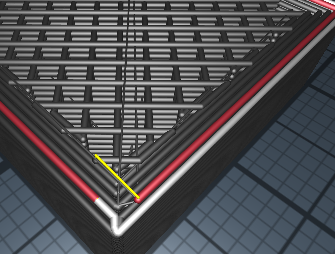

Speedsetting not honored correctly. Even on big plates where minimum layertime would not affect.
I have set
Top 30 (1800)
Perimeter 40 (2400)
Loops 80 (4800)
Solid 140 (8400)
See this example from layer number 10:
; head speed 59.999996, filament speed 1.782078, preload 0.000000
G1 X158.109 Y159.411 E0.00522 F3600
So 60mm/s speed is here in gcode instead of ecxpected 80mm/s?
full gcode attached.
derdigge
I have set
Top 30 (1800)
Perimeter 40 (2400)
Loops 80 (4800)
Solid 140 (8400)
; head speed 140.000000, filament speed 0.000000, preload 0.000000
; Prepare for End-Of-Layer
; time estimate: pre = 8.467651, post = 7.101339
; Dwell time remaining = -2.101340
; Post-layer lift
G1 X158.158 Y156.88 Z2.05 E0 F1500
; END_LAYER_OBJECT z=1.800
; BEGIN_LAYER_OBJECT z=2.000 z_thickness=0.200
; Blending Fan to Cool (71.5% blend)
; Blended Fan at 77%
; fan %*255
M106 S196
; 'Loop Path', 1.8 [feed mm/s], 60.0 [head mm/s]
G1 X158.284 Y159.411 Z2.05 E0 F12000
G1 X158.284 Y159.411 Z2 E0 F1500
; 'Destring Prime'
G1 E6 F3600
G1 X157.581 Y159.411 E0.01567
G1 X156.702 Y159.411 E0.02612
derdigge
- Calibration_Cube.zip
- (176.09 KiB) Downloaded 492 times
That's the outermost loop in red in this image:derdigge wrote:Speedsetting not honored correctly...
This loop then continues to form the perimeter (silver path) which is printed at 40mm/s. Then all the remaining loops are printed at 80mm/s.
To me, this does seem to be a very sensible approach in an attempt to preserve some precision. I wonder whether the same would happen if you turn off "Join-Loop"?
