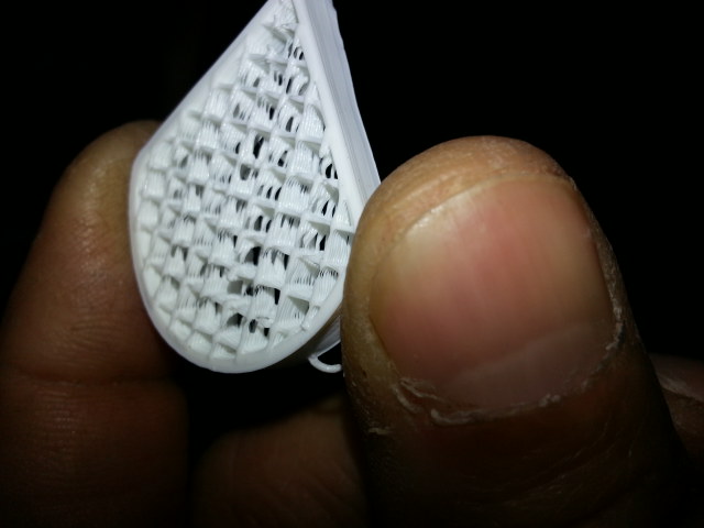

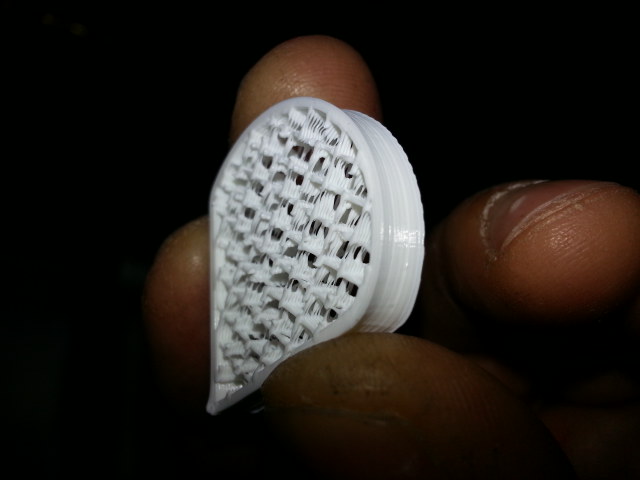

Re: Found a way to get CubeitMod to work with newest Kisslic
Test with 5B2 and latest safe version, both prints are similar, Infill set at 25%. should the infill be more solid?
- finetune 2.jpg (39.11 KiB) Viewed 5210 times
- finetune 1.jpg (45.91 KiB) Viewed 5210 times

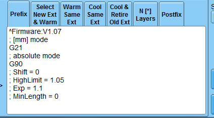

Hello all,
I have another new Version to try/test.
This one gives you full control over the Solid and Infill Calculations and if neccessary can disable all corrections other than the extrusion speed conversion. I prepared a Excel-Sheet to display how the changes affect the Solid and Infill Calculations. In order to have control over the Calculations, some new lines have to be added to the Prefix Tab under Kisslicers Printer G-code Tab:
It is important to fill them exactly as shown, otherwise they don't get read correctly. You can change the numbers of course, but don't change the names or the position of the number (e.g. remove Spaces). The numbers shown below reflect the original settings used in CubeitMod Versions up to now. Before changing any number, please check the influence with the Excel-Sheet I've prepared.
The values will show up in the Done-Message, I strongly recommend to compare them each time you did change them.
; Shift = 0
; HighLimit = 1.05
; Exp = 1.1
; MinLength = 0
If you need to disable Infill and Solid corrections you simply have to enter a value below 5 into the new "Max Speed" field. Results then should be the same as with the SafeMode-Version. The included .po file updates the description of the "Max Speed" field accordingly.
Please test and comment if you want.

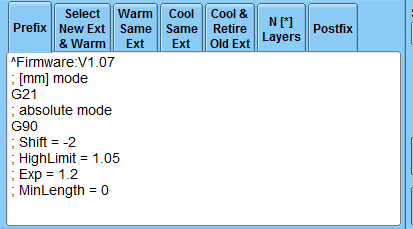

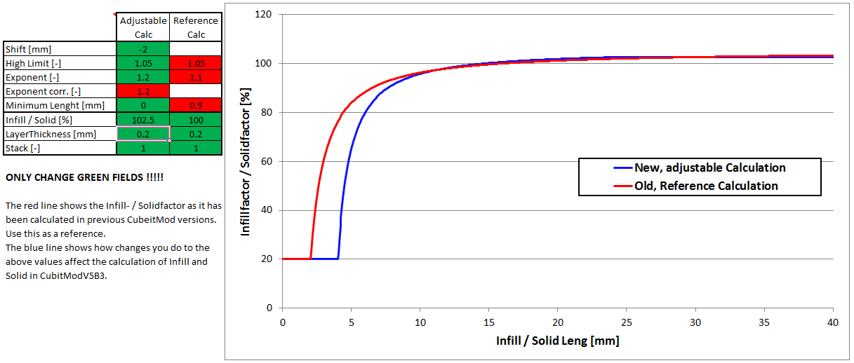

Short example:
Lets assume your solid surface with the old CubeitMod looks very good for pathlengths higher than 10mm but you have too much solid for shorter lengths. Your settings are: 0.2 Layer Thickness, no Stacking, Solid% set to 100%
Take these values and enter them into the Excel Sheet for the "Reference Calculation". Then start to change the values of the "Adjustable Calculation" in a way that the Solidfactor decreases for Lengths below 10mm but stays almost the same for Lengths above 10mm. Trial and error is the way to go here......
I found the following values to look very good for this example:
Shift: -2, High Limit: 1.05, Exponent: 1.2, Minimum Length: 0, Infill/Solid%: 102.5
This is how it looks like in the Excel-Sheet: Now you have to enter these values to the Prefix Tab of Kisslicer:
; Shift = -2
; HighLimit = 1.05
; Exp = 1.2
; MinLength = 0 And don't forget to change the Solid% in the Matl Tab to 102.5
