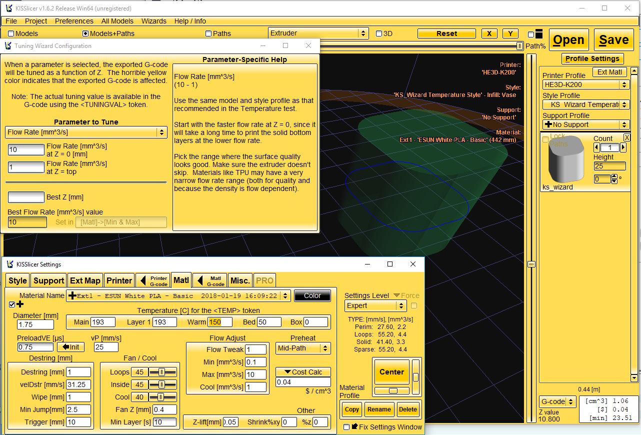

I have a HE3D K200 delta printer. I am running he wizzards to calibrate it. I have corrected my extruder E-steps, leveled my bed and also calibrated the extruder temperature for my PLA that I am using.
I tried the Flow calibration and that is where I run in problems. When I print the Flow test using 10 mm^3/s to 1 mm^3/s I get a similar result to what user nuggetz showed in this thread ( viewtopic.php?f=23&t=2066&start=0#p5917 ).
It has an awful gap thru most of it. When I look at the resulting slice in KS, This is what I see:
Looks OK. But when loaded inte repetier host, it looks like this:
The open areas match the problems areas in the print.
So, can anyone explain why the gcode produces the area that is missing and also why the result in KS does not show it.

I've never tried looking at tuning wizard g-code in another viewer but I just replicated your model and slice and opened in Repetier and I do not see this large gap at all. I'll do a little more experimentation. However, what you show does approximate what KISS should be doing with tuning your flow rate from 10mm^3/s down to 1mm^3/s and printing this g-code and measuring where the height to where the seam line is "good" and entering that in the wizard Best Z will give you a good, calibrated flow rate.
